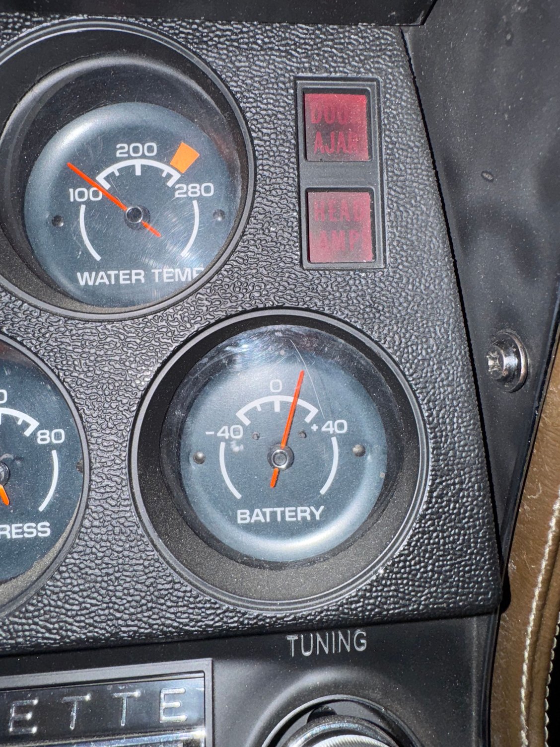

  5. I go for another drive. The battery gauge is in the positive after revving up the engine, goes all the way to +40, then nothing. It hasn’t been in the positive since this.
  6. Putting a meter on the battery now shows 12.5 on or off, which I would imagine would go down over time using electronics on the car

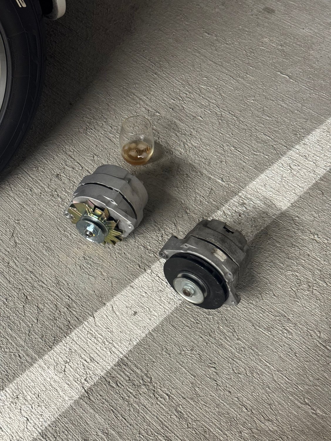

I brought the new alternator to the store today.
They didn’t have a V-belt for their alternator tester, so I wasn’t able to find out if it was bad. However, they gave me a new one under warranty anyways.
So the new new alternator goes in. Still nothing. I’m getting 11.8 volts at the battery regardless if the car is on or off, and the battery gauge isn’t going into the positive. However, I am getting a magnetic feel at the rear of the alt when the car is on.
At this point I don’t believe it’s the alternator itself, but something else. Like I said before, all connections are clean and tight. I disassembled the two prong connector to be sure. Any recommendations as to what it could be?

My car is a ‘76. With an ammeter and no alternator or battery light. I’ll double check all my connections tonight.

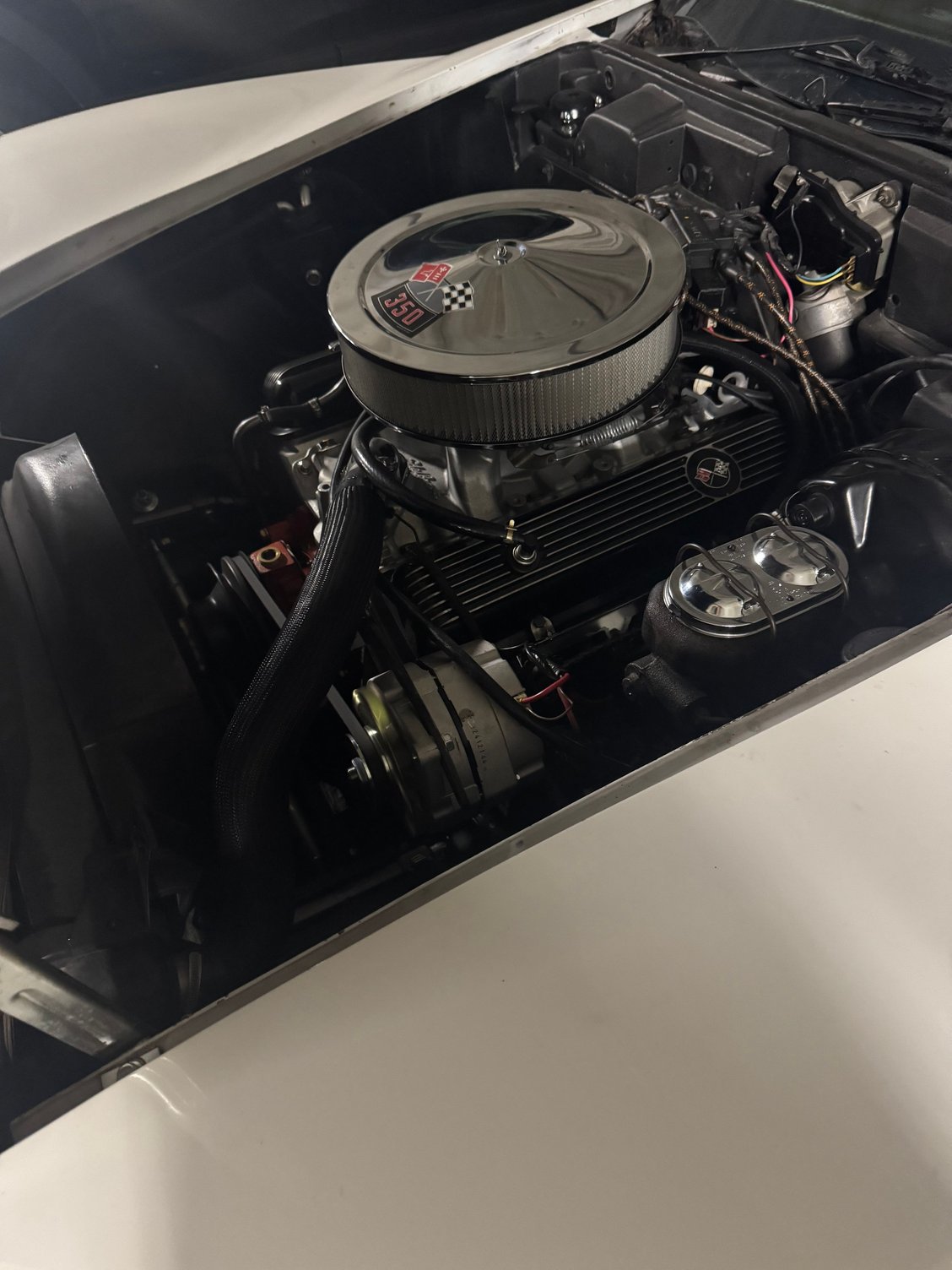

Well I took the one from the maroon car. Has a different style fan and the clocking is wrong, but none of that affects functionality.
And… it works!
A bit annoying that I had two bad apples from the get go, but I’ll see if I can get a refund for it. For a more permanent solution I’ll be searching the junkyards and rebuilding a unit myself. The car has LED bulbs throughout, no defroster, no electric fans, and the entire HVAC system has been deleted. If anything my car draws less amps than a stock one would, so an 63 amp unit should be fine until my LS plans in the future. Any specific models from a vehicle I should look for? And who has the best rebuild kits?

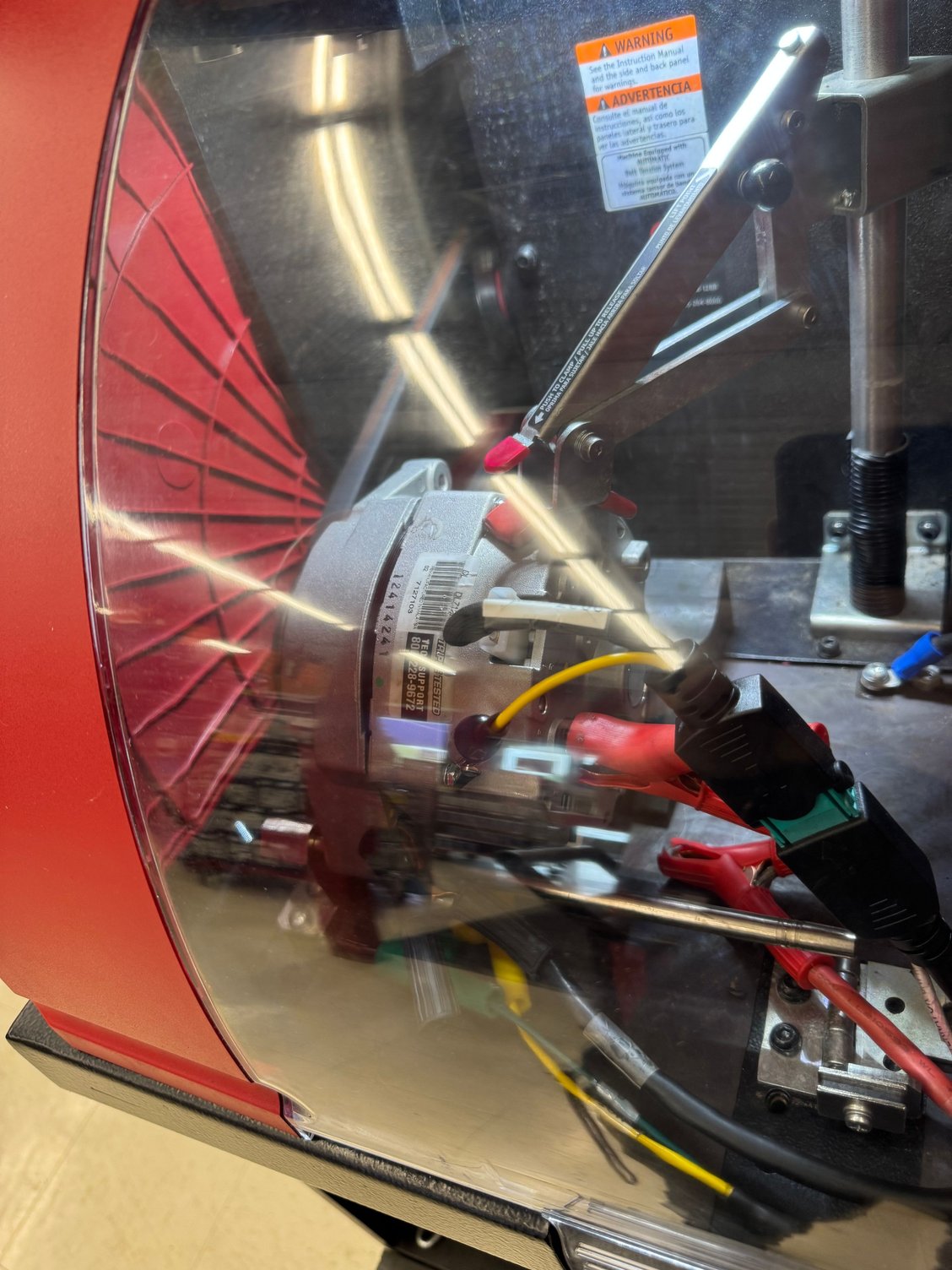

Tried it in the autozone alternator tester. Failed obviously, but they gave me a full refund as well as the price of the core I brought them. Can’t complain about that.
As of now the white car works, and the maroon one can be put on the back burner for a bit. I’m glad I was able to figure this out without having to tear deeper into the wiring. Thanks for the advice everyone.
