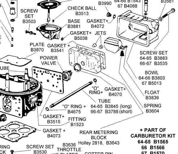

O-Ring failure? Just leaking o-ring? Any recent work on carburetor?

I think it's the plug leaking. There are bubbles present and you can see a ring of fluid around the joint. A leaking tube o-ring wouldn't migrate upwards to this plug surface.

My phone doesn't support .mov format but if it's the plug that is leaking I found 3 solutions.
Use a wooden dowel and tap the plug that it spreads.
Use gasoline proof epoxy.
Replace the bowl.

Ok closing out thread. I lightly tapped welsh circle with a wood dowel , then put Seal All gas resistant epoxy clear on it. 2 coats and 24 hr dry period. No leaks . Thank you all
