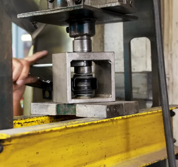

This is an interesting tool I saw on this
from Paragon as it seems to set the compression depth with the wrench looking part prior to flaring the tube. The rest of the tools I see are just two plates with bolts to pull them together. I've not looked in the service manual yet to see if there is a spec for the distance between the outer bits or not. One interesting thing is all the load is on the bottom plate when compressing the bushings.

That's what that tool is for, it compresses those bushings. As bushings are compressed, that center sleeve comes up PAST washer. Once center sleeve is beyond washer enough, then you use flaring tool to secure busing together. Flaring is MUCH easier if you have access to a hydraulic press.
So how much past washer should sleeve go?
Take a look at already flared end of sleeve. Place flared end on one of your washers and take a look.
Try to get end you secured to look something like that flared end/washer looks out of the box.
If you do it right, then alignment shim count will be similar.
Mapman
And that's where you run into problems with cheap compression tools. Compressing those bushings will bend 1/2" steel (cheaap steel).
