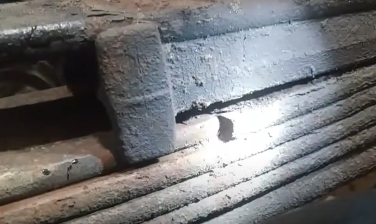

My 73 has a composite leaf spring. Question is to level the car I have to run the driver side busing all the way tight and put the passenger at the lowest level. Frame measures correct from the ground at 4 points. Anyone know why?

I'm not sure what you mean by "composite leaf spring", what you have looks like a stock multi leaf steel spring. Composite rear springs are fiberglass or similar material single leaf springs. That said, from looking at your pictures it appears to me that you might need a new rear spring. It looks like the spring's main leaf has lost it's arch, especially on the right side, though it does look like the spring was previously replaced. While the cut of the ends of the main leaf and the up turned ends of the other leaves are typical of factory springs, stock springs did not use with spring clamps.
Besides the front springs, I would check the rear spring's center mount for a broken or or missing bolt holding the "dog bone" anchor plate.

First of all, you don't have a composite spring. That is a stock steel leaf spring.
Are the bolts the same length? If so, most likely the spring has lost its tension for some reason and will need to be replaced. To confirm I would support the front of the frame to take the front springs out of the equation. If the problem still exists, it has to be the spring. If you are going to replace it, I highly recommend going to the composite spring if there is a good one available these days.

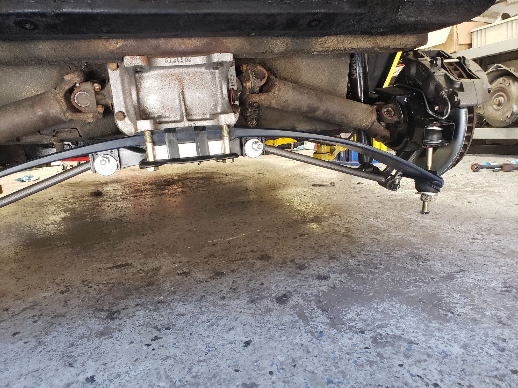

FWIW, this is a composite spring...

That looks like a 2" difference in spring height from left to right in the rear.
That is a big difference.
A car that does not sit level should always be checked out.
A stock spring has a 98# per inch rate, per wheel.
I doubt your 850# left corner suddenly gained 200#. Or that your frame is bent that much, or that a front spring mis-indexed by 1/2" would cause that.
I would suspect one cracked leaf in the rear spring, lowering it's stiffness rate. on one side only.
On the driver's side, left of center.
There are nine leaves in there, one cracked one would lower the spring rate a lot, and cause that.
A change from a 98# to 78# spring rate would need to be cranked up ~2 more inches to hold the weight and keep the car level.
And sooner or later another leaf will crack .....

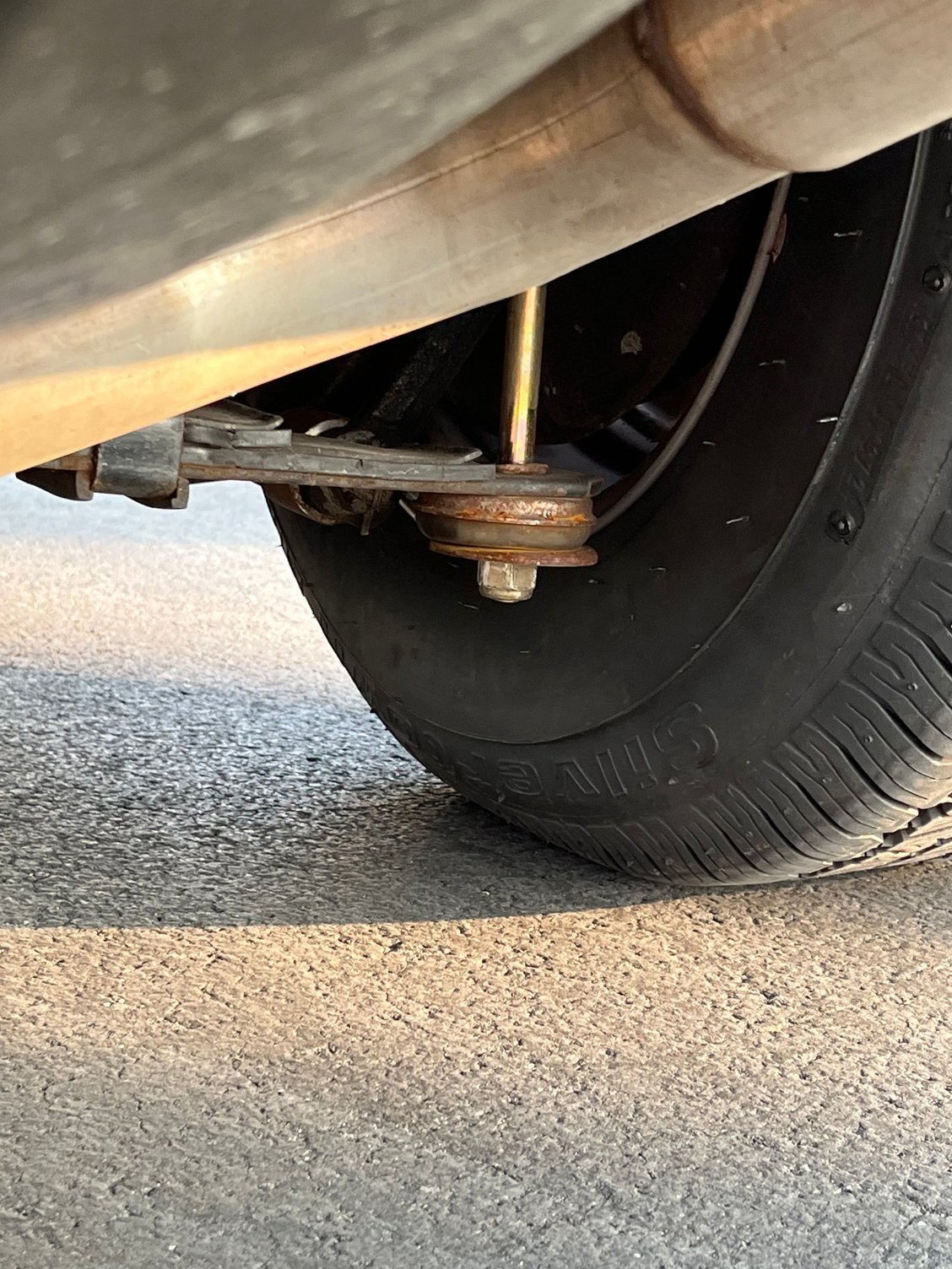

Back up and take some more pictures of the entire rear suspension.
There could be several items causing your issues.
One that I see is that the shipping straps were never removed from the spring.
You also answered a possible problem already when you stated the spring was a less expensive one.

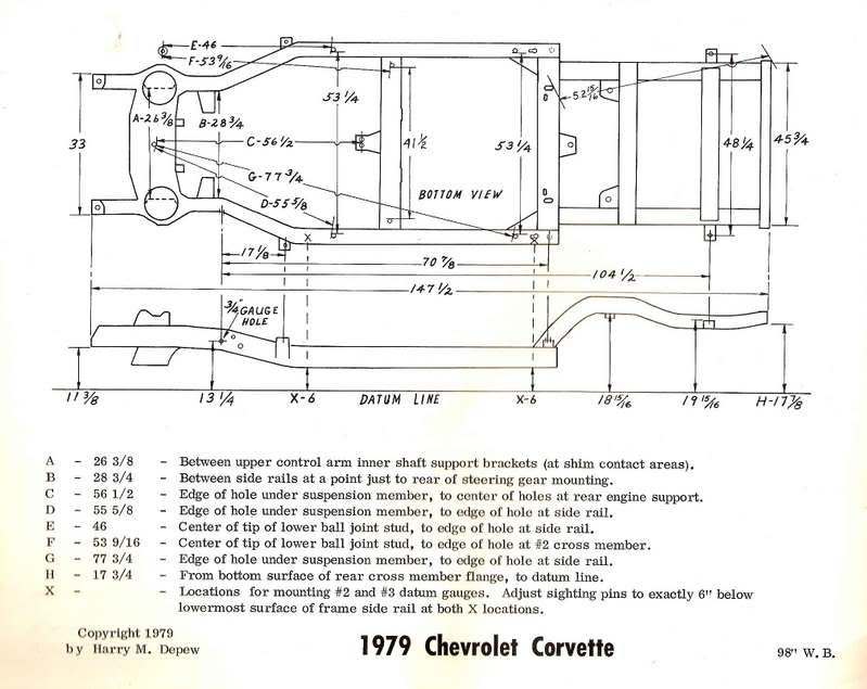

I thought I read that you had measured the frame and thought it was straight.
But it is easy enough to check that at home, without dissasembling anything.
You just need a tape measure. And a concrete floor.
You are just looking for numbers that vary more than 1/4 inch.
X type measurements are the most accurate. Even 1/2" on those should be OK.
When measuring to the floor, you need to account for the floor, which will also likely droop by 1/2" somewhere. Like toward the door.
I use a 5 foot 1" Aluminum I-Beam, from Home Depot, and a few 1/8" linoleum floor tiles, to make level spots on the floor. For good measurements.
Don't forget, a 1/4" +/- is a close as these frames were when they were new.
There are a lot of numbers in that chart. I would probably just pick 4 vertical from front to back. each side, and then 2 x- measurements. And call it good. Also measure grease cap to axle center wheelbase on both sides and make sure they match. My wheelbase was off 1/2" and the left front 1" high, due to impact with a ditch. Sat real crooked like yours. And bent front lower a-arm brackets.
