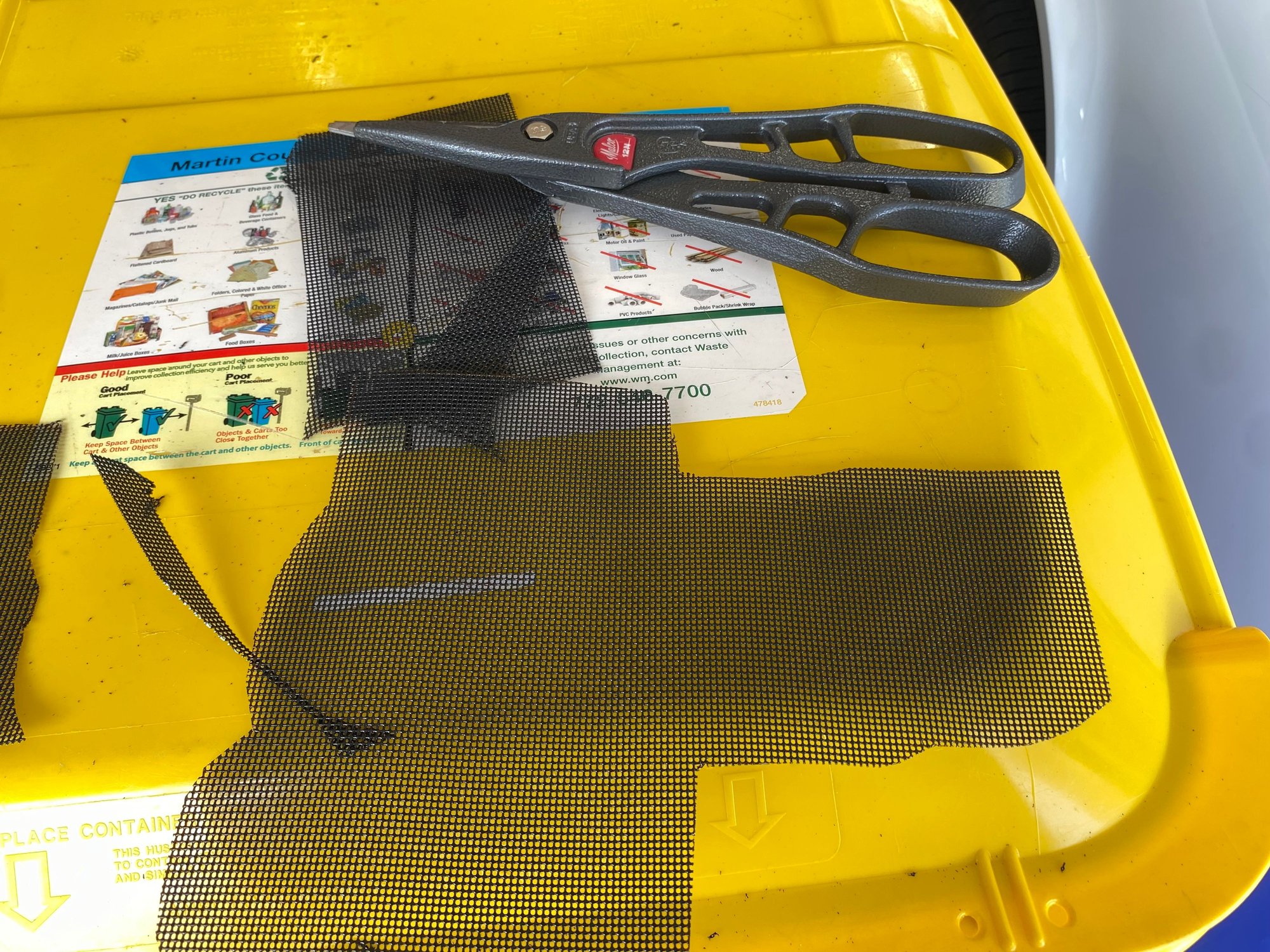

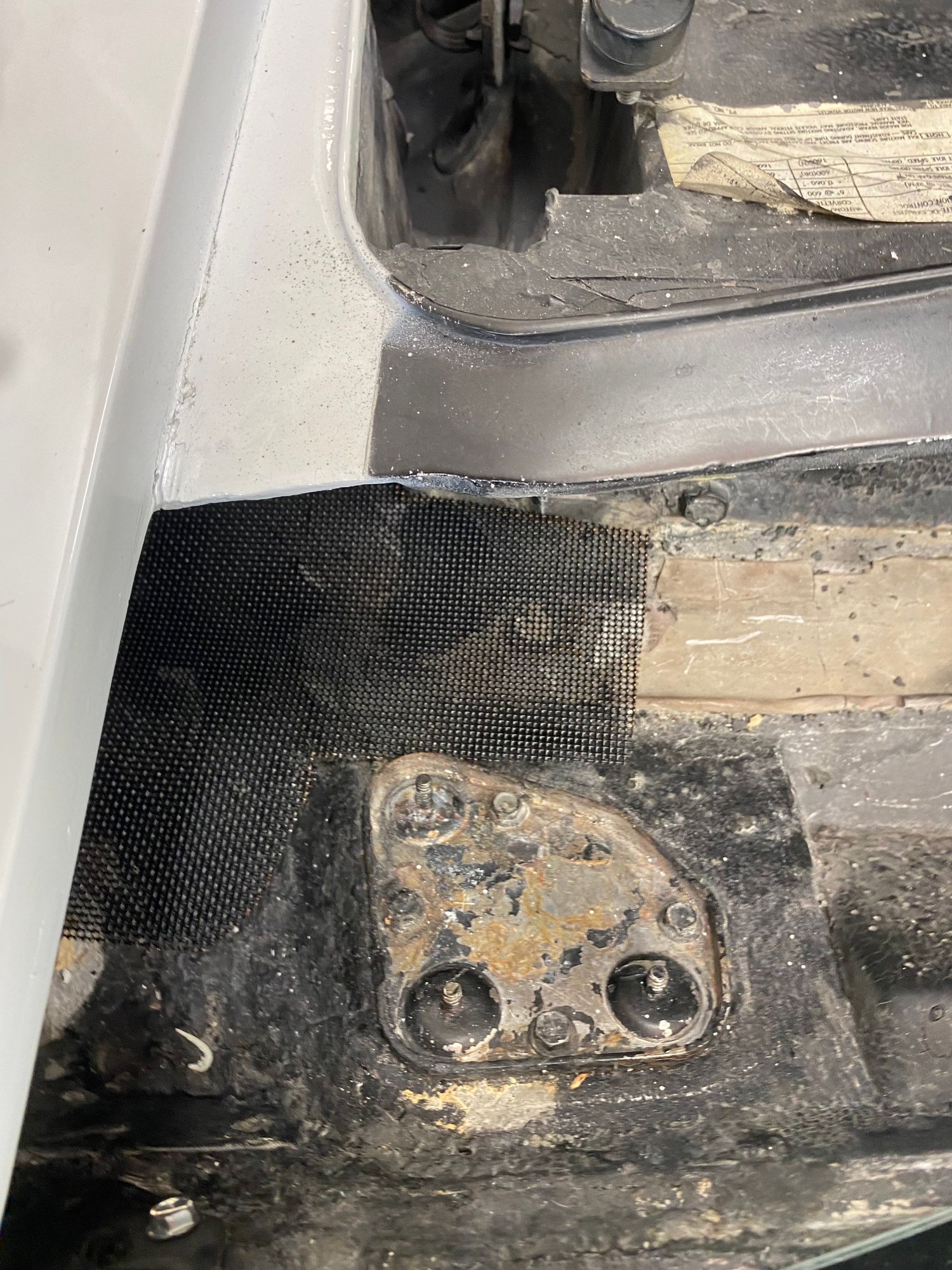

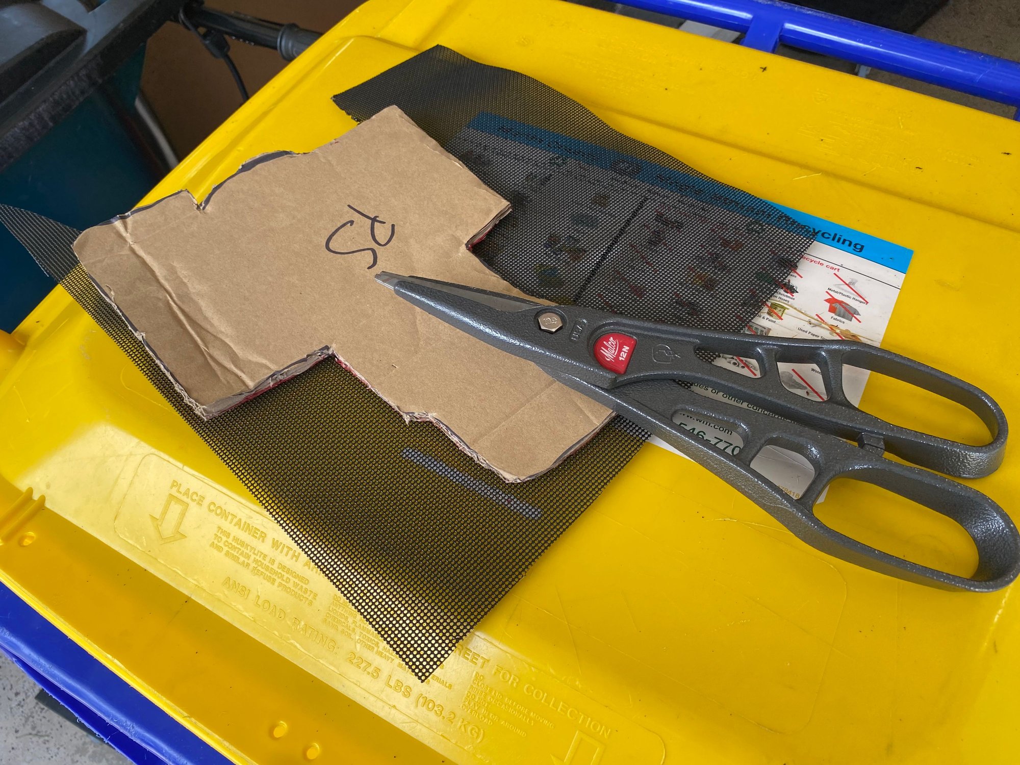

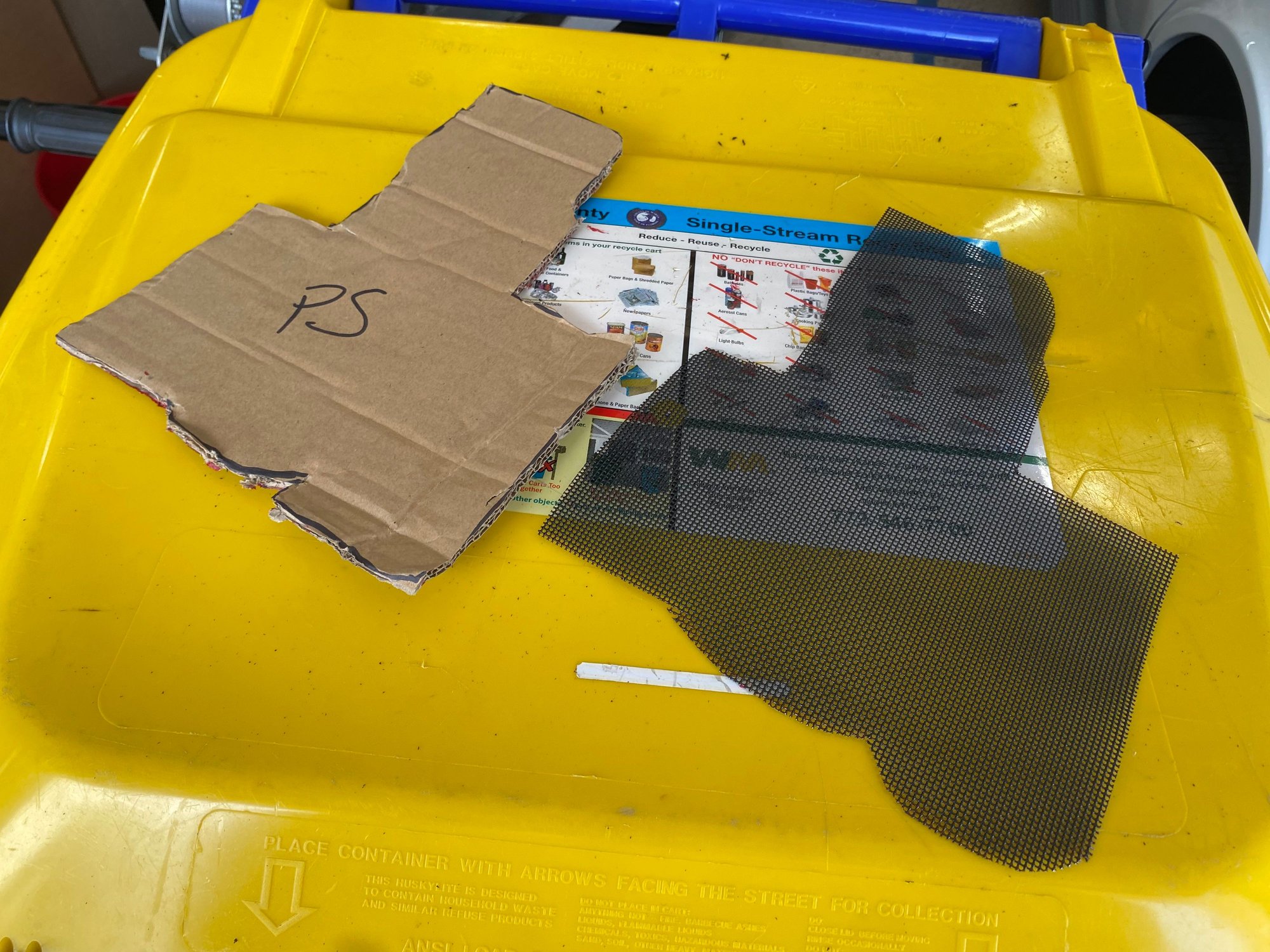

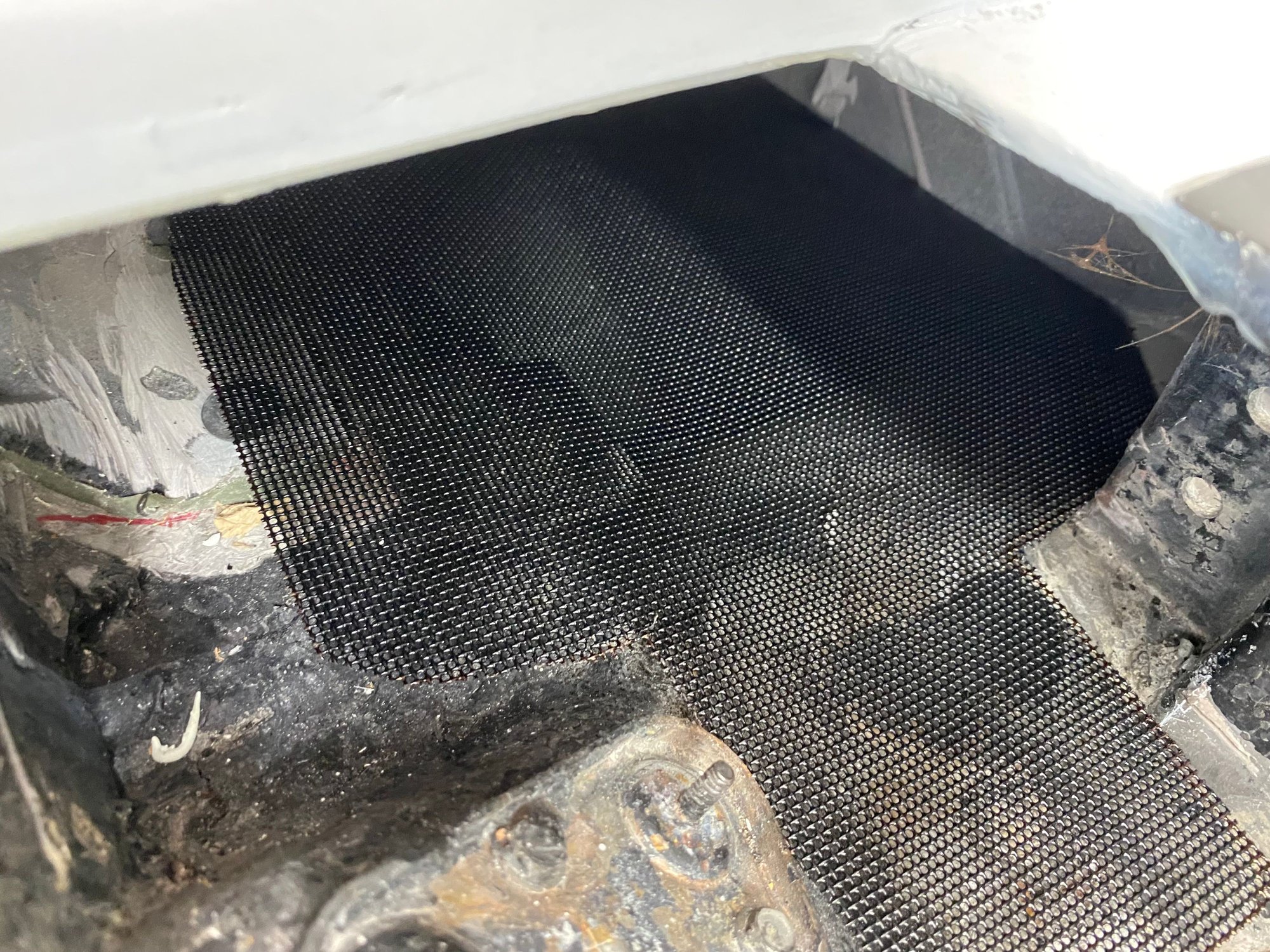

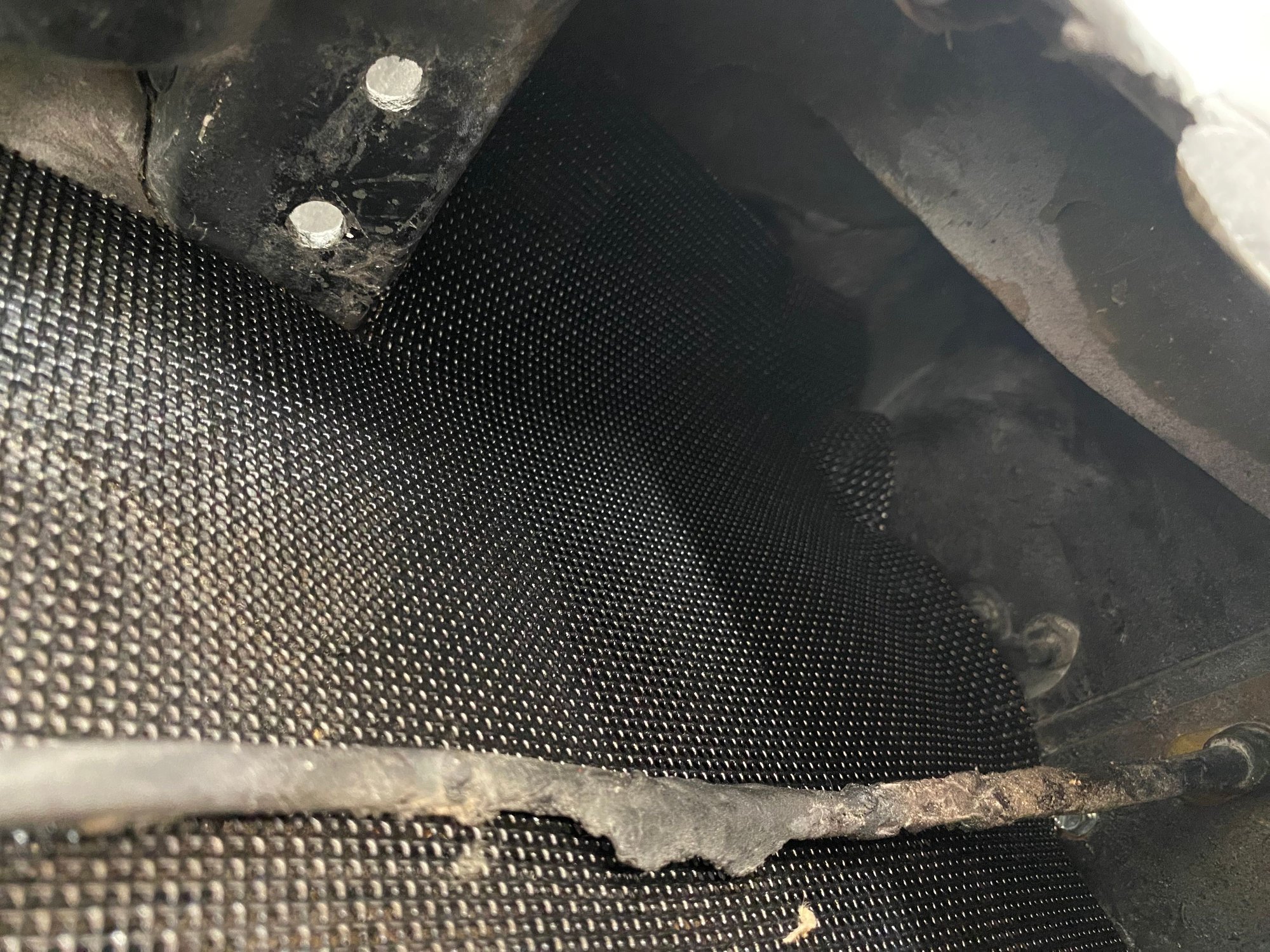

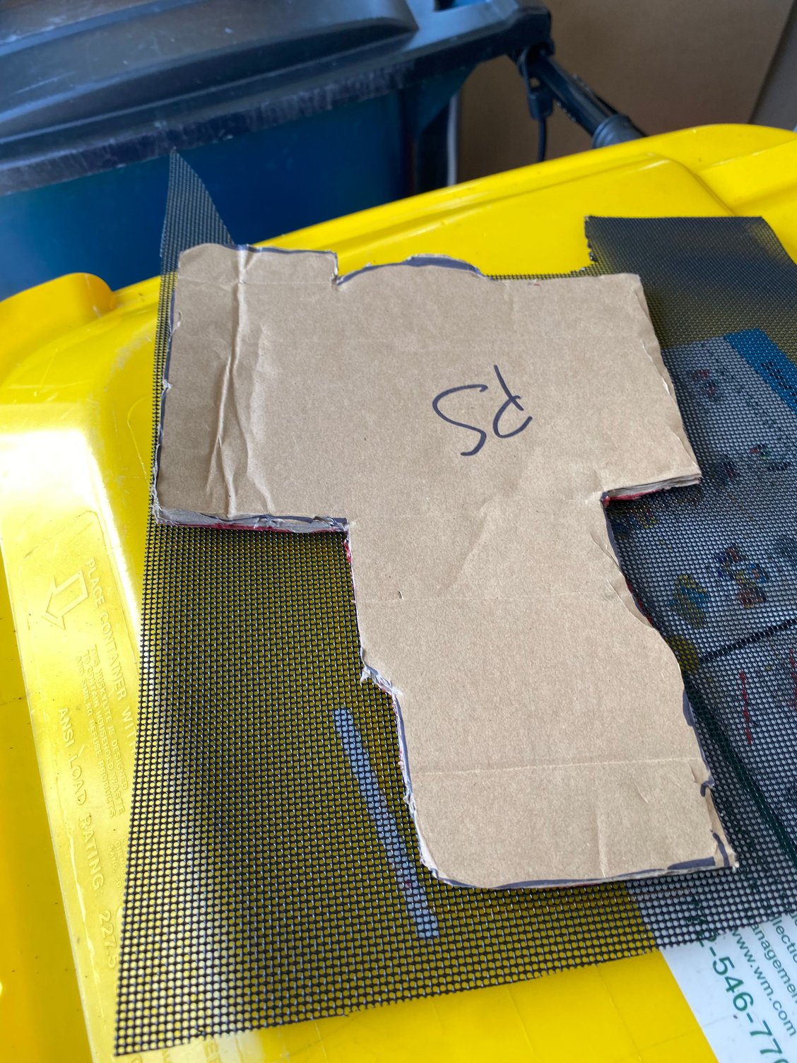

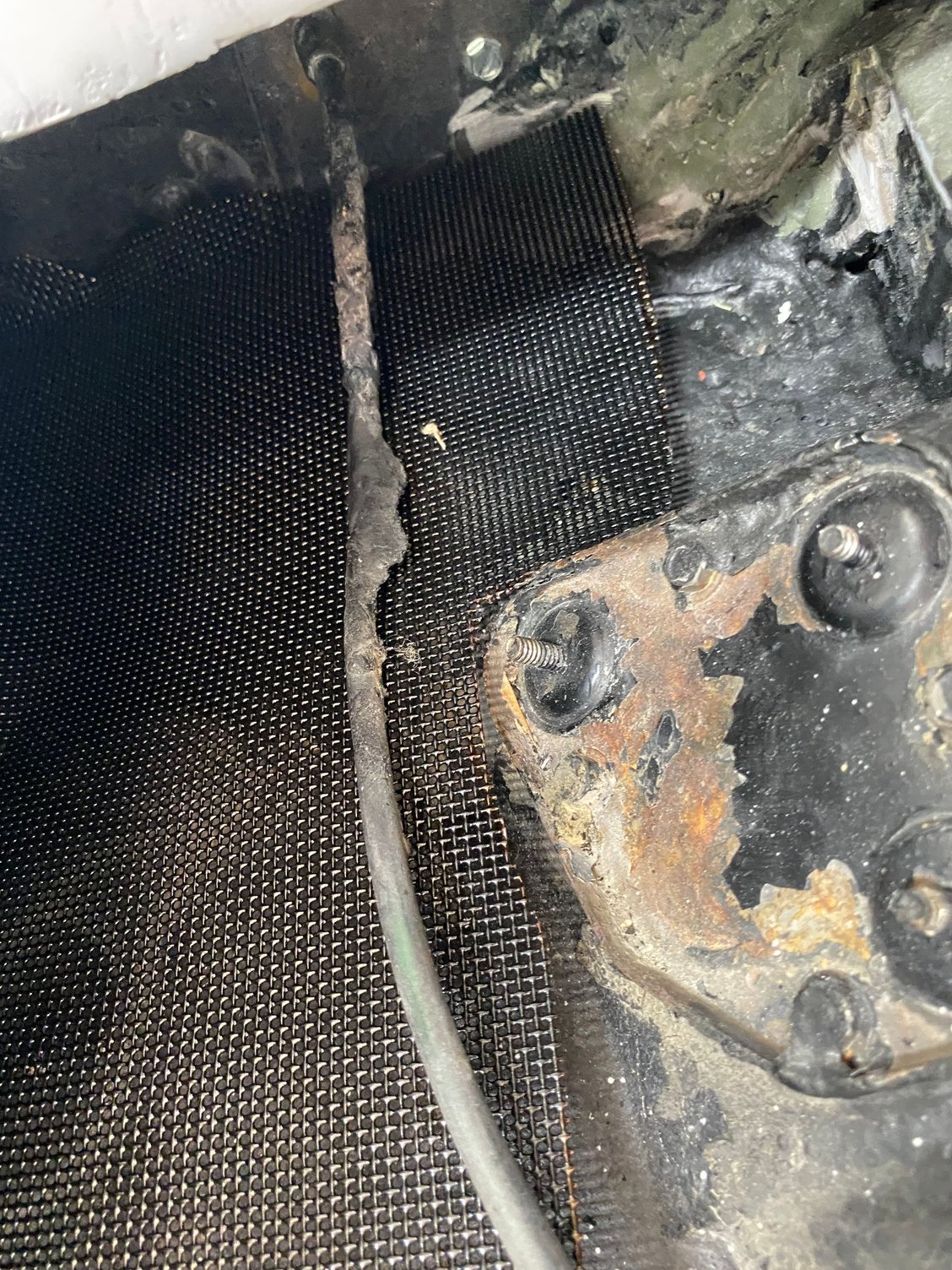

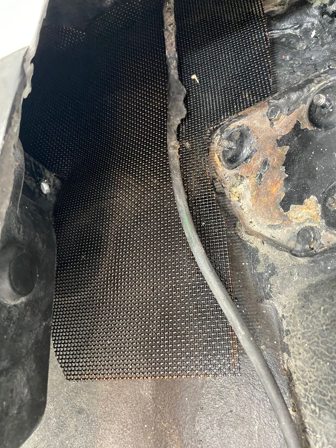

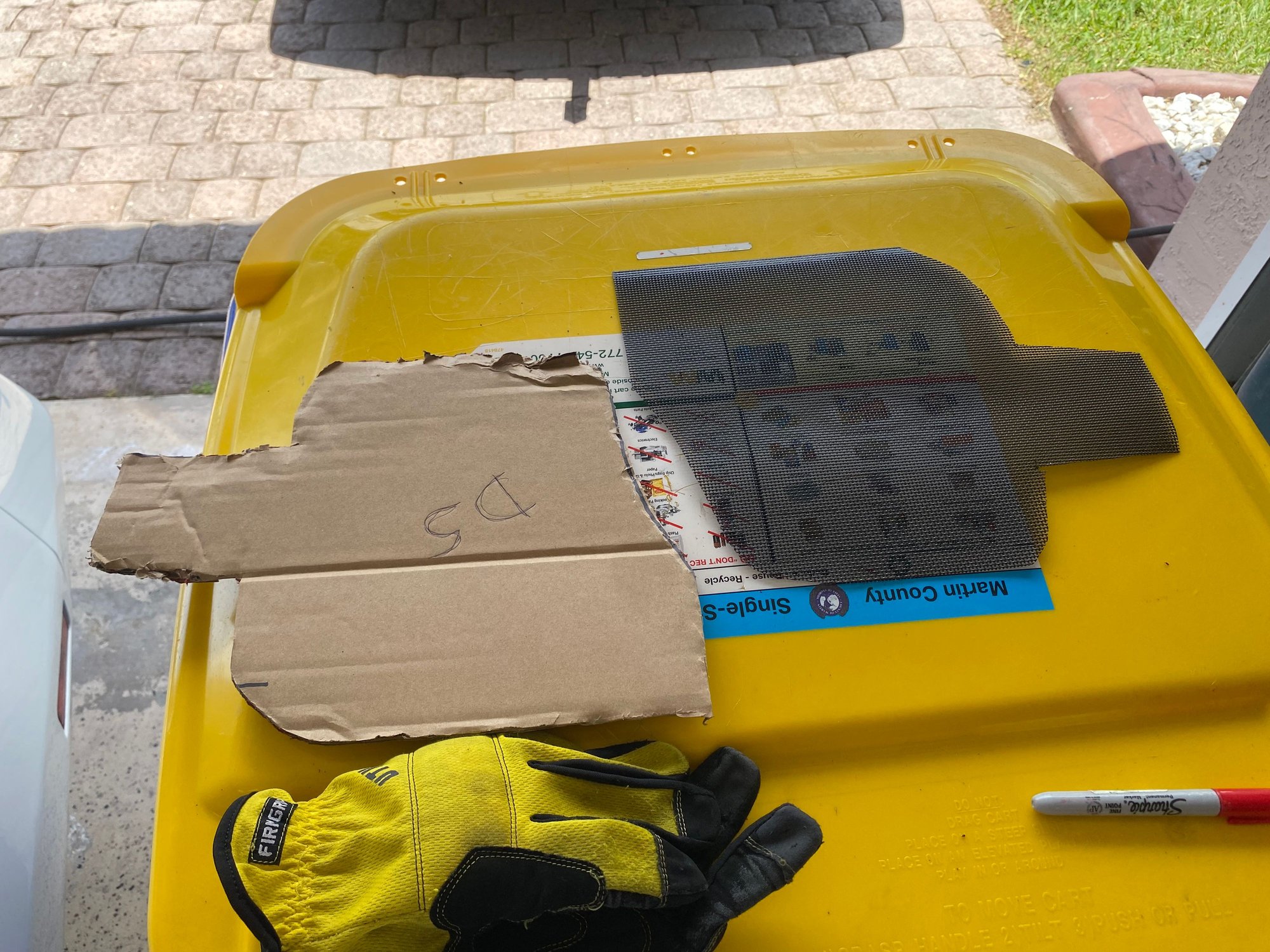

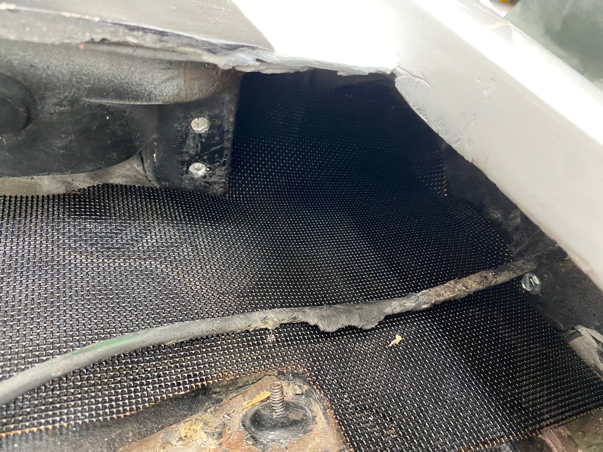

I decided to fabricate a pair of “Flat Screens” to fit into the corners of the wiper Bay Area to help prevent debris from clogging up this areas. First I made card board templates, then purchased some coated metal, cut them to match the templates, and they fit perfectly. I’ll still use the original metal screens to hold down these new flat screens. I will finish sealing the wiper bay and then re-insert the new screens and the old ones to hold these down, I may use some sealant to brace them as well. This is on my 75 C3 Coupe.
