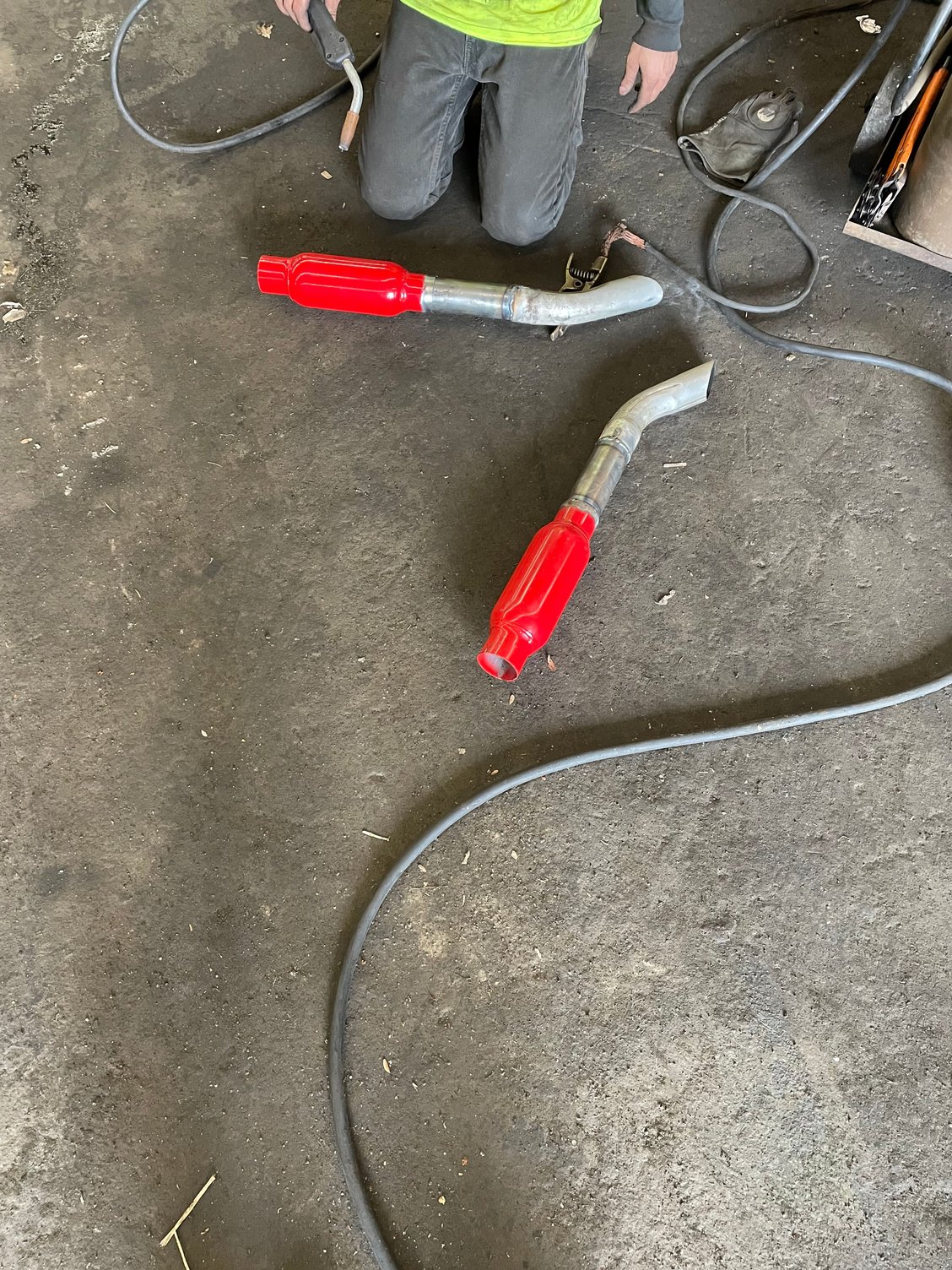

2.5 inch welded exhaust with 10 inch long Cherry Bombs - Serious, Doesn't get any better
