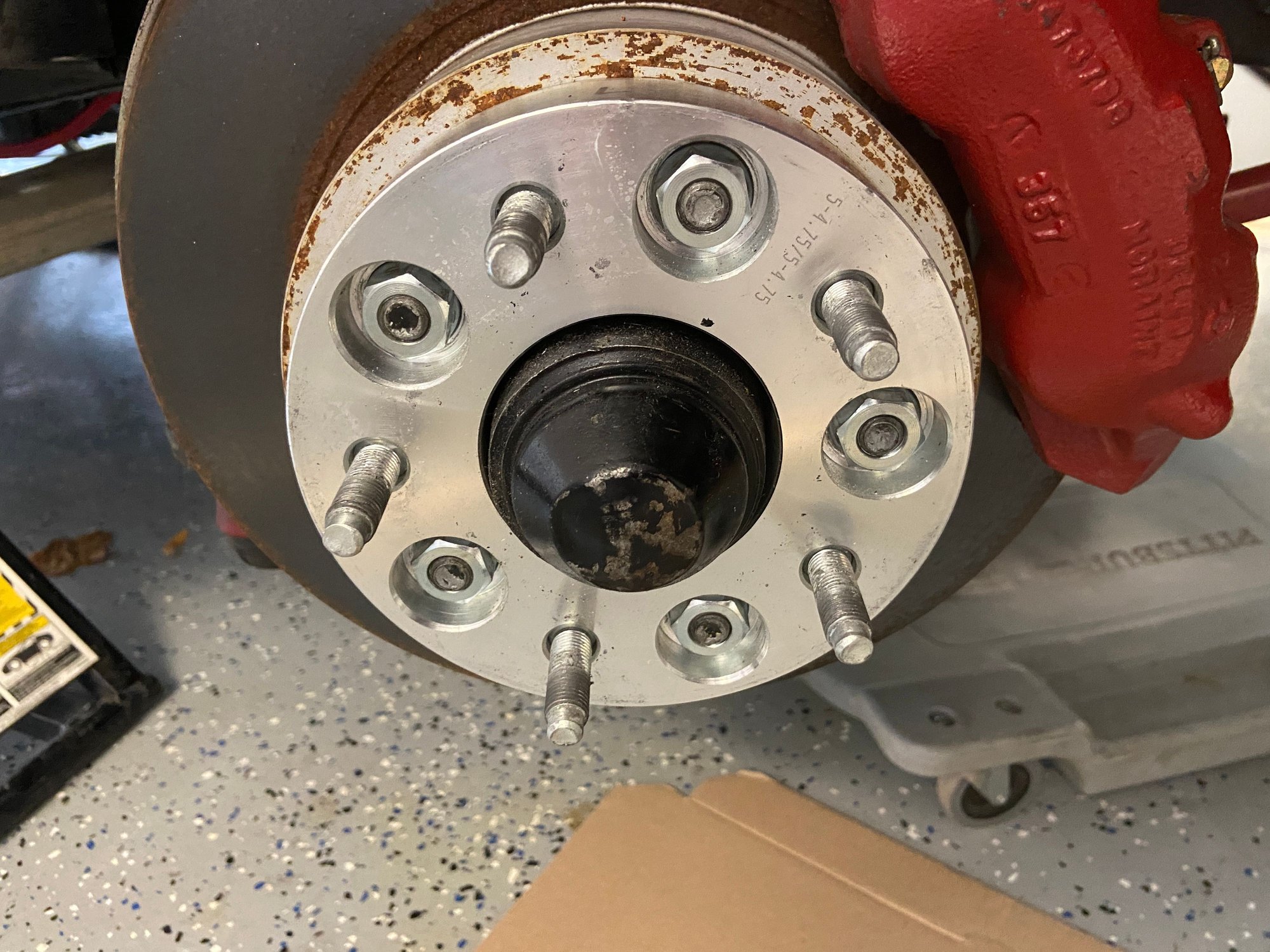

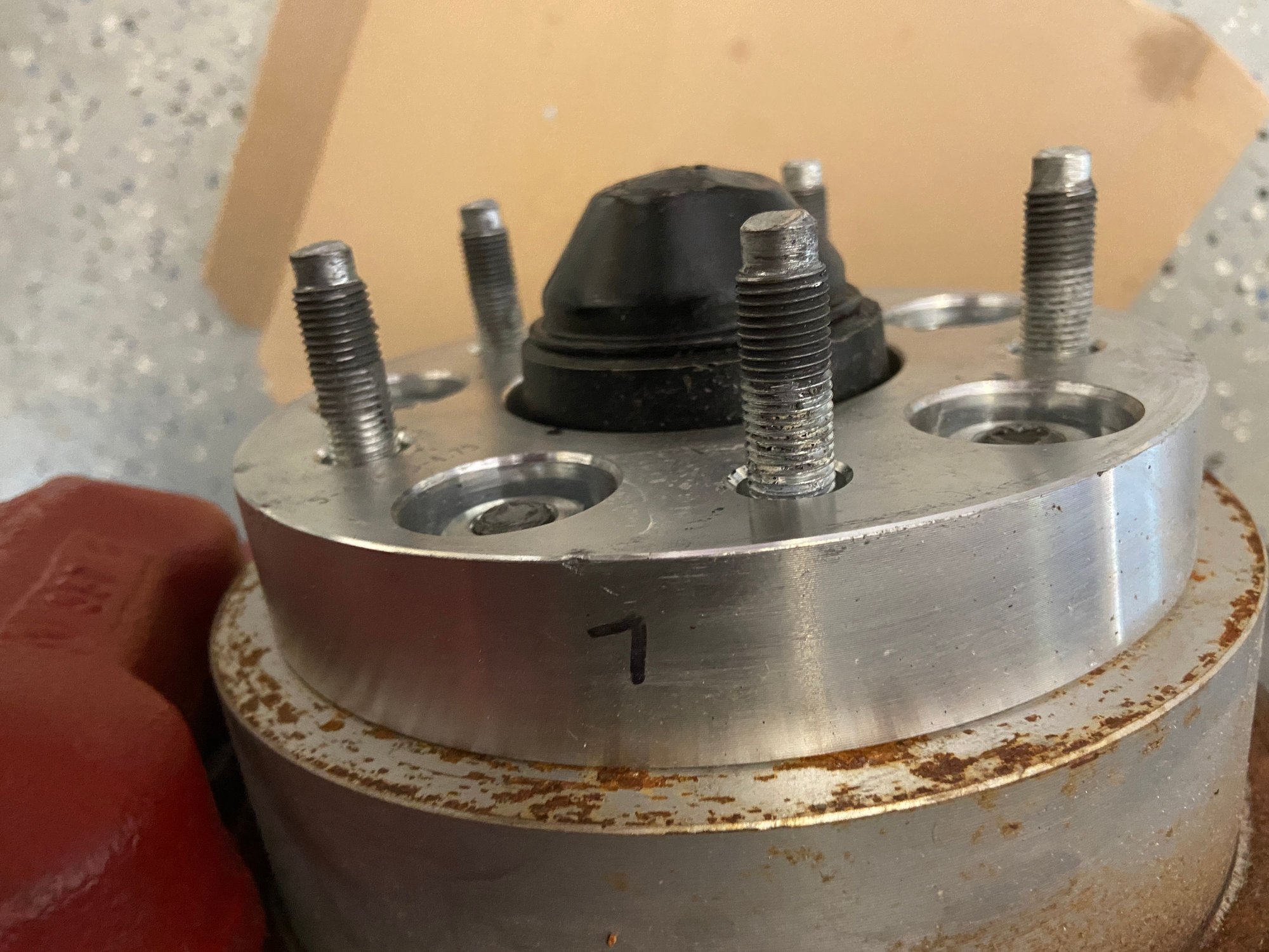

Spacers vs adapters. Spacers are just a large washer, drilled out for the 5 lugs that fits over the stock bolts. Your issue may be that the bolts are not long enough and you don't have enough thread leftover to run the nuts up tight. You run out of threads before the nut is on far enough and that is a major safety concern. Adapters are different. The adapter goes over the lugs, as if it were just the center part of a wheel. And it tightens accordingly. But built into the adapter, in between the holes for the lug bolts,is another set of lug bolts. They are what attaches to your wheel. SO there are no issues with the stock bolts being too short, and the lug bolts on the adapter are long enough to get the lug nuts tight. Some will argue that it puts too much stress on the hub etc, but that has been an argument for a long time. I have adapters on my 78 and have never had an issue.
Adapter
Adapter

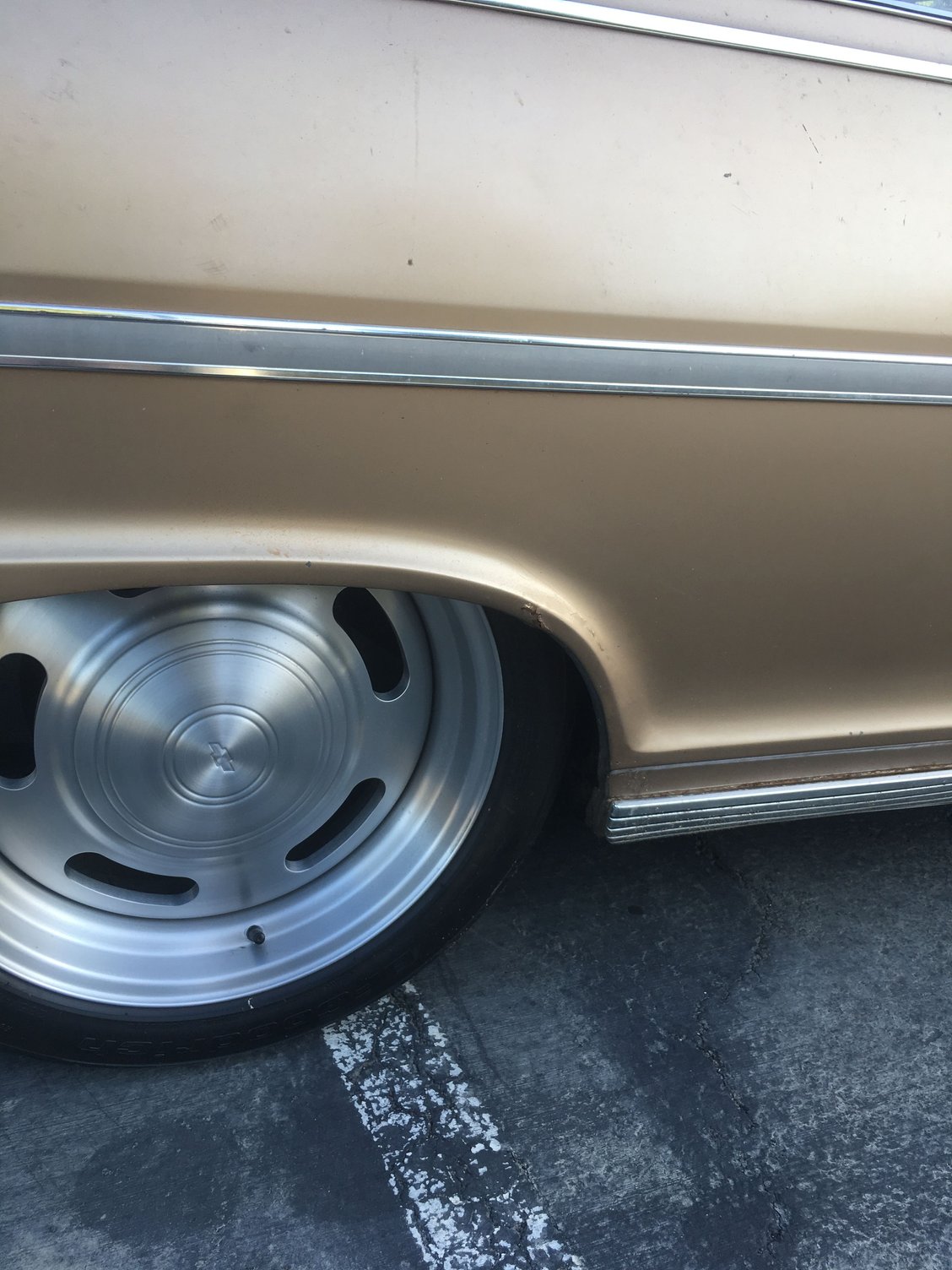

https://www.summitracing.com/parts/U...06145#overview I have these on my 77 with stock t-arms...
View this post on Instagram

Those are the exact ones I’m looking at, except in matte black. You have 18x8 all around? Mind if I ask what tire sizes you went with and if you’re at stock ride height or lowered?
18x8 and I lowered the front about 1"
I think they are 45 series tires.... i can check this week

I run adapters. After snapping some wheel studs, I'd avoid spacers, unless they are 1/2" or less.

I've been using 1/2" spacers for about 10 years. Replaced stock studs with longer ARP studs, tensile strength of 200,000 psi. No issues.

All that aside, OP there is nothing wrong with running a bolt on spacer as long as it is hubcentric and of reasonable quality.
Some people are terrified of them but most of those don't know why other than they heard they are deadly on the internet.

I put 17x8 Ansen Sprints on my 79 and they just barely rubbed the calipers. 1/8" billet aluminum spacers was all it took to fix it. I check my wheel torque every year but I can't imagine only 1/8" would make a difference.

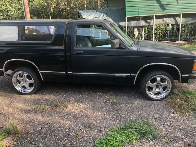

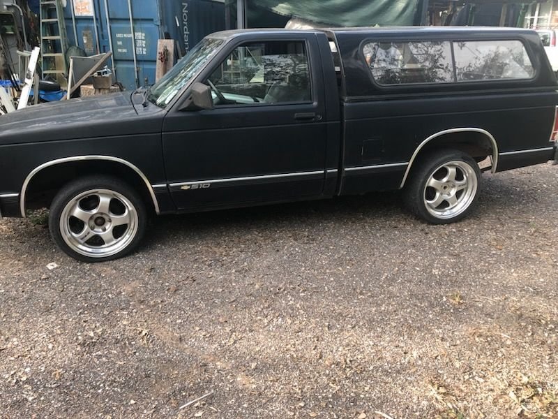

I was told wheels off a 2005 Pontiac GTO wouldn't fit a 1991 Chevy S-10
Sometimes you just have to get creative ( helps to have a decent lathe & milling machine )
made my own adaptors because I'm poor
Ended up pulling them off after a few hundred miles
Personally don't like running different size rim/tire combinations just for the fact of a flat tire happing
ended up buying some Boyd Coddington rims (run out less than .005 in both planes = in 17' x 8" = simple, can carry a spare.
