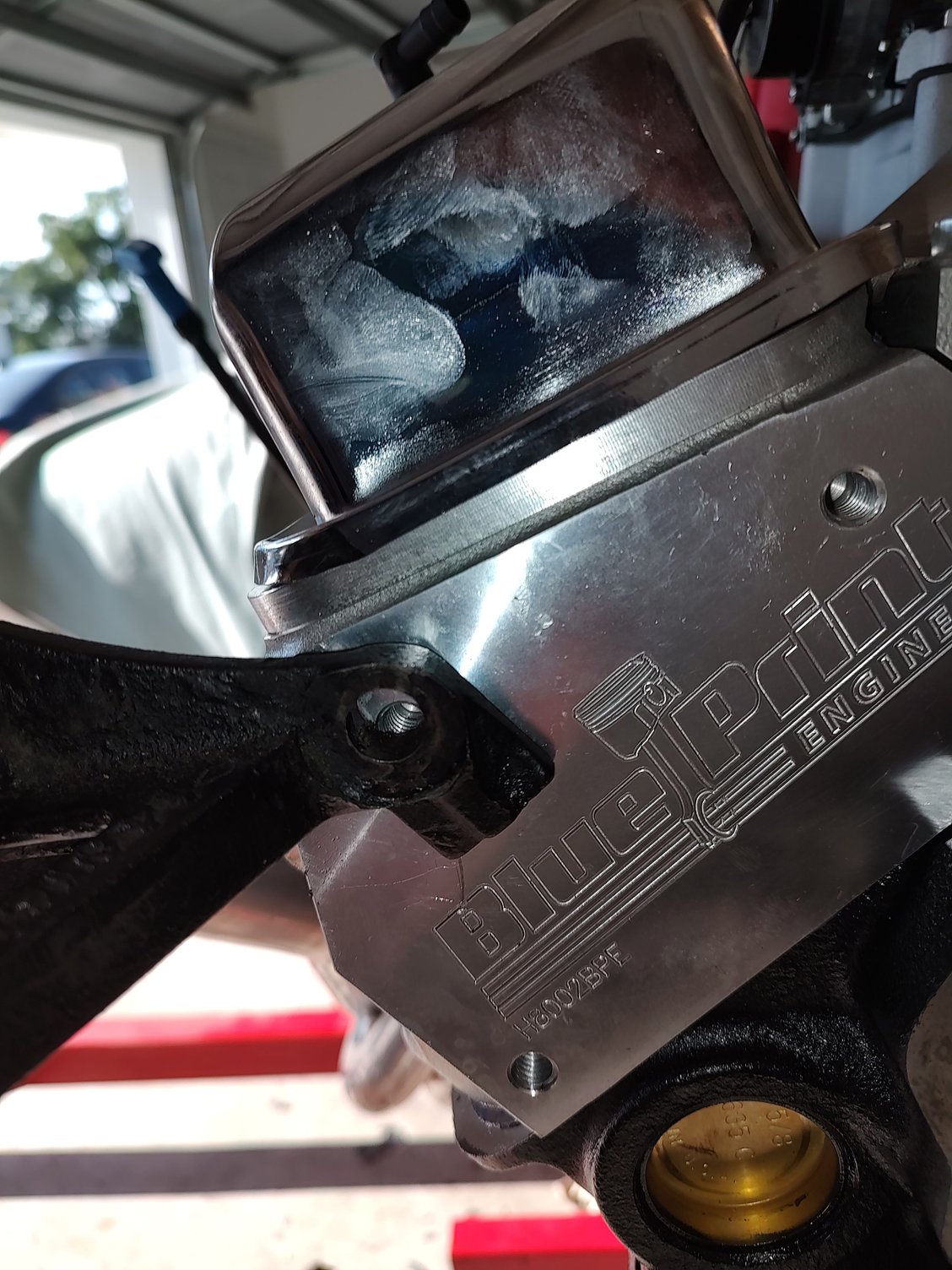

It's pretty much a bolt in but there's a few things that you need to be aware of. You'll probably need the one piece rear seal style flywheel or flex plate and other thing is you may need to elongate the A/C mounting brackets due to the raised exhaust ports. According to Blueprint the exhaust ports are raised a 1/2 inch however I found the exhaust manifold/header holes were only a 1/4 inch higher than stock.
The only difference between the two engines is the deluxe dressed comes with more peripherals like a water pump and air cleaner that doesn't fit our cars, a steel braided fuel line (I made my own hard line), plug wires (I cut mine to length), etc so no reason to spend extra money on things that not useable.

OK, so when ex ports are raised 1/2" on the engineering drawing: its an sbc so exhaust flanges are at 45 degrees from Both vertical & horizontal.
Then use cosine of 45 = 0.7071. So 0.7071 x 1/2" = about 0.354"
If using 0.500" raised ex ports, each header flange is moved UP about 0.354" AND it's Also moved Outboard about 0.354"
The entire header moves Up & Out about 0.354"

I asked Blueprint about this and the SBC blocks are new casting sourced from American and German foundries.
