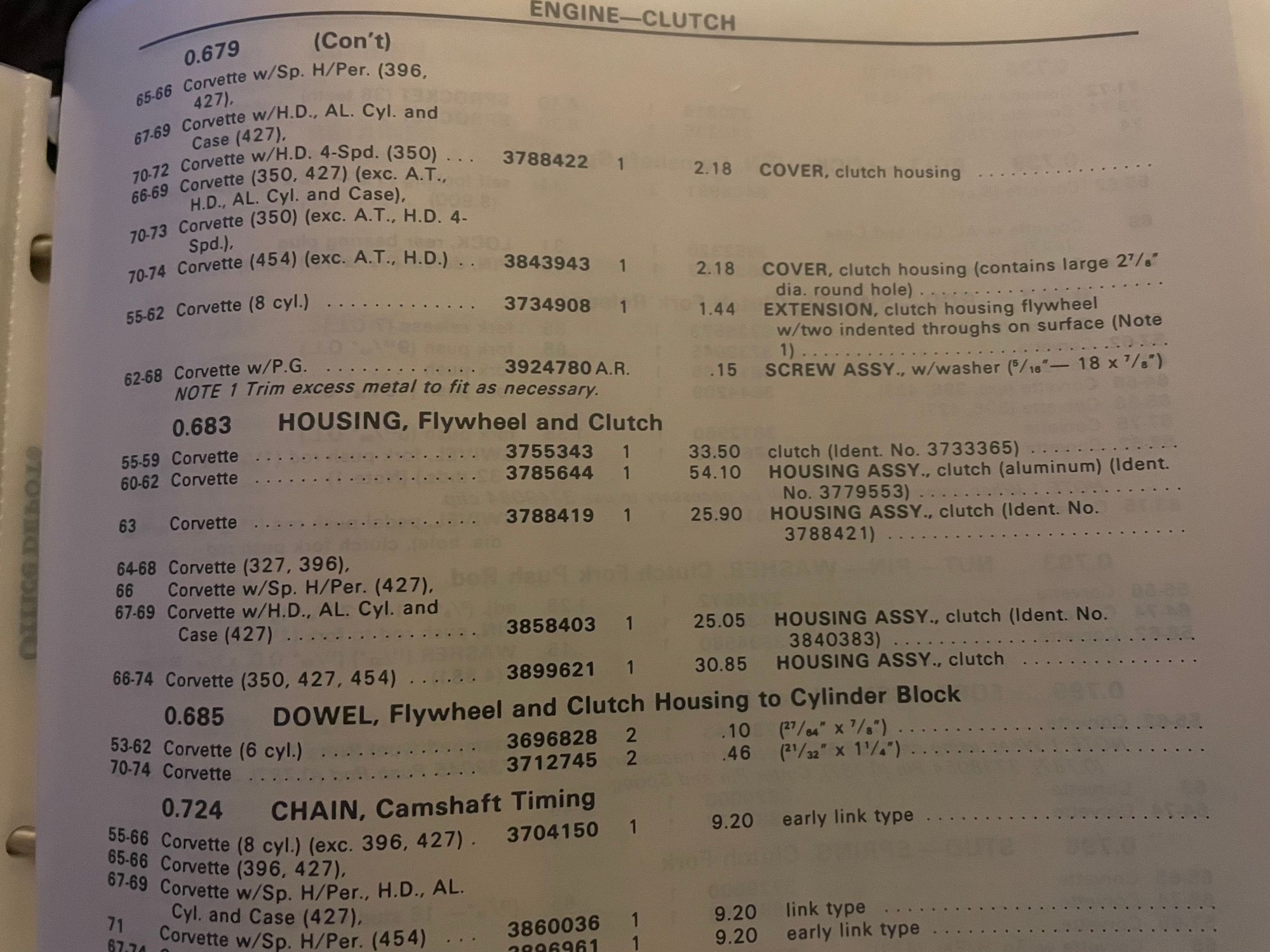

403 bellhousing is correct for a 1968 Coupe 327 with a Muncie 4 speed (with 153 tooth flywheel)?

That would be the smaller 10.5" clutch that was used on SBs until 68.
11" was used afterward, with the other starter, flywheel and bellhousing
They changed that when the 350 came out, with it's extra torque.
In 68 only the 350 SB got the bigger flywheel setup. My SS Camaro had it.

Yes, the "403" is the bellhousing you need if you're using the 153 tooth, 12" diameter flywheel, but wasn't this all discussed and answered in your post from about a week ago?
As you can see from the Parts Book page 69L88 posted, the "403" casting was also made wearing the casting number 3840383. I think the "403" is more common bellhousing. In fact, in 45 years of dealing in parts I don't recall ever having a "383" casting, but if you come across one cast "383" it will work with your 153 tooth flywheel.
I don't know exactly why GM went to the 11" clutch (14" dia. 168 tooth flywheel) in 68, but I don't think it had anything to do with the amount of torque a standard 350 produced. The smaller 12" flywheel, 10 1/2" clutch combination was what Chevrolet used behind some of their strongest engines, including the 1965 L-78 396/425 (415 ft lb torque), the 67-69 427 L-88 (460 ft lb "advertised" torque) and the 70-72 LT-1 (380 ft lb,of torque. the same as the standard 69-70 LM-1/L-48 4bbl 350).
Again, I don't know why the change was made, especially when you consider the smaller flywheel will allow the engine rev a little freer, but it doesn't appear to me the torque rating had anything to do with it?

I had gotten some conflicting information and it really muddied up the whole thing. I wish I had known about the 383 as I have one of them! (Just ordered a 403!) Oh well. Appreciate all the input
