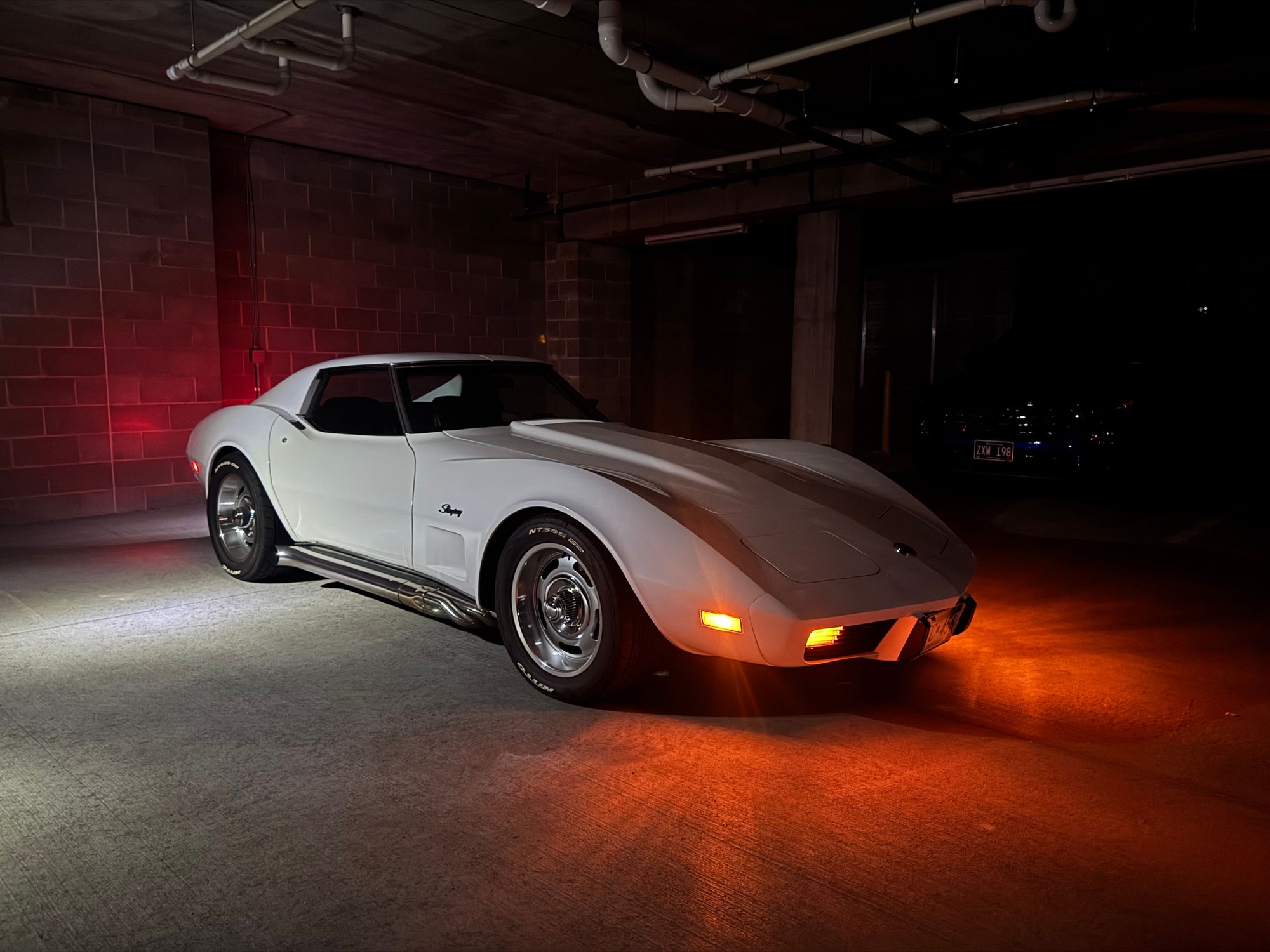

Yes, although the rocker panel may need additional trimming.
Doug’s headers and side pipes with Flotek heads, which also have raised exhaust ports.
That's a nice tight fit and looks great. Well done!

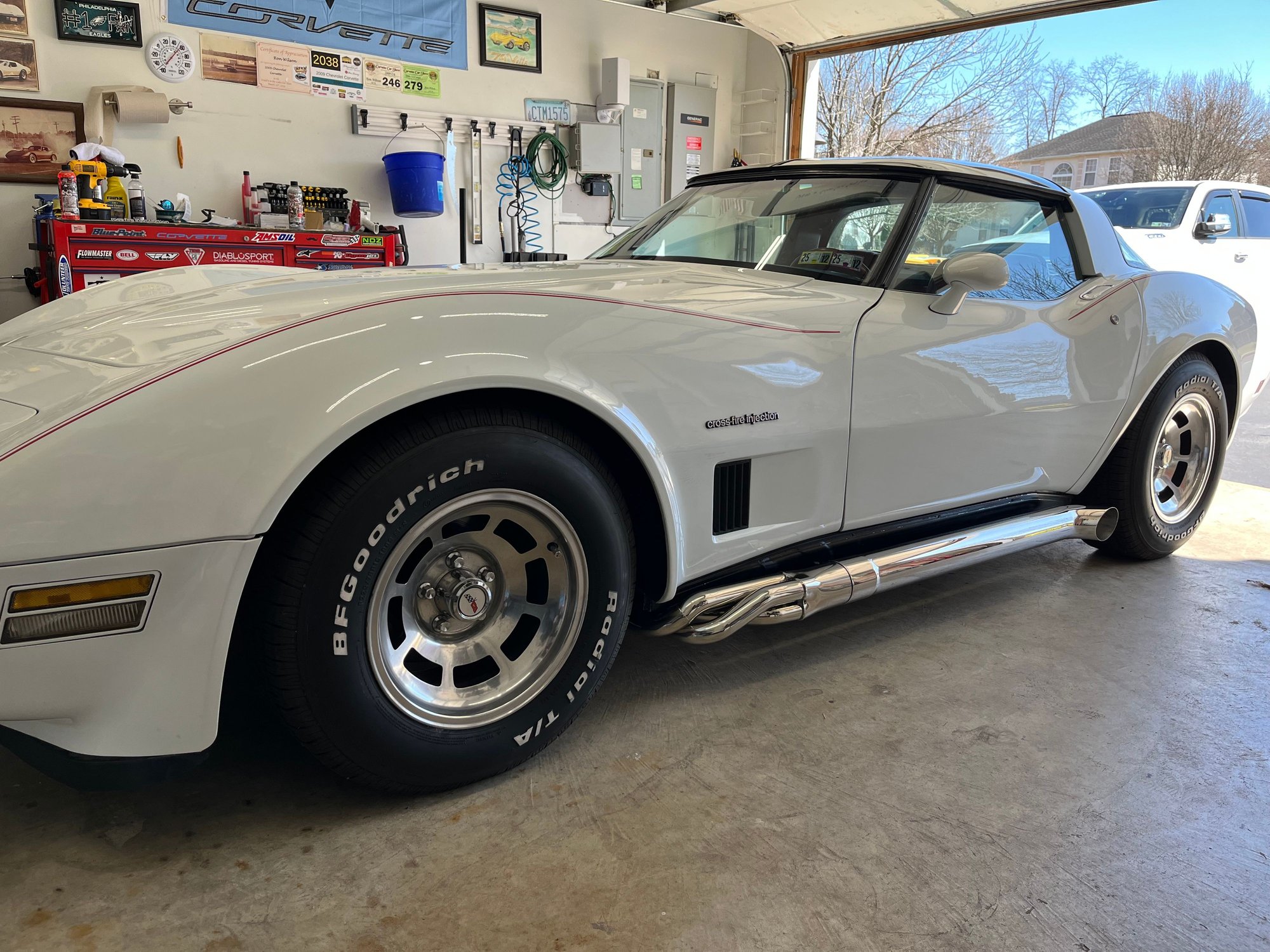

Doug’s with VettePack inserts, GM crate motor with raised port heads. Fit fine, I was surprised cause Summit said they wouldn’t work with angle plugs and raised ports, but they do.
