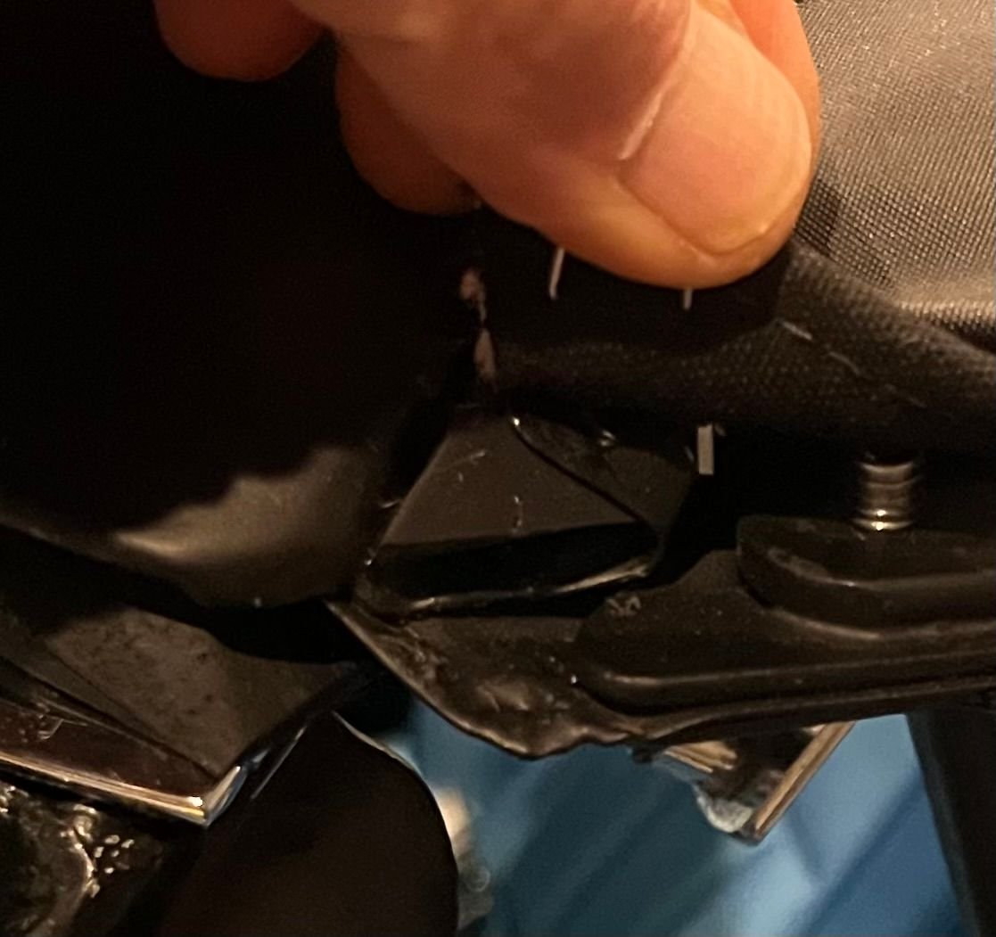

Recovering my 70 convertible top. The bows have been completely rebuilt and I have no idea where the tension cable springs mounts to on the header. No holes or anything else. The tension cables came with two pop rivets but do they go on the back of the cable and the spring hooks into the header somehow? Any help would be be greatly appreciated. Here is a pic of the front header where the spring should go but no hole🤷‍♂️

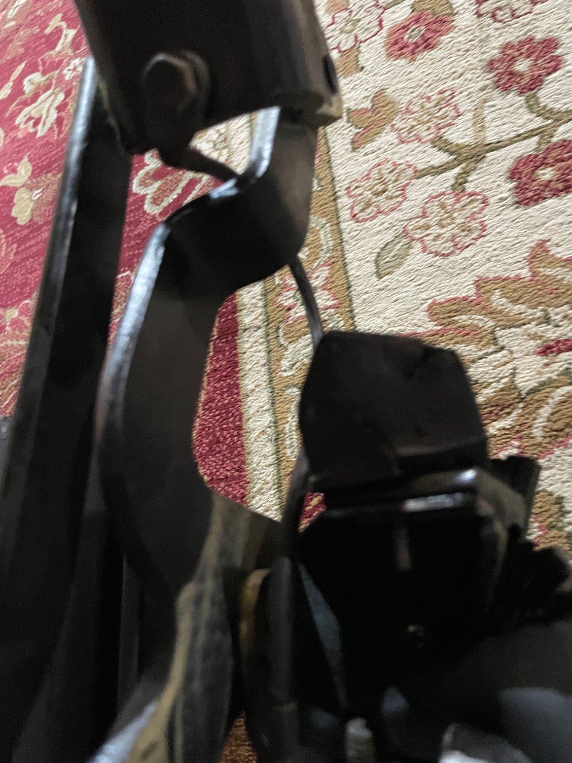

I am probably off base with what you are asking but I happen to have my 72 top off and on the ground so took a couple of pics. Here is where my tension cable is connected on each side. Don't see a spring.

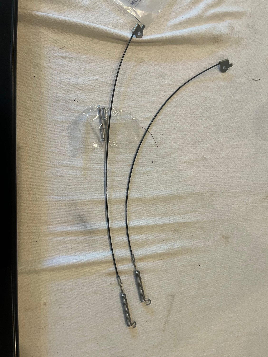

72 might be different. Here is what my cables look like. I see where the back of the cable goes but I don’t see where the spring end goes exactly. I do know it goes to the front header of the top somewhere 🤷‍♂️

yea, nothing like that on mine that I can see.
