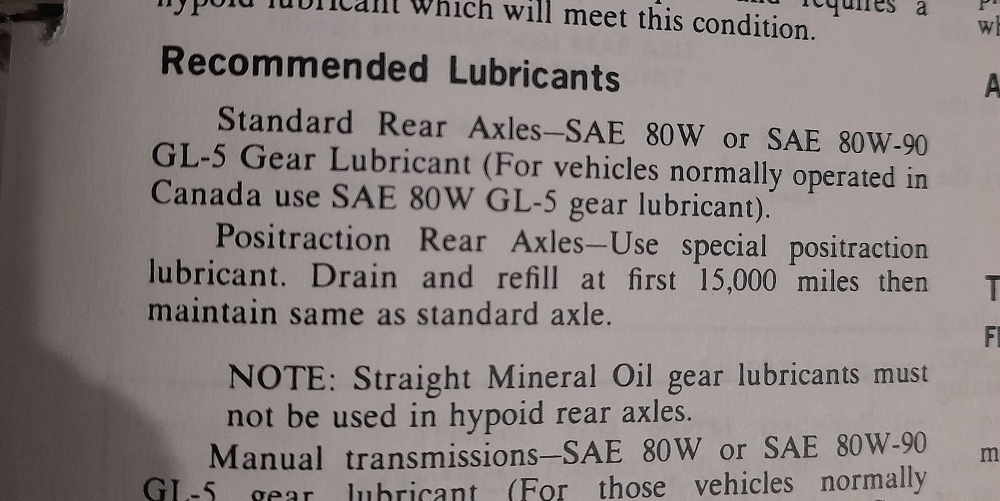

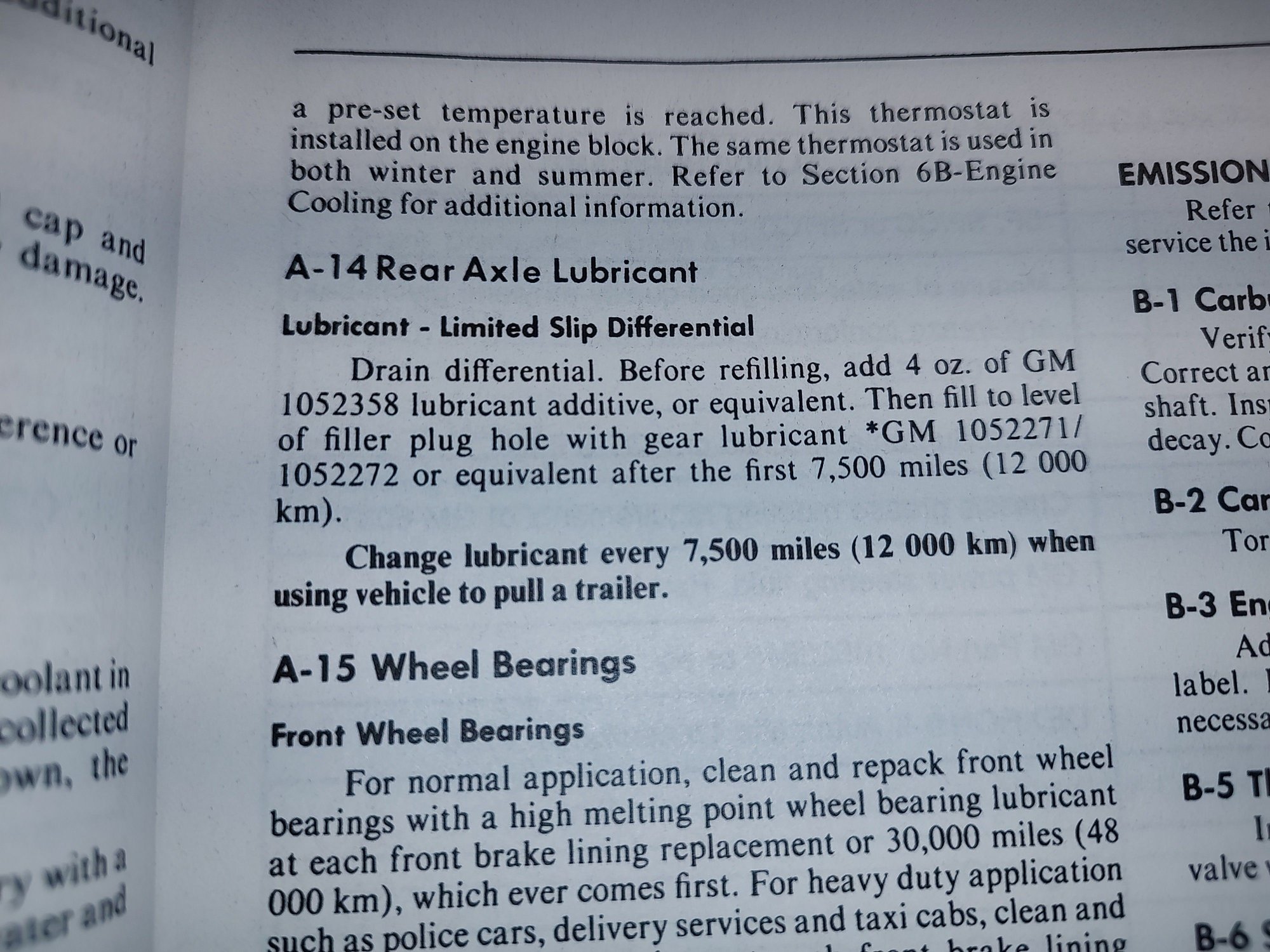

Just for fun I thought I'd look it up in my gen. GM service manual.
Notice it doesn't mention anything about using 2 bottles of additive. Yet most people on here say to.
And not to argue with Gary. But the factory doesn't specify a 140W gear oil. I've always run 80w-90. Limited slip gear oil. And no issues.

Interesting, my 82 FSM doesn't mention anything about limited slip gear oil but does mention the additive.
