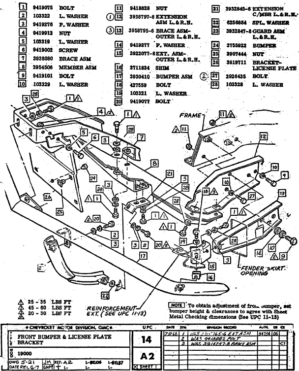

The radiator isn’t directly mounted to the crossmember, the radiator support/frame is, along with bumper supports that are connected to the middle bumper brace as well as the bumper guards.
When I replaced mine, it was really rusty and I found the rad frame to be totally rotten where is sits on the crossmember and needed to be replace as well.

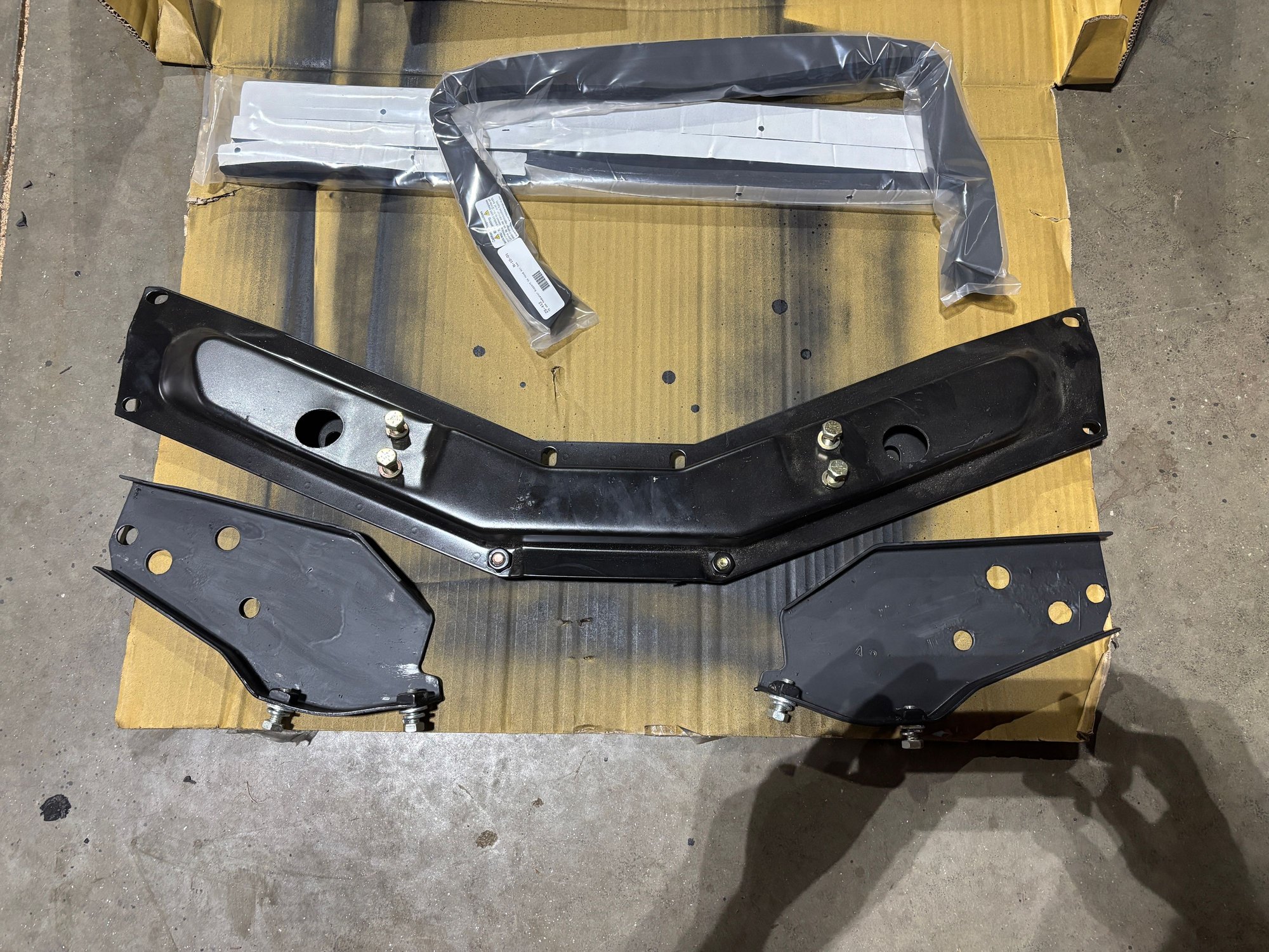

I just installed a new one a few weeks back... these pics might help with Kidster's diagram
To Front cross member question
