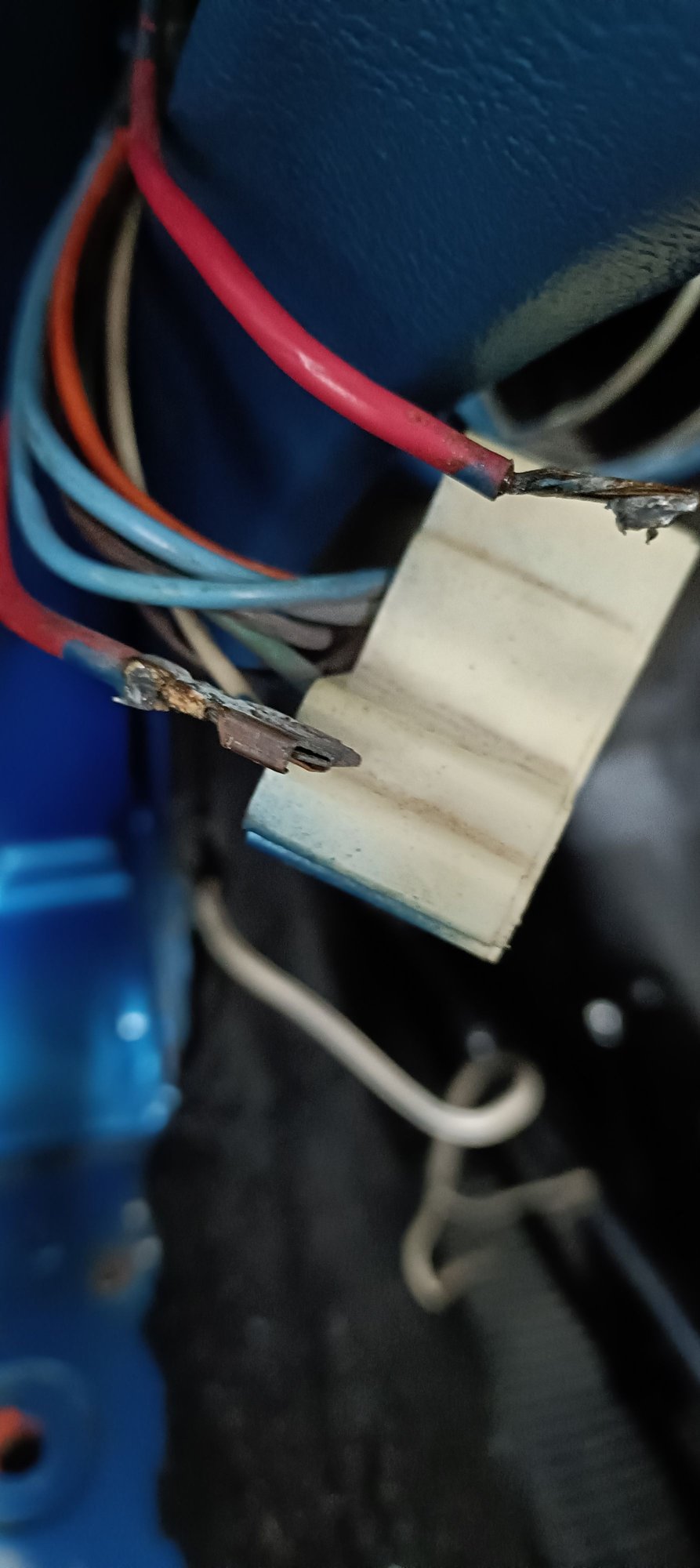

Seems a PO had fitted a new wire to feed power to the wiper override switch, it was piggy backed onto a connector on the headlight switch but their solder joint had gone dry and fell apart when I wiggled it.

Well - found the pics- this is how GM did it back in the day!
