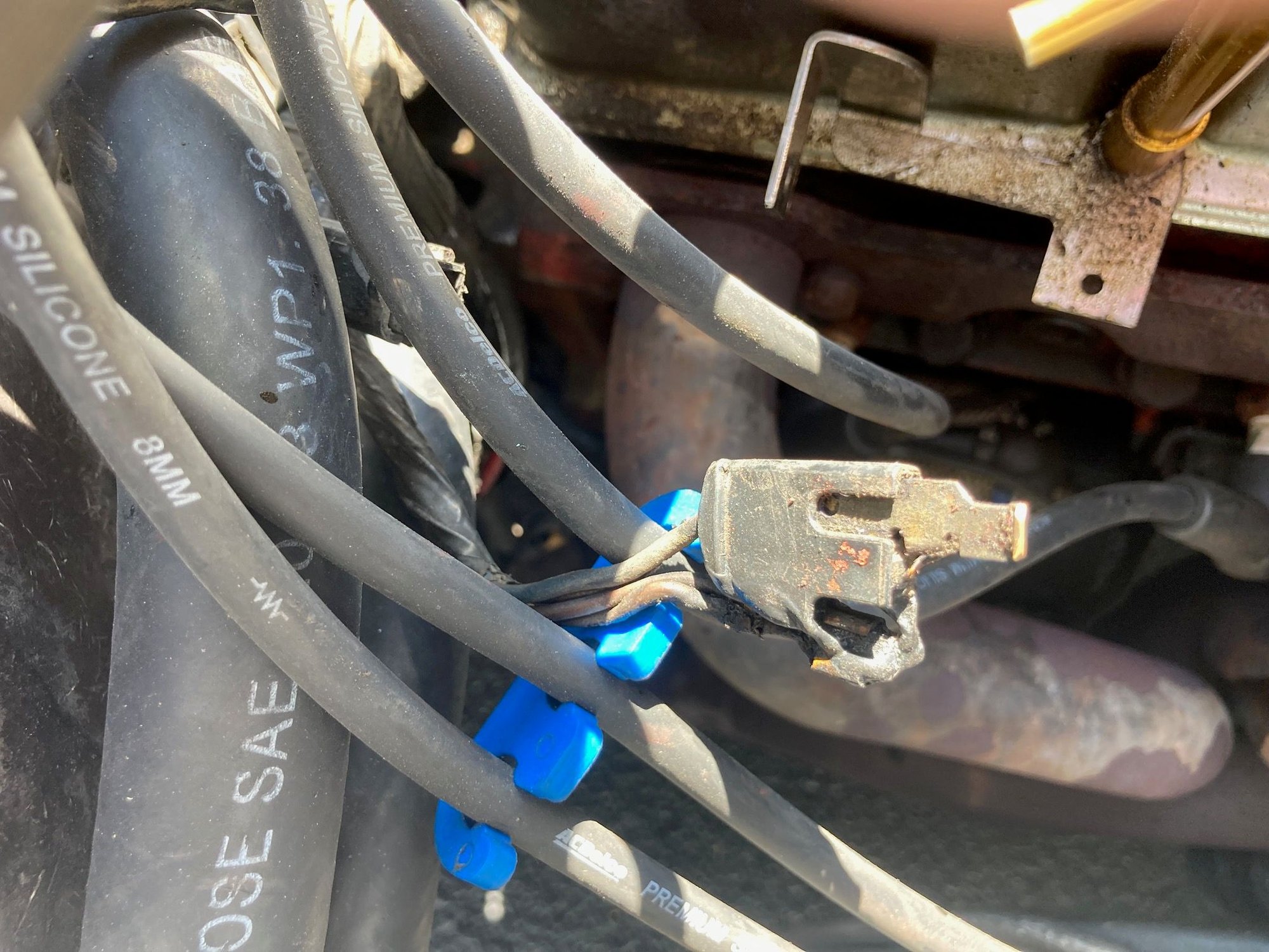

I have a 72 convertible. I bought it with some problems. I have it running and driving. I found this plastic plug burned near the pass side exhaust in the rear of the engine compartment. Any thoughts? I have looked at the assembly manual and the wiring diagrams, but not much has come to me.
I tested them for power, no power with the car running.
thanks

Eliredandblack's Avatar
Eliredandblack
Joined: Feb 2018
Posts: 2,327
Likes: 721
From: Marietta GA
On the 73 model year there is a plug with two wires below the brake master cylinder. The wires leaving the plastic 2 wire connector goes to the transmission for the back up light switch. You may need a wiring schematic and then determine the color of the wires. Not every year has the same color wires, or even the same routing or harness bundles.
thanks
That's probably the connector for the TCS (transmission controlled spark) Solenoid.

That spade on the TCS solenoid, looks like what i have in my picture, so i will start looking as wire diagrams on confirm, but i think thats it. thanks for the help
thanks
Are there 3 wires in that connector, and can you clean them enough to get the colors of the wires?

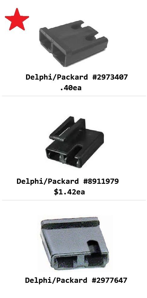

I'm not sure the reproduction solenoids require the correct 2 cell connector housing?
The reason the connector housing (melted one above) has the 2 slots the Male terminal of the solenoid has protruding tabs sticking up...
The idea was GM only wanted the connector installed to the solenoid one way, protruding tabs of the terminal aligned with the slots in the connector housing...
The correct connector housing is Delphi/Packard #2973407...
They are about 40 cents each but there is most likely a shipping fee...
The other 2 housings in my photo mean nothing to this post...

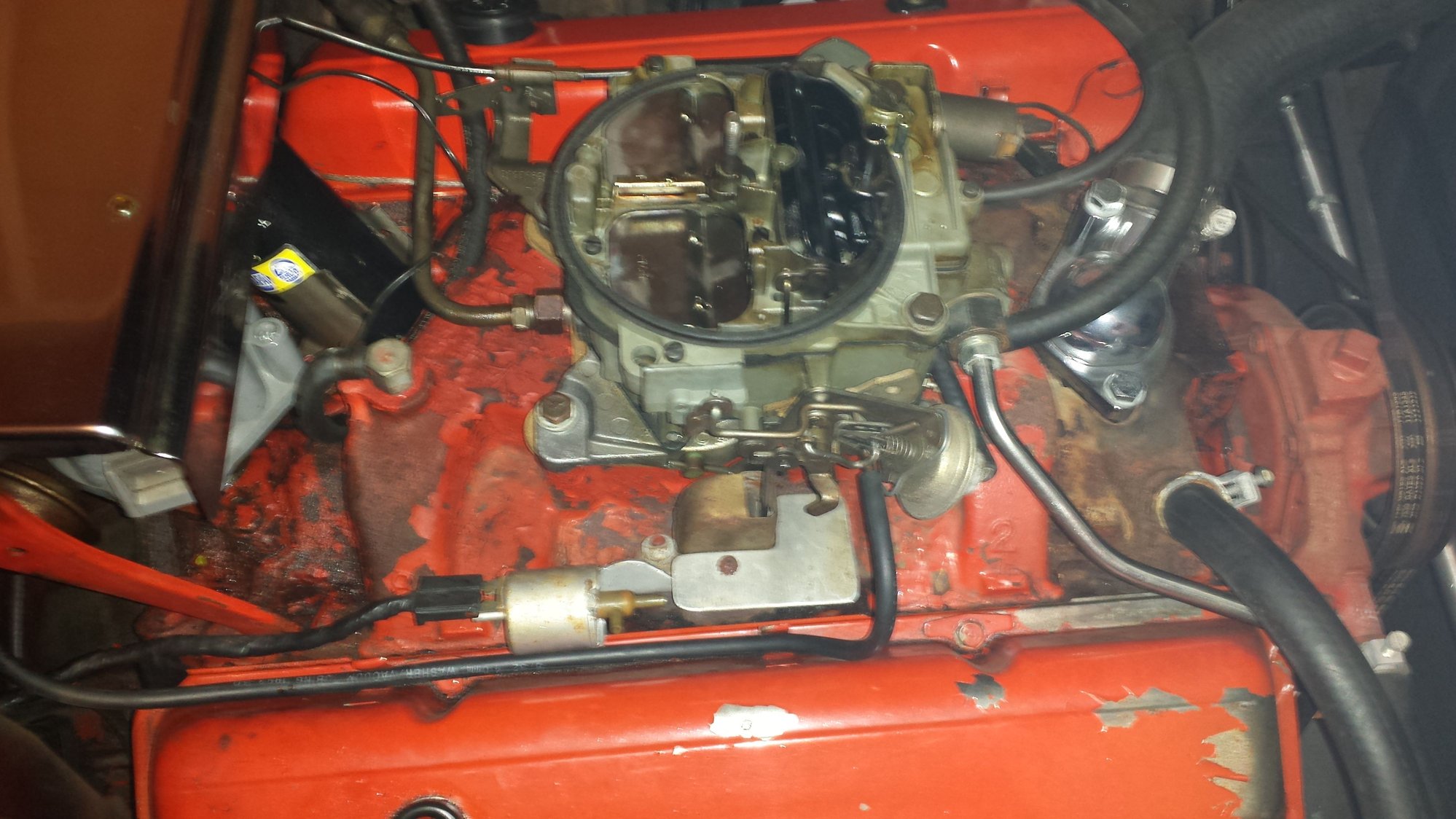

I found a much better photo of the TCS solenoid.
Thanks for the added help.
I checked and there are two pairs of wires. so two into one male spade and two into another male spade.
I need help with the colors as i am color blind.
i will report back when i get help
