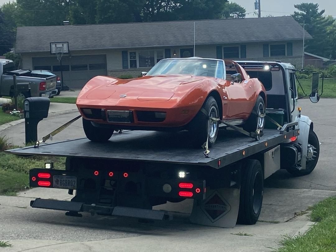

I own a 1976 with less than 50,000 miles. Last year, I painted and mostly re-assembled my 1972 442 so I hardly drove the Corvette! It had less than 50,000 actual miles! It sat in the front garage most of the summer and returned to the detached garage in the fall. I started it a few times but didn't try to drive it until yesterday! It has always had what I call a "Hang starter" that would pause for a brief second before it turned over. It has a new battery this spring and yesterday I was going to fill it up with no alcohol gas and was going to take a long drive in the country! Went to the gas station, filled up and when I went to start it, it still hung for a second but would only turn the engine a few degrees. AAA came out, checked the battery as good, cleaned the terminals too but still won't turn over. Brought out a flatbed and got it home and in the garage. Next up, it will go up on jackstands and I'll check connections to the starter and it that's not an issue then I'll remove it. The real question is, does anyone know of a good, reliable, trustworthy rebuilder of starters for cars within 100 miles or so from the Dayton, Ohio area?? I'd really like to keep the original on the Vette and don't want to switch it out! I just don't want someone to half *** rebuild it.
