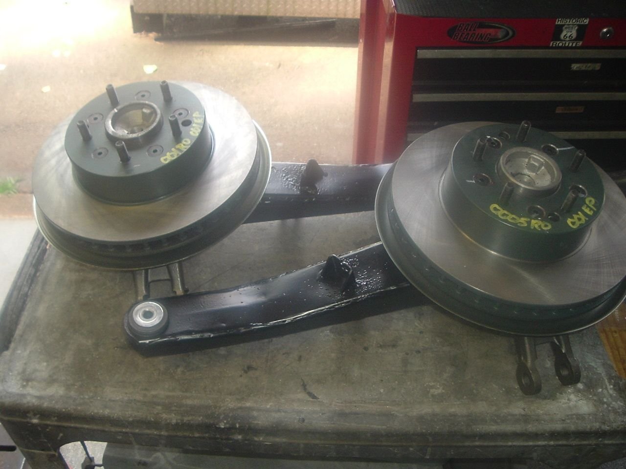

The rear bearings are common tapered bearings. Nothing special about them. Setting them up correctly is the concern. One shot to do it right. I do not recommend reusing bearings pulled off an axle.
The setup tools vary in quality, you can use an old axle if you have one but they're not the best option, just cost less. You need a good dial indicator, one that doesn't stick or drag. The do wear out. After many years one of my Starrett's is shot.
Now, how you set them up is the key. The spec of 001-008" might as well be a mile wide. I machine fit them for no lateral play and have my own procedure to do them. I own a corvette machine shop and have all the tools and machinery, plus I have been doing this for decades now. I don't say this to scare you from doing it, just to let you know you might get in deeper than expected. That will cost more time and a lot more money if it's not right from the start.
I just did these today. One has 001" rotor runout, the other is 0005", both machine fit for -0- lateral and not to a specific, common endplay.
Be sure about this before you start, if you have any doubts there are probably 100's of places that can do them, and they will probably all be different. From good to bad.
Good luck.

I'm sorry Gary. I understand you are the foremost authority on the topic.
But I was tought that timken bearing endplay specs were designed to compensate for the expansion of metals as they heat up. Those rear bearings are going to warm up going down the highway at speed.
Your method of disregarding the factory specifications could possibly have consequences. That bearing set-up at .0005 is definitely tighter than factory spec. And I am certain your intending to reduce brake rotor run out.
But what happens to the end play when those bearings heat up?
We use an identical bearing set-up on Harley's from 73-99. And oddly, we run a larger end play for rear wheels than front wheels. Because the rear wheel doing the work of driving the motorcycle forward in theory builds more heat.
So, that rear axle set up with almost zero end play?

I'm going to go with Gary on this. When it comes to tapered bearings I like a bit of pre load on them. Why? Because I feel letting the bearings bounce around does more harm than running them snug. In my 42 years as a mechanic I've never had a bearing failure. And as I like to quote "let the book come out here and fix it".

Look at the picture again- 0005RO= rotor runout. 001 EP= endplay. The bearings still have endplay in them, they don't have lateral play in them. These rotate smooth, not free-wheel, just glide and once on the car will seat a little more. Going to the first spec, say 002", and leaving it there will have lateral play. Once the arm is assembled that will be felt at the rotor at 3&9. I don't like that play so once I dial them in it is gone, yet the end play is still there. Been doing them like this for years. Now with 31's I do set them with a slight preload, never a problem.
