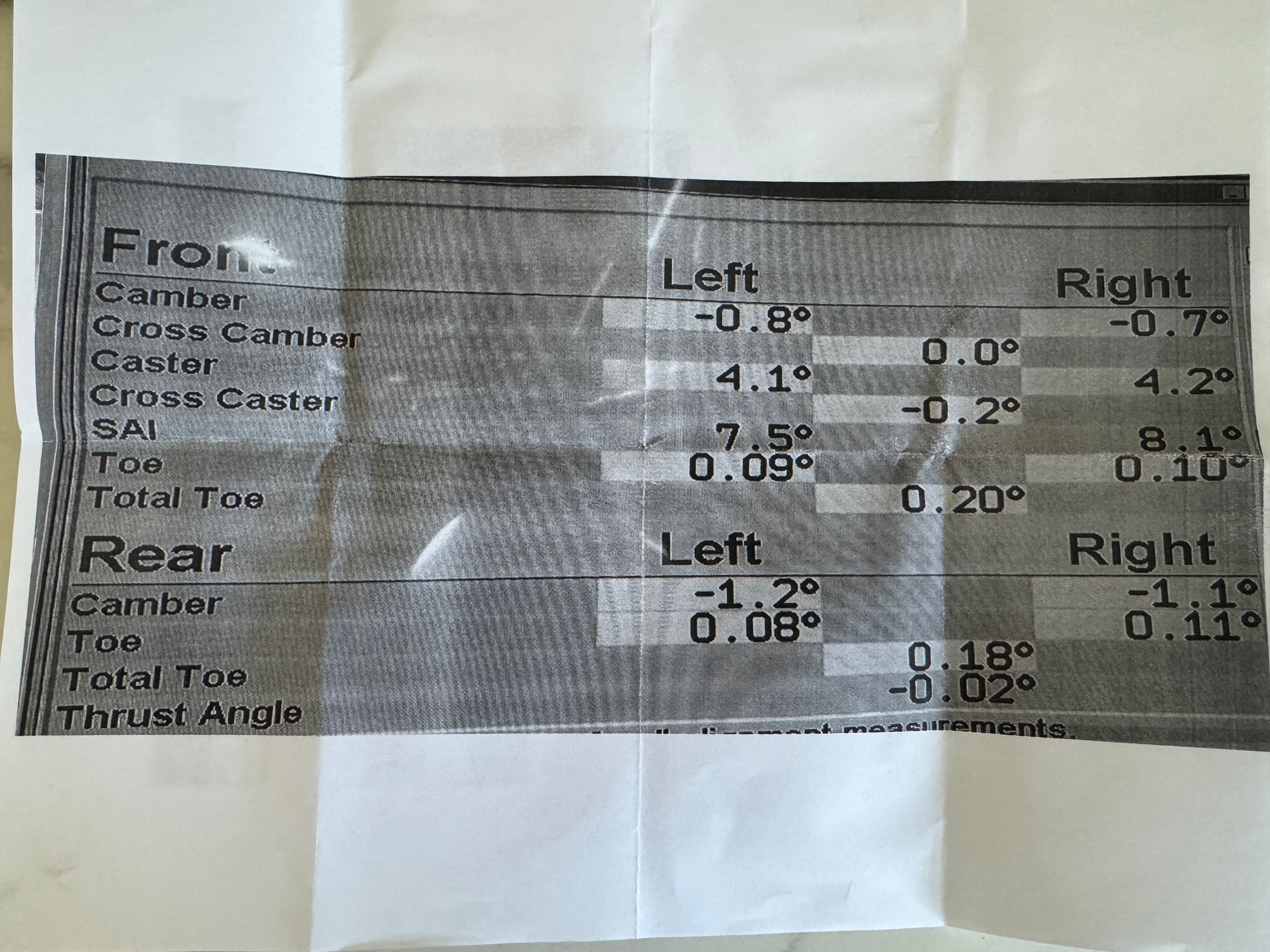

Alright guys, I just picked the car back up from the alignment shop. Here’s the new specs:
The car definitely drives better, it doesn’t feel like it randomly wants to drive off the road any longer, but I still wouldn’t say it’s 100%.
It still feels like I’m constantly having to correct the car. It drives straight as an arrow when you take your hand off the wheel, but it feels like small inputs are amplified. If the car hits a bump or otherwise veers off a bit, I need to pull it back and it feels like if I do too much I could over correct and lose control.
I have a feeling this has to do with the caster, since we were only able to dial in about 4 degrees. But wanted to get everyone’s opinion. The car is otherwise super tight.

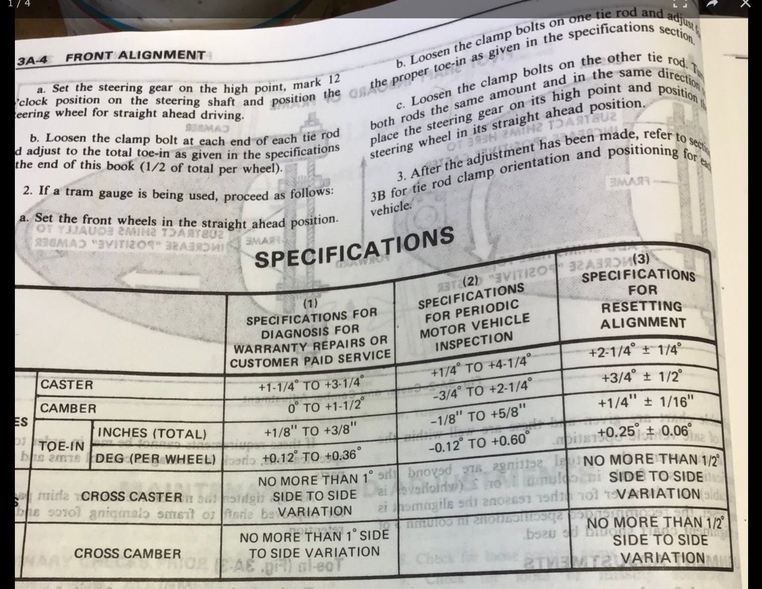

i don't think its caster.. how does it compare to factory reset specs? maybe more toe?

leigh1322's Avatar
leigh1322
Old Pro Solo Guy
Posts: 8,001
Likes: 4,357
From: Marlton NJ
Ok much better!
But still not there yet.
See post #23 and #35.
Maybe hand him the Van Steel specs.
You MUST have 1/8" toe-in in the rear (.30*).
You do not, so the bump steer (tor change) makes it go into toe-out on a bump, and steer the car.
That is what you are feeling.
All 4 cambers could be less, and so could the front toe-in. But all that is just tire wear issues.
But it is the rear toe-in being too small that causes the instability.
You're close, so it is not too bad.
Just tell him it is still nervous, and hand hm the specs in post 23.

Ok much better!
Hmm alright, looks like I need to bring it back to the alignment shop…again. Hopefully he throws me a bone here, as I’m not excited to pay him a third time. Not sure why this has been so difficult
