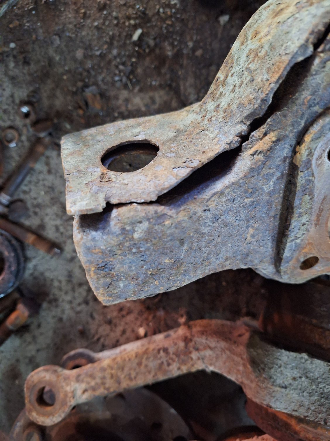

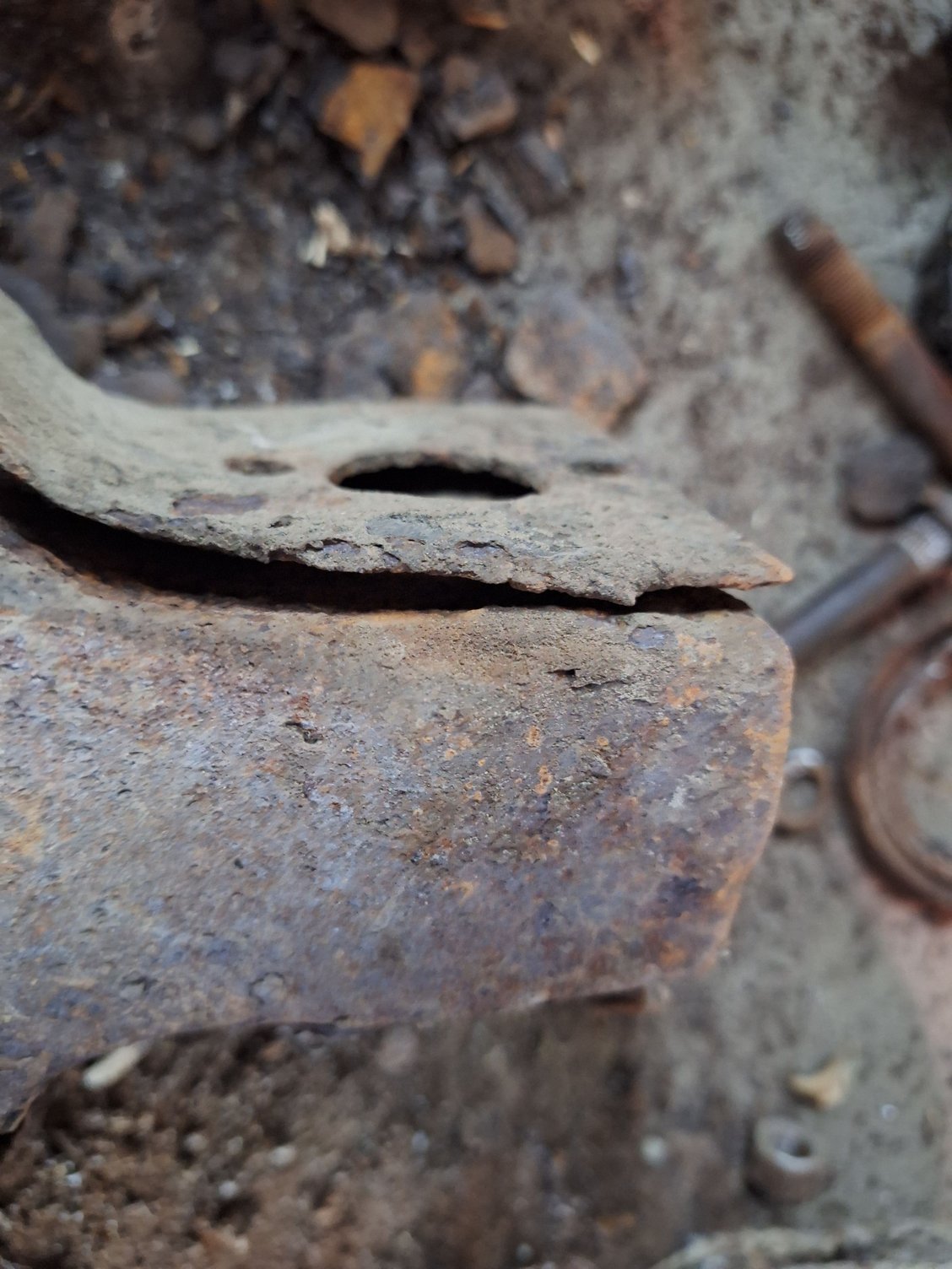

Just an example of cracked welds on trailing arms. These actually came off a car and the owner had no idea these were this bad. With all that crud, dirt on there, some spray paint on top maybe it is harder to see with the arms on the car.
After blasting I usually add welds if the arms are otherwise good, except when the arms have to look correct.
It is a good idea to get the wheels off and wire brush these areas and inspect, better be safe.
