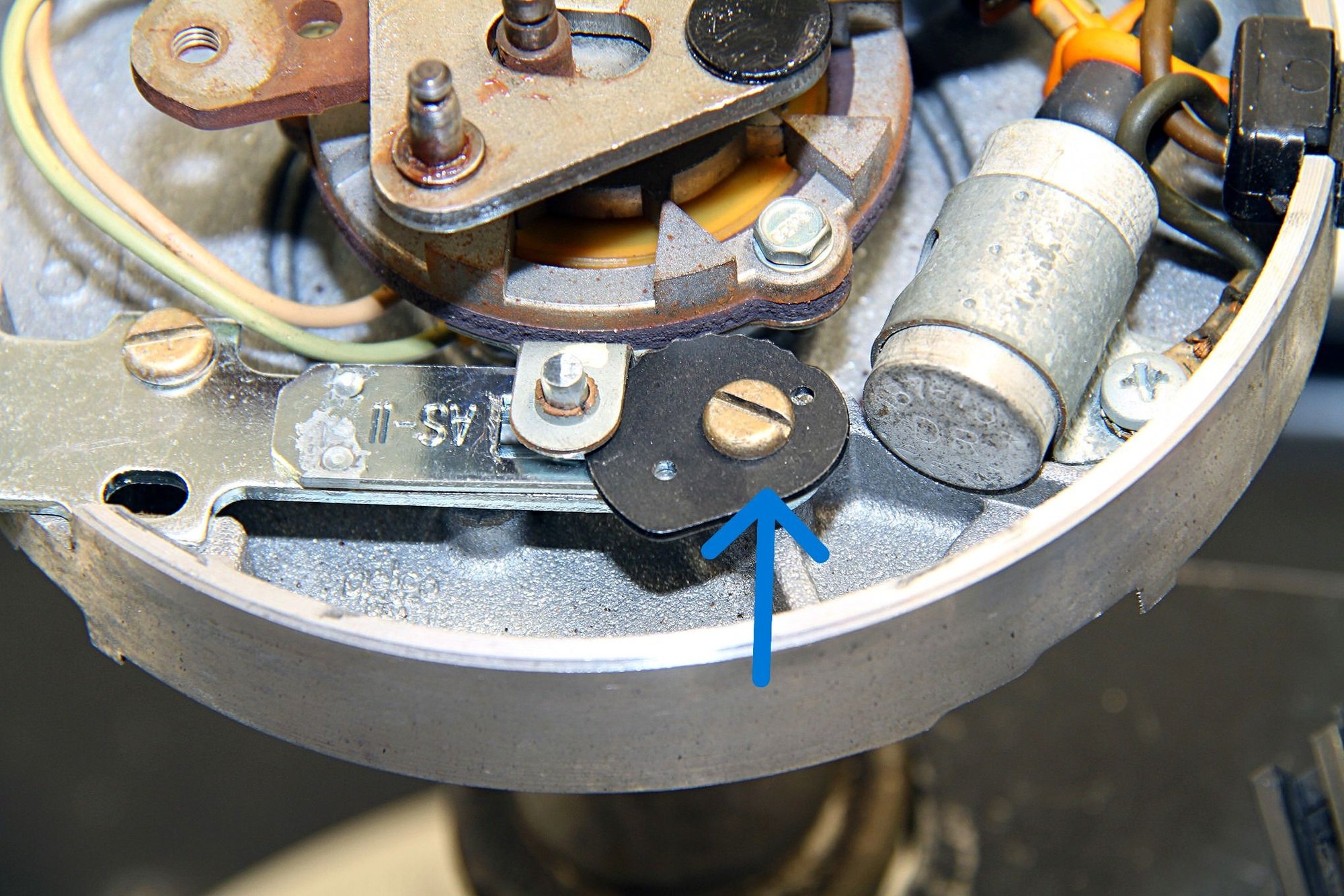

You could be experiencing something nicknamed "trailer-hitching." This is caused by too much vacuum advance at low RPM's....I think this Is what OldCarBum was referring to when he was talking about timing.
Try disconnecting the vacuum line (plug it) and take your car for a spin to see if there's any difference. If so you may get away with a $15 vacuum limiting piece that fits in the distributor.
Here's a pic of what it looks like.....

Exactly what I’m referring to.
I couldn’t remember the nick name for it.

Those limiter plates are not made anymore.
Not sure that is his problem anyway.
