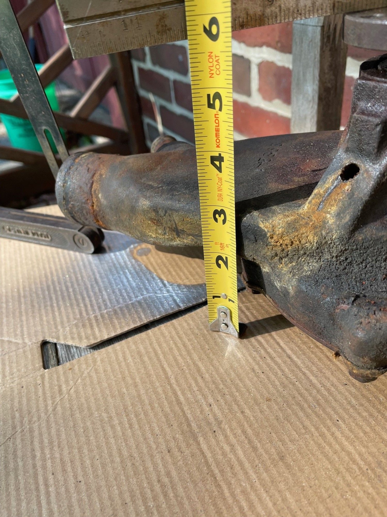

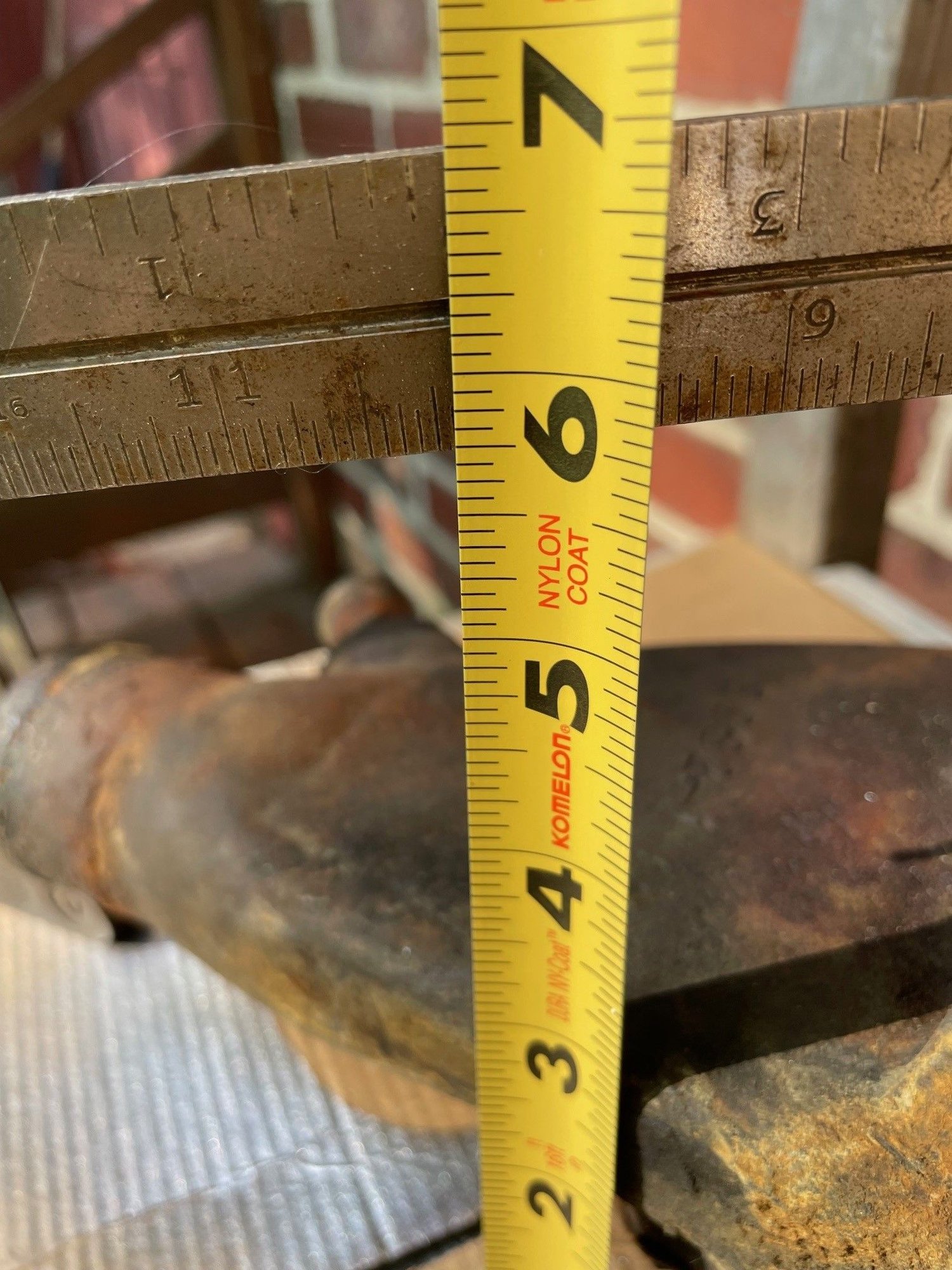

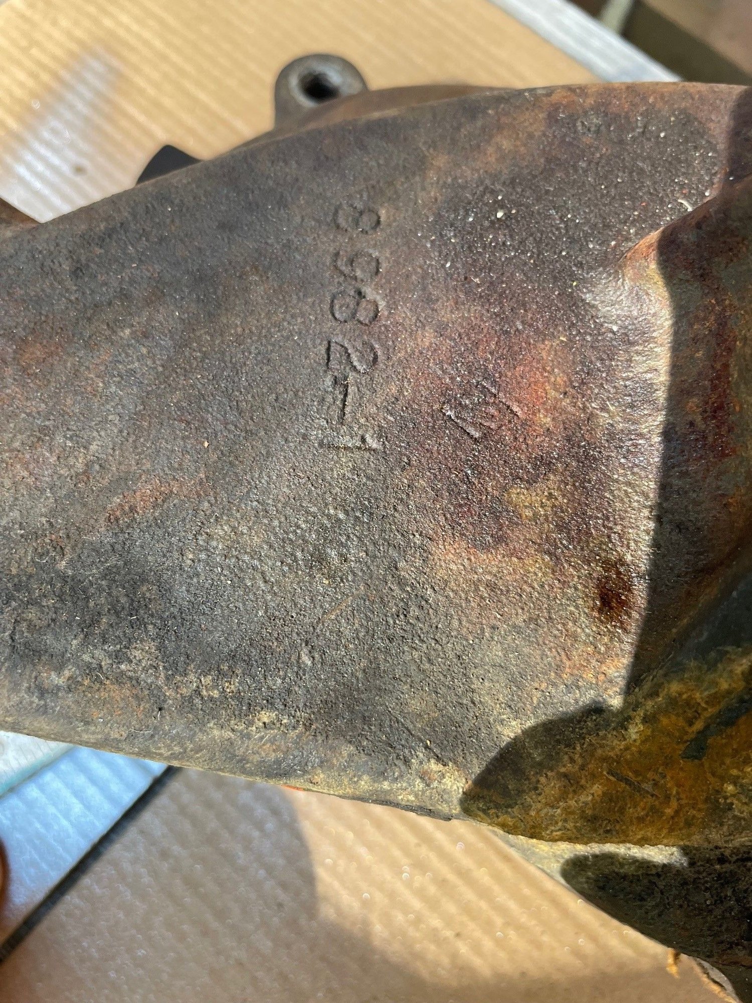

Default Additional info 74 pump
Guys,
I appreciate all the input.
I spent Friday trying to locate one locally and all I found even after Napa and Orielly's ordering them were wrong. Both didn't have the right dimension to the fan pulley or didn't have the correct dimension to the inlet nozzle.
I took some dimensions in case i find the correct GM Part Number.
After further research the GM part might be - #3992077, if it is i'll confirm dimes to help other in the future.
Or per Barkin grats might be '74 454 should have #6260822
Or I'll call corvette central for their super cool pump - reason I didn't is wanted to drive for the weekend.
Anyway, here's some pictures of what I have.

I've looked at Your pics closely.
Does your 454 have its 90 degree water pump-to-manifold bypass hose in place; or has it been plugged off ?
I'll second the choices from Stewart. Also, Edelbrock's Victor series.
Sadly, it seems Weiand has discontinued most, if not all, of its Team G series.
Victor is more robust than Edelbrock's Performer series. Likewise, Team G more robust than Weiand's Action Plus series.
Supposing Holley takeover prompted Team G demise ? At this rate, perhaps Weiand itself will soon founder.

Still have the by-pass - Concerns??

What ever you buy, measure the pilot pin in the center of the water pump that is for the pulley pilot pin hole, there are 2 different sizes.
