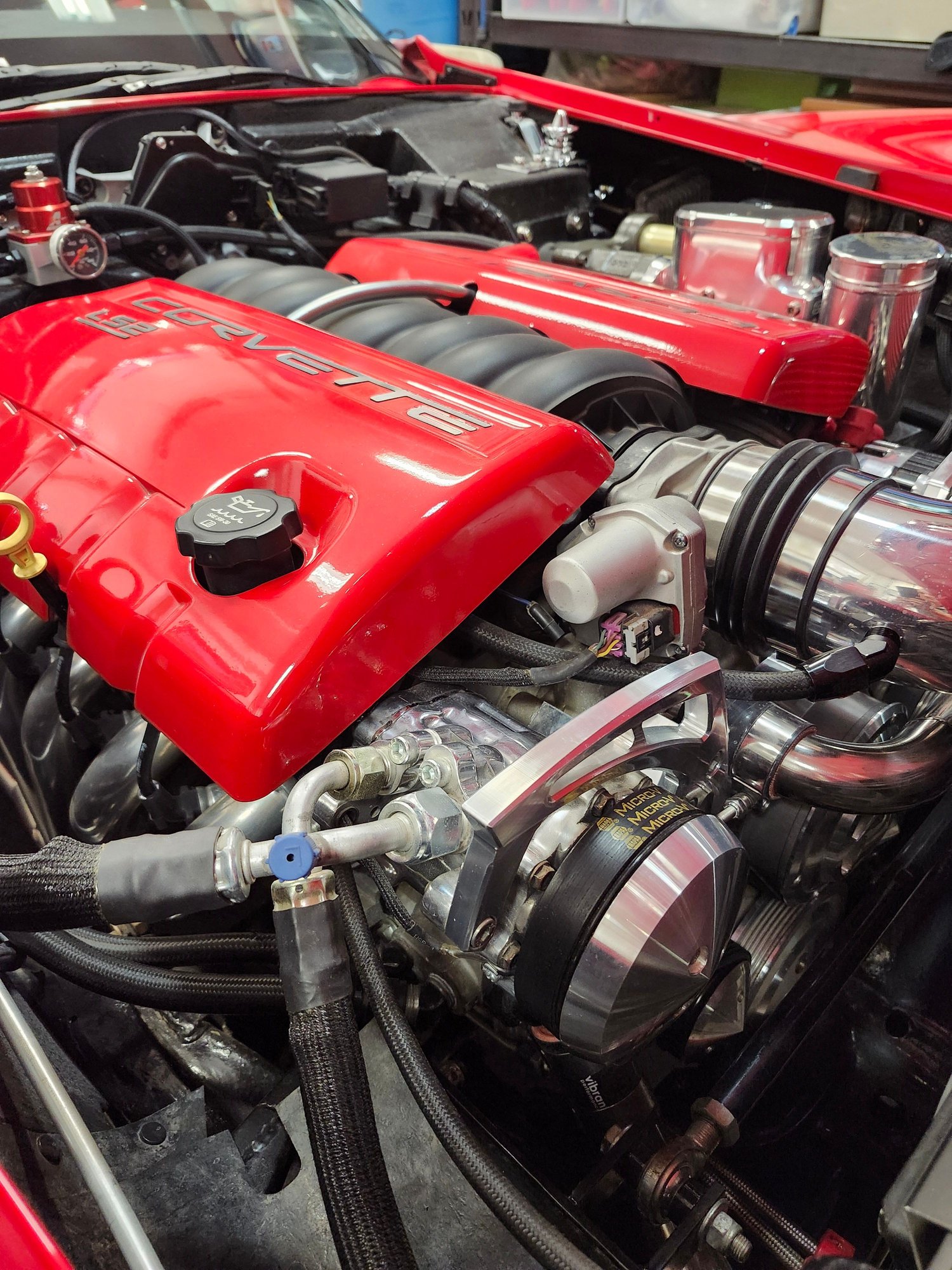

Hi, I am trying to mount VA Sanden compressor on my 72 with LS. Instructions are useless.
Can anyone take a couple pics of how it mounts? In order to get belt alignment I am hitting valve cover. Thanks! Tim

Afternoon, I think we are going to need a bit more information. We will need to know what LS you have (LS1,2,3 etc) and what the front pulley system is on the motor. As an example I have a LS2 with a march performance front runner system.

I have 6.0 out of suburban. Factory serpentine belt. Installing VA.
I have concluded that I have wrong bracket setup. Outer plate won’t mate to Sanden compressor.
Thanks for the reply. I ordered another bracket. Hopefully it will go smoother this time !
