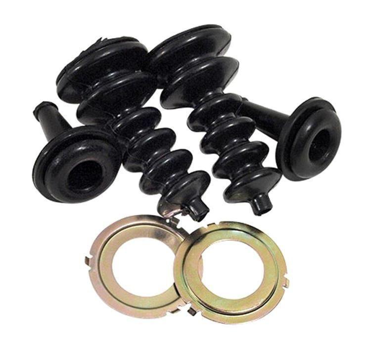

Replace these rubber parts in both of the actuators.
Replace the leaking relay.
As said above, cut an inch off of the hoses and check that there are no leaks at each connection.

Relays are rebuilt better than new by Dave J. Actuators generally just need a inexpensive seal and boot kit.
