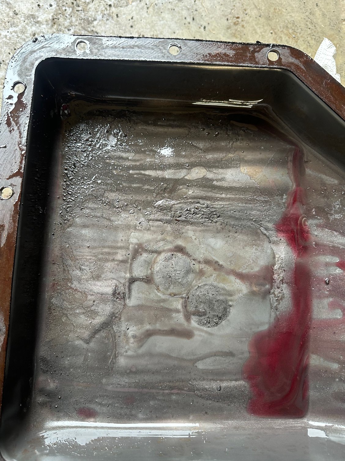

Lots of metal in the pan. Not sure if it’s worth trying to rebuild. Probably easier to buy a used one off of Facebook marketplace.

As far as downsides, depends on if you’re running the stockish 200hp v8 that most of these cars came with or if you got some hp mods. Stock 200r4s are not the stoutest transmissions. I’m sure it’s fine for cruising and normal driving but if you do any drag racing I’d stick with a th350/th400. Or get the 200r4 rebuilt with better internals, but it sounds like you want to avoid a rebuild.
not great to have material in the pan, but it’s not a ton of it. I’ve cleaned out worst pans. I’m surprised that would do it in, unless the trans was on its last legs to start with. Did you take a look at the valve body? Just curious.

Yeah it’s currently pretty much a stock 350 aside from intake manifold, and headers I doubt they would add too much power for it to handle. I didn’t do any other tear down aside from dropping the pan since I don’t know anything about transmission. Was looking at rebuild kits and was gonna use my th350 as a learning experience, but then saw the 200r4 pop up and jumped on it.

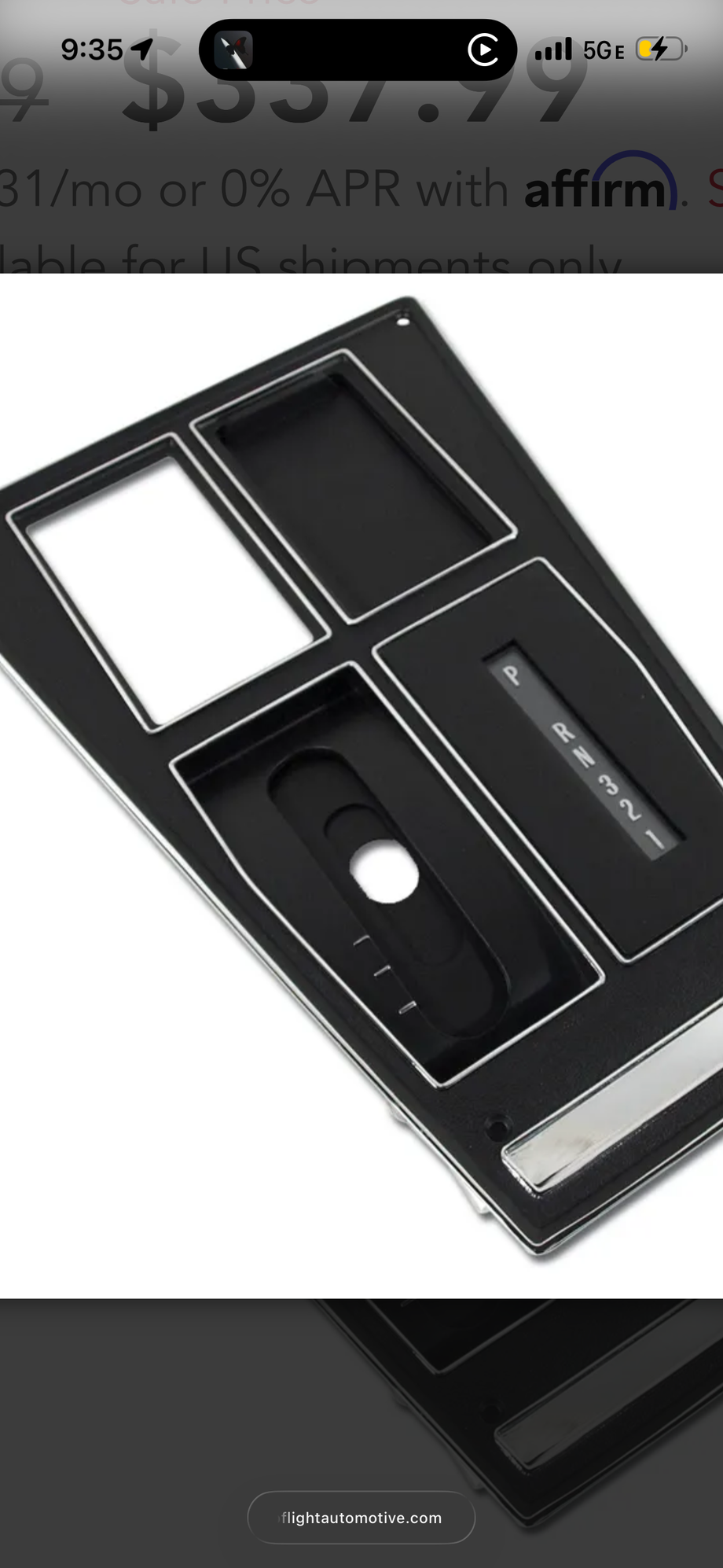

Hello again, quick question pertaining to the actual shifter and shifter boot. So in my assembling of the console to put in the new detent plate and gear indicator the old original shift boot I had starting showing its age. Now looking around I can just get the regular old leather boot but I was curious if anyone makes the plastic plates rather than the boots for the ‘81 like the 72-76 have?

Ethan_Hensley
I use a regular manual boot on my Manual console plate for my 200-4R.
Before you mess around with tranny lines wait till you get the 200-4R....they might just work.
IF you are buying a crossmember I hope you bought one that lets the exhaust pass-UNDER----- as long you're getting a crossmember...... if you did not, then I would suggest that you get one...it will be well worth it.
Just an FYI - you could have modified your existing Detent Plate really easily with a dremel tool. See here: https://www.corvetteforum.com/forums...post1604916531
