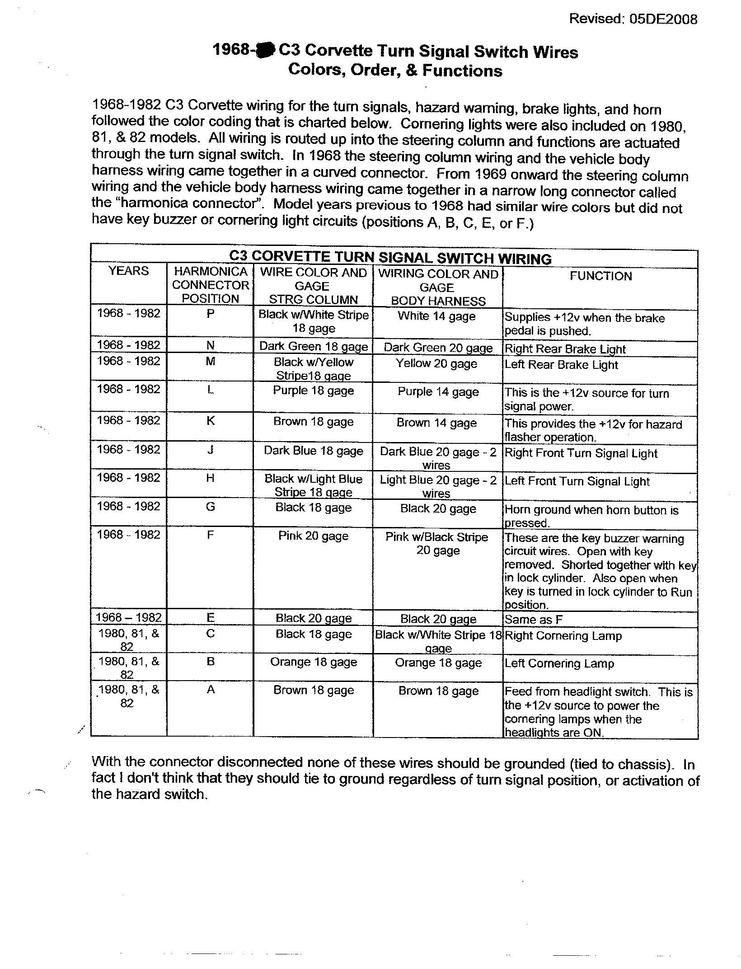

With the headlight switch pulled out to the first position, does the parking light go on?
If no then check the bulb holder for a bad ground:
Attach a wire to a good ground and touch the other end of the wire to the brass part of the bulb holder.
If it passes that test, check the harmonica connection for power with the turn signal in the turn left position.
Check 'H'.
