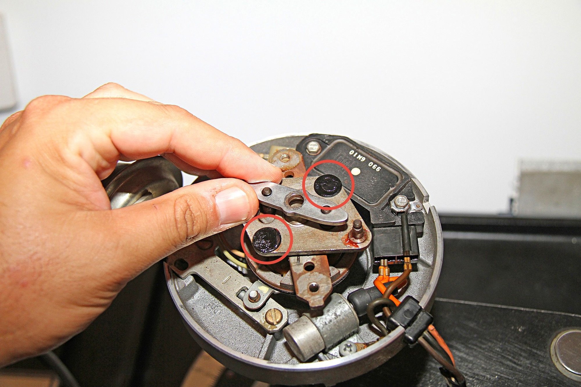

Good morning everyone,
As I was installing the vacuum advance limiter in my distributor I noticed that only the bottom half of this part was installed, I later found the top bigger half on the floor, broken.
It doesn’t seem to be making much of a difference in the timing or drivability of the car, but I would like to make it right.
What is the official name of these? Looking up “HEI mechanical advance weight sliding pucks” just gives me recurve kits.
I’d also prefer to buy a new one rather than a 40 year old cracking prone original one from a junkyard. Does anyone know where I can get just them?

Nylon wear pads ? you might have to buy a weight kit with those included. Dont know the size in this kit so might not be for a GM distributor.
https://www.msdignition.com/products...ers/parts/8628

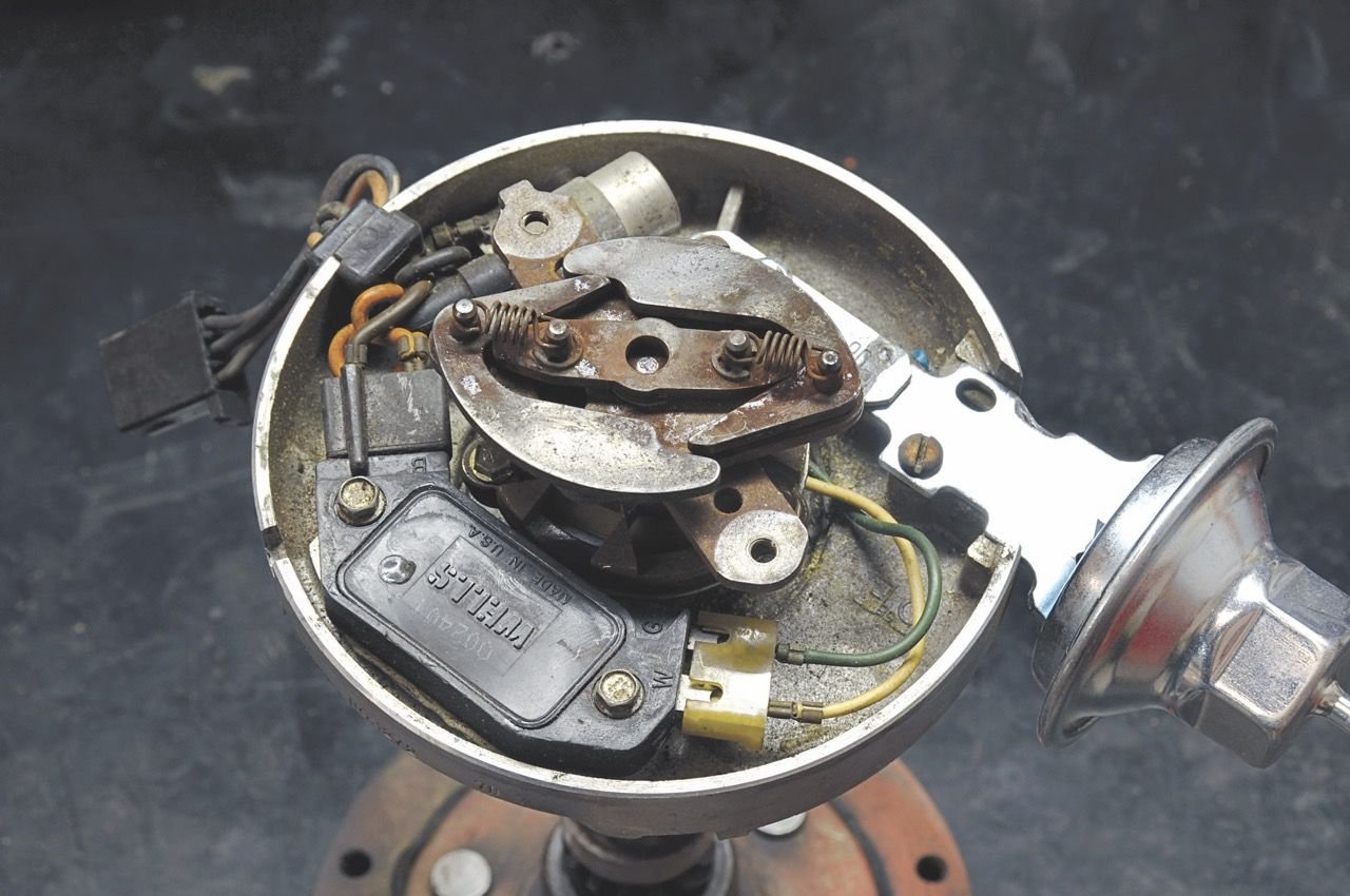

I assume you have the weights and springs. The attaching posts on the center shaft don't appear to have any area to attach the springs, maybe just the picture.
From the photo, the "pucks" don't appear to be all that bad.

The picture in my first post isn’t mine, just wanted to show what I was talking about.
I used the link to the MSD website, and according to the instructions they’re just called “weight pads,” which makes sense. I also found a different forum here that has different manufacturers part numbers for the things.
This is probably what I’m looking for then. The price isn’t too bad, but the shipping is where they get you. For that much it might be worth justifying a trip to the junkyard after all. Thanks for the responses everyone!
