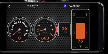

Gauge display screen on your phone for real-time viewing/tuning. MPH, RPM, Vac reading, current timing. Launch or boost retard. It uses the GPS sensor on your phone for GPS MPH. It has a vacuum/MAP sensor in the distrib unit for vacuum and load reading.
Gauge display screen on your phone for real-time viewing/tuning. MPH, RPM, current timing, Vac reading and Launch or boost retard (not shown). It uses the GPS sensor on your phone for GPS MPH. It has a vacuum/MAP sensor in the distrib unit for vacuum and load reading.
