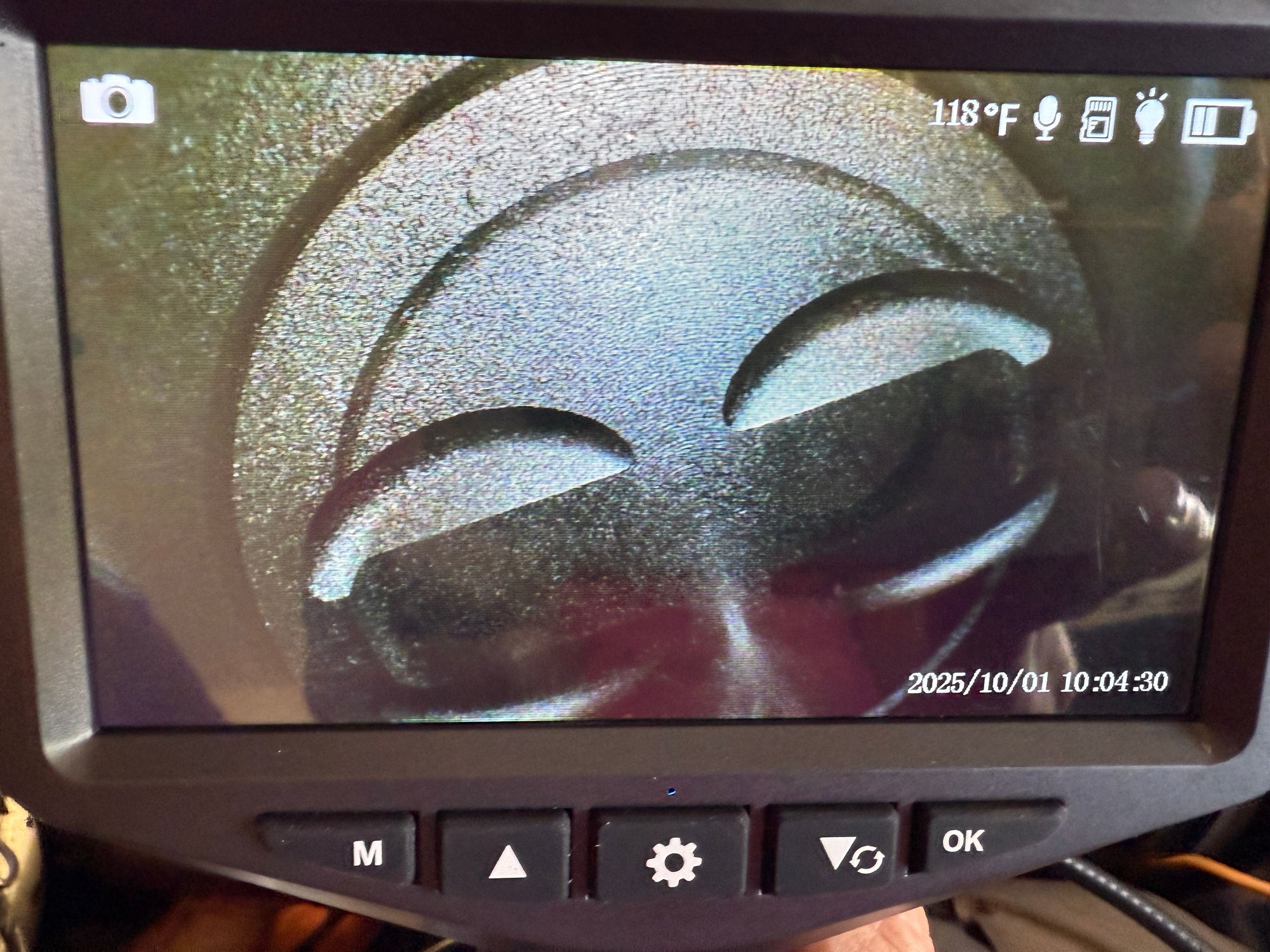

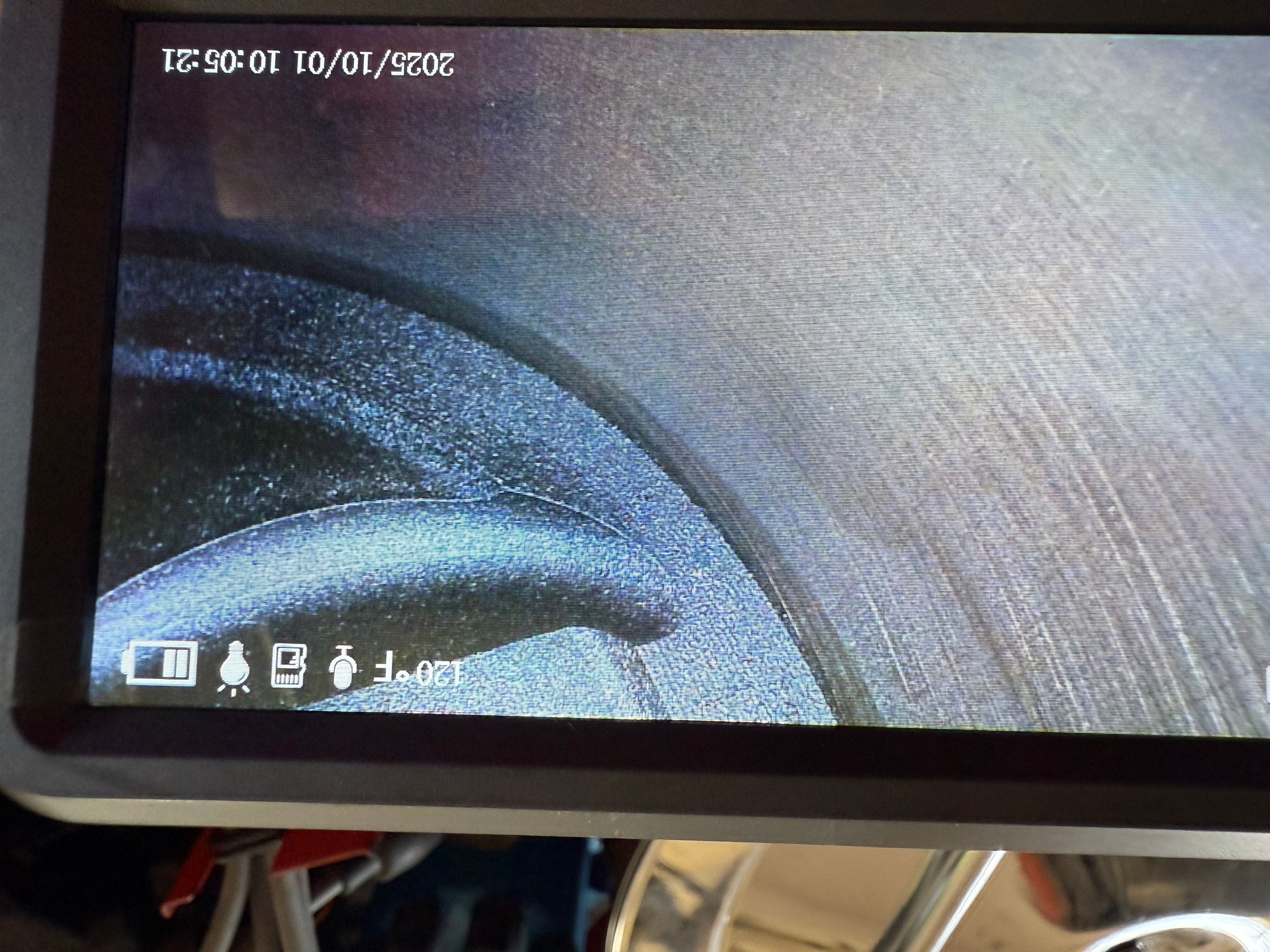

Old Oct 1, 2025 | 12:56 PM
jasselmeier's Avatar
jasselmeier
Joined: Apr 2007
Posts: 35
From: Columbia, IL
You'd think by this stage of my life I'd know better than to go for dirt cheap scope...finally got a borescope that works and attached are couple pix of piston and cylinder wall 3.
Also discovered on the 1995/96 engine rebuild, the used heads installed are: 3970126. Difficult finding the specs on...most info says these were heads used on base 350 in 1969-1972 on Caprice and like for 2 bbl configurations. Researching valve size info I've found: 1.72 or 1.94 in / 1.5 out.
Interested in everyone's thoughts on if those are OEM speced pistons or something else and #3 wall...
Thanks much!
Joe

Old Oct 1, 2025 | 01:09 PM
leigh1322's Avatar
leigh1322
Old Pro Solo Guy
Posts: 8,095
Likes: 4,449
From: Marlton NJ
Terrific pics and good news!
  • The hone pattern looks terrific.
  • No rust in the bores.
  • The engine has good leak down percentages
  • The pistons look like flat-tops! Or a mild dish.
  • If I had to guess those are 9.0 to 9.5 CR pistons, not the 8:1 big dish style, but not true 10:1 CR flat-tops either
I would say that short-block is very sound.
Throw the heads away, and put some 64cc heads on it and you will have 10:1CR
Stay mild on the cam, or you will go over 400HP very quickly! LOL
AFRs are the best, trick flows are very good for the $.
You need to pick the port size and the cam based on your intended driving.
So what rear gears do you have?
And how are you going to drive it?

Old Oct 1, 2025 | 01:28 PM
jasselmeier
Joined: Apr 2007
Posts: 35
From: Columbia, IL
You need to pick the port size and the cam based on your intended driving. But likely 175s. $1700 to 2300
Thx Leigh, very happy and surprised to learn about the pistons :-)
Pretty sure they're 3:08 but not certain. I'm really after a driver at this point blending low end with highway. Also don't want to gift significantly >400 hp absent chassis engineering upgrades to son/grandson. I remember how I drove on country roads in Southern Illinois when younger...
