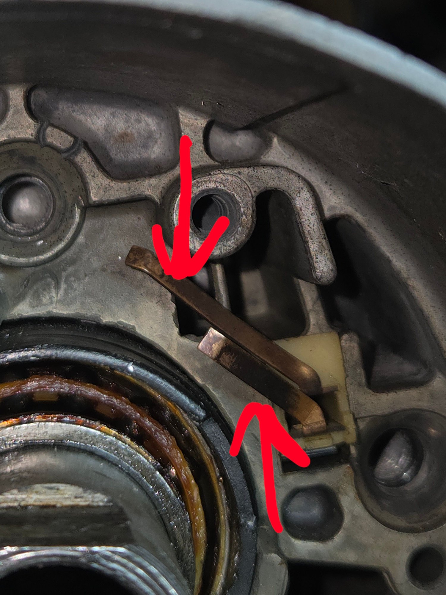

Hi guys So iam into the turn signal harness job on 1976 c3 and got some problems The first issue is the differences of the turn signal handle,i saw that lots of videos that it goes with a screw and mine is with scure plate,i was thinking of just drilling the plastic and getting it thru and scure it with the little plate.the other issue is how the 2 wire goes behind?Thank fo the help
[img alt="The pin from the turn handle will not go thru
Thinkinh on drill the plastic hole lil bit and then secure it with original metal shim"]https://cimg4.ibsrv.net/gimg/www.corvetteforum.com-vbulletin/1500x2000/20250924_112151_0e95e0e8d61e234c66187e8d 114e1ad12084dc3c.jpg[/img]
The pin from the turn handle will not go thru Thinkinh on drill the plastic hole lil bit and then secure it with original metal shim
In what diraction this 2 goes?
Thinking of drilling a hole for the pin of the shift lever to go thru

I may be the bearer of BAD news! Not every year C3 has the same turn signal switch assembly. I changed the turn signal assembly on my 73 without any big problems, I will guess your switch is not the correct one for your year. I can’t remember if having tilt/telescoping steering wheel makes a difference. You will have better response from Forum Members if you give specific details on your particular car, ie. Year, engine, tranny.

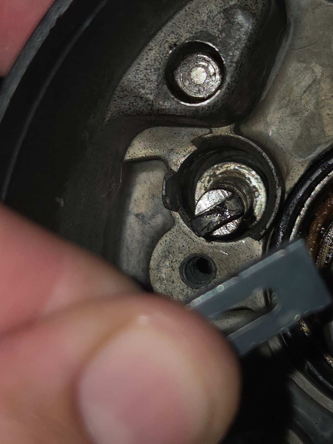

[img alt="Can you say what are those two?
And how does they goea? "]https://cimg0.ibsrv.net/gimg/www.corvetteforum.com-vbulletin/1500x2000/20250924_113939_565936cbe954bd2233dca61c 3a9fefc12ca57494.jpg[/img]
Can you say what are those two? And how does they goea?

tilt vs tele DOES make a difference as well.

Hard to be sure from your pictures, but I am pretty sure that is the wrong turn signal switch. 77-82 used the push in turn signal levers, so those switches don't have the boss to screw the lever in. Just get the right parts rather than butchering up the column or switch. Is your column a tilt/tele or standard, as said before, they use different switches as well. Oh, and your first picture is the key warning buzzer switch and it is installed correctly. I have been in a bunch of these columns, and have never seen the part you are calling the original shim. It resembles the piece that goes on the bottom exterior of the column that the lower trim piece fastens to.
