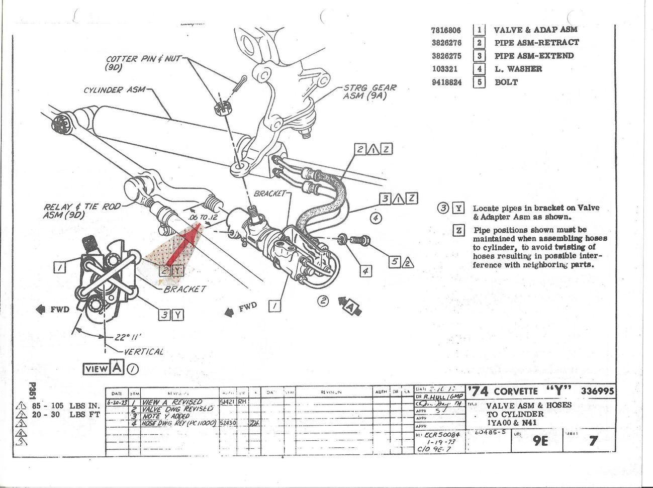

If the PSCV is not centered the steering wheel will pull to one side or the other, here's how to balance the PSCV:
If your steering wheel is not centered, here's how to fix that:
Hmm, I’m rather confused now. I was under the impression moving the tie rods in and out was only to make fine adjustments, if the steering wheel was off less than 30° or something. For a full 90°, I thought you had to disconnect the steering box from the pitman arm, and then spin the steering wheel 90° before reattaching it.
Doesn’t the steering box have four notches, meaning it can be installed in the North, South, East, or West positions? Or am I completely off base here?

Originally Posted by rabinaba
Hmm, I’m rather confused now. I was under the impression moving the tie rods in and out was only to make fine adjustments, if the steering wheel was off less than 3% or so. For a full 30°, I thought you had to disconnect the steering box from the pitman arm, and then spin the steering wheel 90° before reattaching it.
Often, when the PSCV is replaced, the gap between the old and new components differs, which can cause issues with the steering wheel.
That is when you need to adjust the tie rod ends.
You said that your steering wheel is off by 30% so the steering box or the pitman arm is where you should look first.
