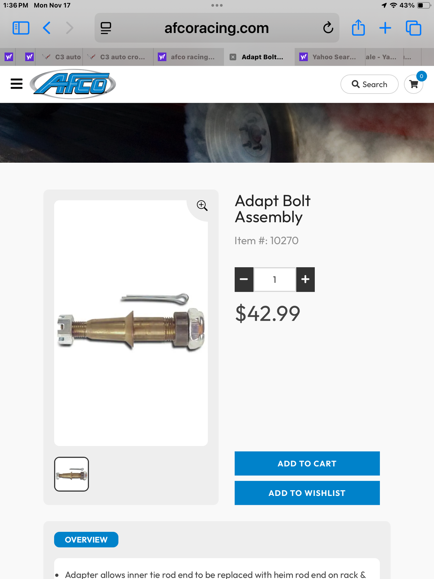

Default Bump steer.
Do I want to gain toe out / bump steer when the suspension travels up or just keep it the same through the travel?
Old Nov 16, 2025 | 04:54 PM
MelWff's Avatar
MelWff
Posts: 18,626
Likes: 2,553
The same, the purpose of this kit
https://www.vansteel.com/index.cfm?f...owItem&ID=3846

For tire response consistency, you want it the same, on bump especially, since the tire is twice as heavily loaded on bump.

I have been buying and using Afco for years and that’s probably where they buy them from. I can build that set for half that price and already have them on car. The reason I ask is because of the racing I did it was ok to drag the inside tire a little just wasn’t sure about corvettes.
