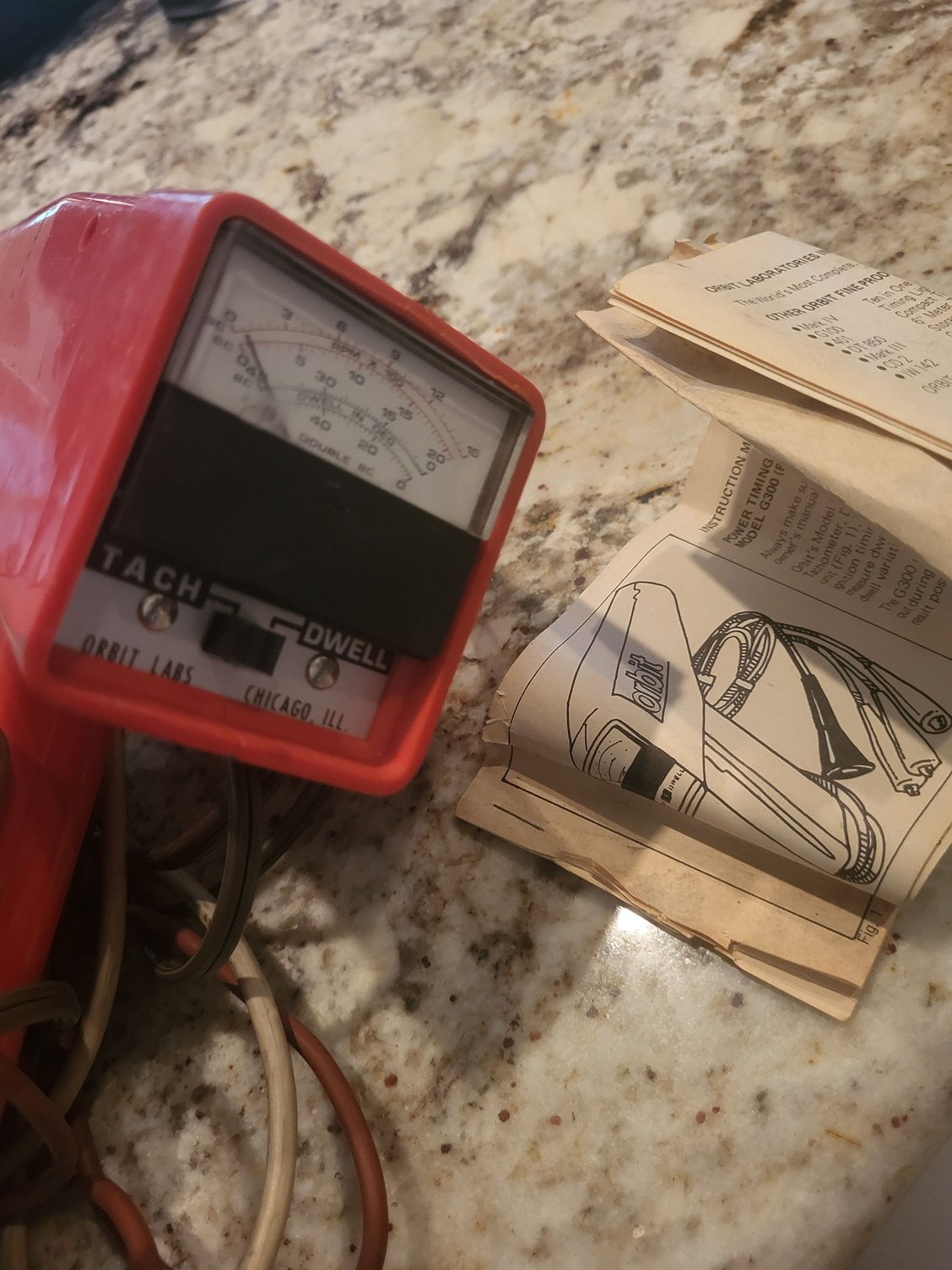

Never heard of a timing light w/ dwell, interesting - that sounds modern.
yeah its an older one for sure and haven't used it in many years,
yeah its an old one for sure, haven't used it in years and have a dial back I've been using... I will likely just pick up a dwell meter.

How cool - a vintage timing light with built in analog dwell. Assuming it works - I don't see a need to buy a second separate dwell.

Cool ORBIT tool
Here's another timing light w/ dwell & tach. This one made by HELLA, and apparently in current production
https://www.autolinkparts.com.au/hel...ll-angle-rev-c

Its been many years since I've used it, I am filling the differential fluid later this morning to button up the underside work then on to dwell and timing, hope it works but if not I can get a digital dwell meter local.

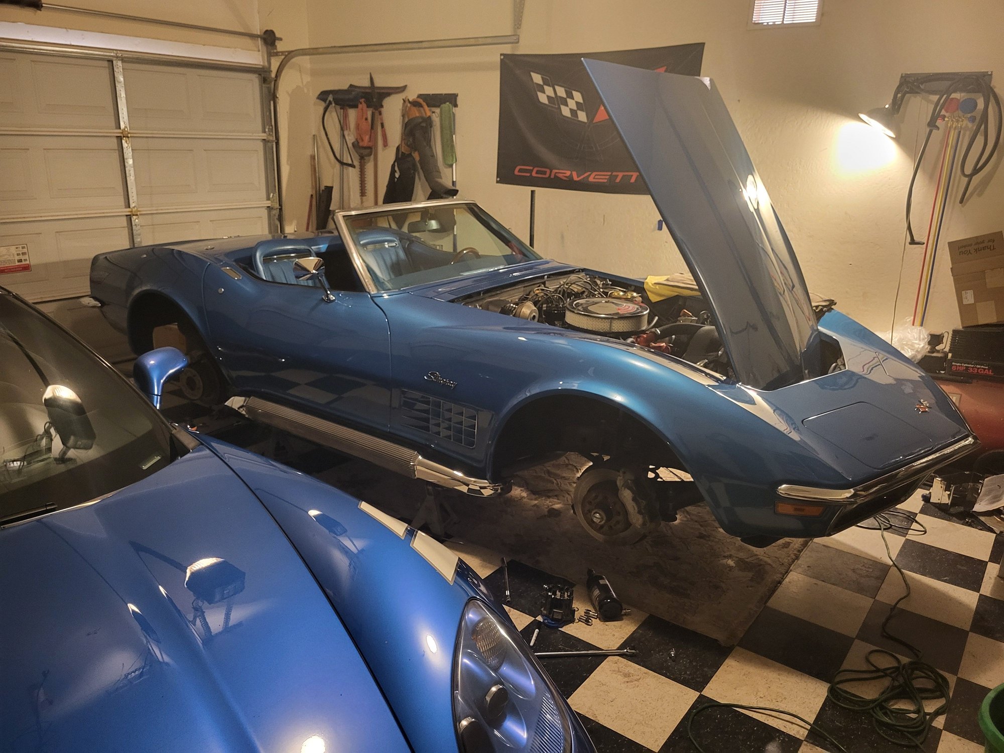

That old Orbit timing light and dwell meter worked great, car is still up in the air but set the dwell at 30 degrees and set 8 degrees initial timing at just a tick over 800 RPMs
Will get a total timing when the car is back down and I can rev the motor not early Sunday morning but the antique worked perfect and car sounds great.
I still have the warranty card anyway. 😉

thanks VERYSOON, I actually set it to 9 degrees advance initial timing... I do plan on doing a total timing later this week, I just removed everything to get the car back down on the ground and backed out, I have a garage mess to clean before travel tomorrow but happy with all results and feel it will be ready for the road by next weekend.
