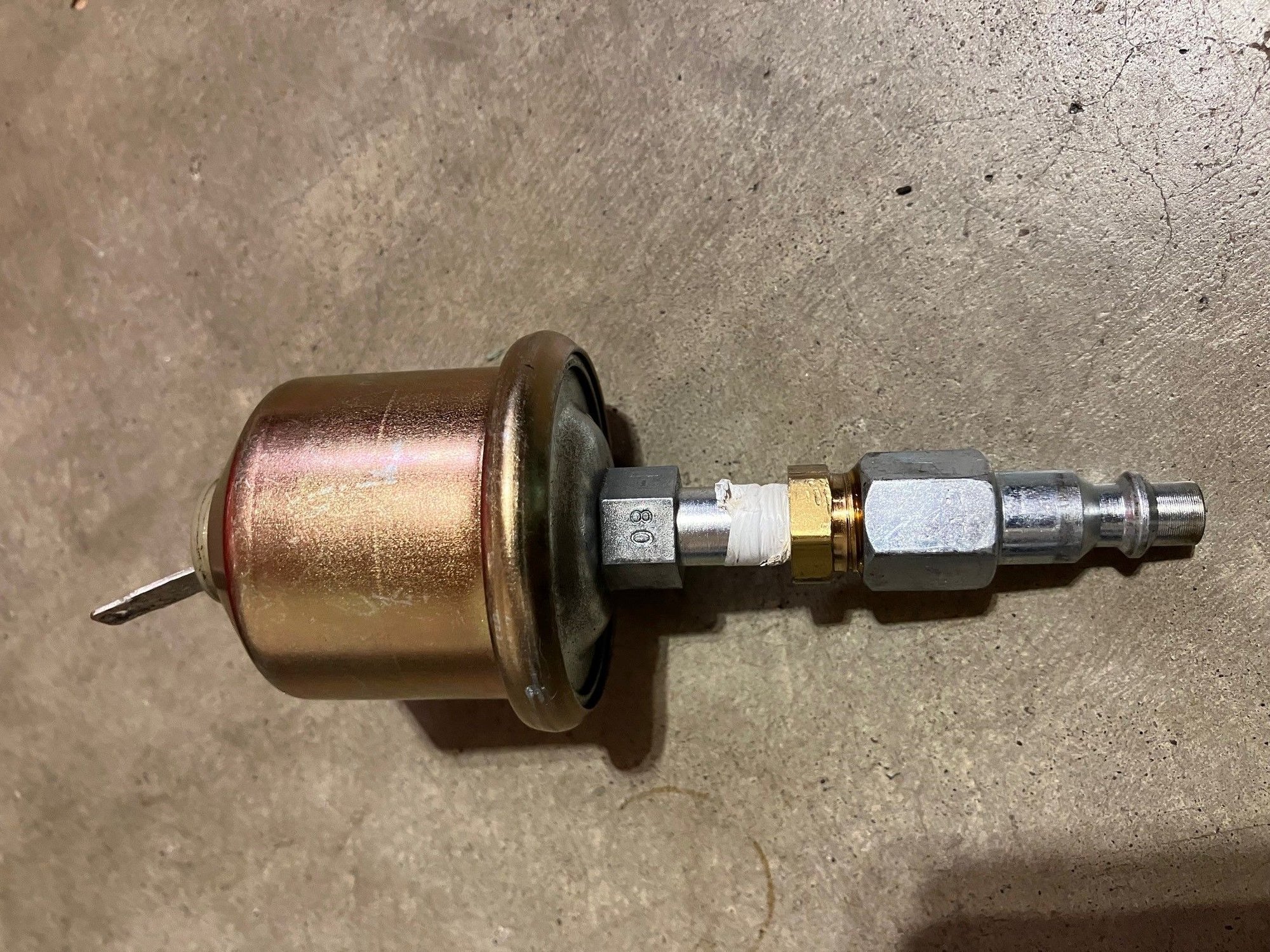

Here is how I test the sending units. Connect to a air compress and set to 10,20,30,40,50,60,70,80 PSI and measure the ohm's resistance of the sensor. A gauge when working properly works in the range of 0 - 90 ohm's input.
Recording what the sending unit output at 40 PSI (Easy marker on the gauge) let's say it's 40 ohms. Then connect a 40ohm resistor from the connector to ground and see what your gauge reads.
Or can leave the connector in place and ground the sending unit to the engine block, and use your air compressor set to the easy gauge markers, and see what the gauge reads.
Doing this, I have found most sending units DONT MATCH what the gauge wants. So when set to 40 PSI and read the gauge I learn what the gauge reads and call this 40 PSI.
I did the same thing and found that all three of my senders read zero ohms independent of air pressure.
