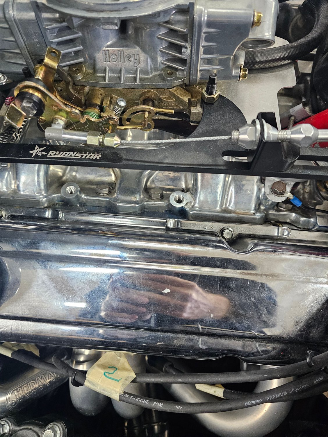

My 70 has a 383 w/ a Holley carb and an aftermarket linkage set up.
The pedal end of the cable was just a nub that passed through the hole in the pedal arm w/ a plastic bushing. The plastic bushing broke and disconnected the throttle. The cable always seemed tight which may have contributed to the bushing breaking. Is there a better cable out there to use w/ our pedal that won't use the plastic bushing? I've seen the generic ones but the ends seem to be made w/ a cross bar where the hole in the pedal arm doesn't face the firewall.

I have a Lokar cable, that works very well............. this one...https://www.summitracing.com/parts/l...uKCA8rVpU5TTMA .

Why not just use the 70-72 LT-1 cable bracket for Holley carbs, and the stock 68-72 accelerator cable?
https://www.volvette.com/FU050.html
https://www.volvette.com/FU039.html

Thanks. That's pretty much the set up i have now. I can try and just replace the pedal busing and maybe adjust the cable a bit to not put as much stress on the bushing. Dont feel like doing this again.

I figured it was easier to use what was already there than get a new bracket and cable. If this issue happens again i may go down this route.
