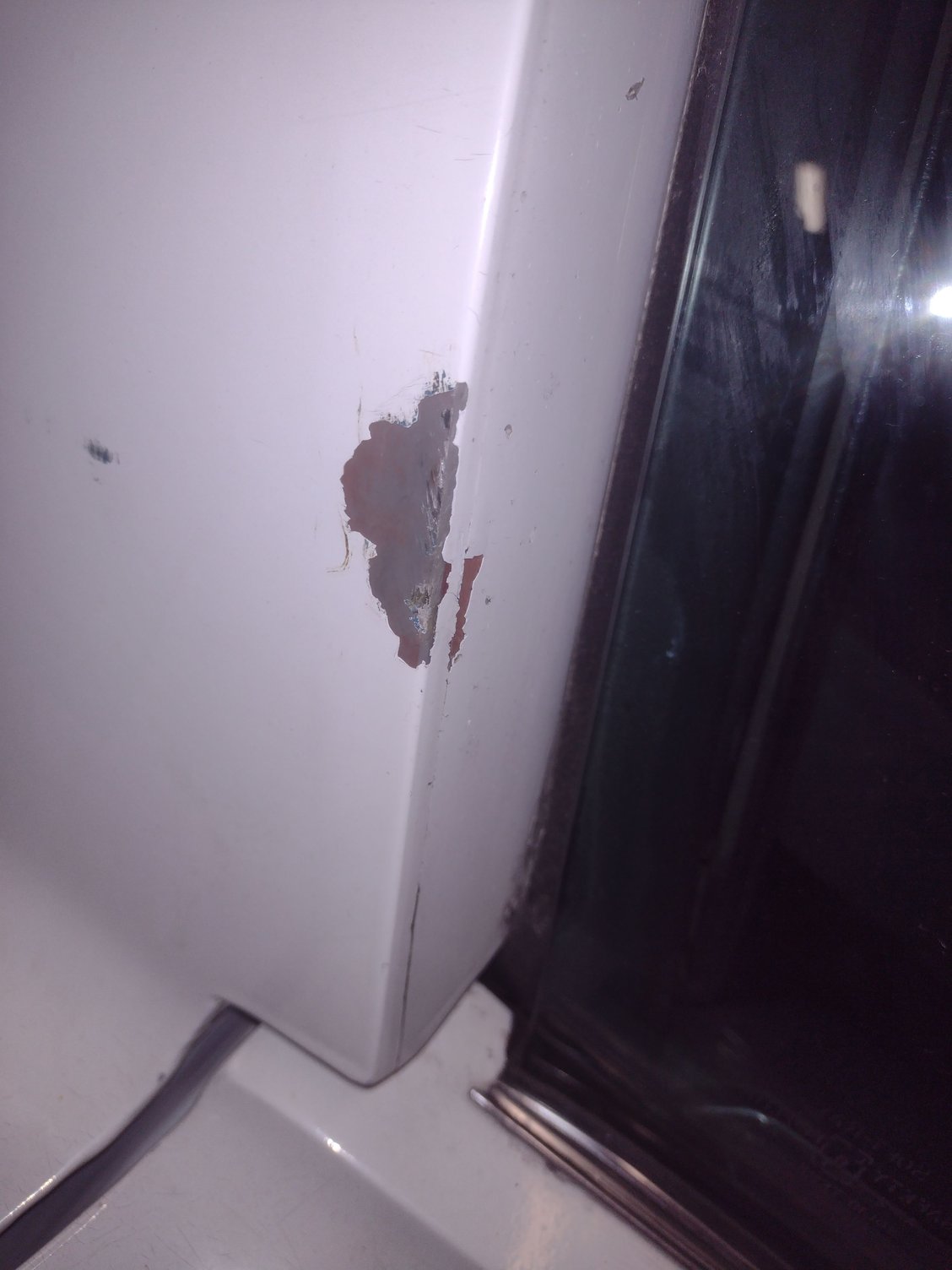

Hi there, what would be the best ways to tackle the following two repairs on my 1977 C3.
Reading up on here, it seems it would be better to use epoxy rather than polyester resin, but would it be best to use glass fibre sheet on the door or just build up with epoxy.
JB weld do a epoxy based plastic weld epoxy putty, has anyone one here used this before?
Any advice would be appreciated as I've never done anything like this before.

With a 77, do NOT use polyester resin. Epoxy or SMC specific resins are needed.
The door damage needs fiberglass to provide the needed strength for the repair. The smaller damage on the body can be addressed with a quality filler.
For the door, you’ll need to remove the paint (locally) on both sides, then sand the damage to a feather edge with at least a 1” transition from the edge of undamaged material. Tape a piece of cardboard, covered with aluminum foil, to the outside of the door to act as a mold, then layup the fiberglass in successive layers, each wider than the previous layer to encompass the aft edge of the door by ~ 3/8”. Once cured, rough sand to contour. You may have to apply a second layup after the rough sand if the surface isn’t to the desired contour.

Ok I had a go this evening, not sure how it will come out yet but I don't think I'm too far off.
On the outside (to keep the lines of the door) I made backing strip out of cardboard with foil glued to one side, and before held it in place I cut a piece of matt the same size as the repair area. I applied this piece first then slid in smaller pieces in to the gap with plenty of epoxy, every piece was smaller.
Then once I'd built up the outside of the door, I cut some strips about an inch wide and put these over the thin steel that was exposed on the inside, the theory being it will be a stronger repair if there's a decent amount of matt on both sides.
I just need to let it cure now for a day or so and see what it looks like when I take the cardboard off.

By today it was certainly cured to the touch and seemed solid so I took the backing cardboard off and it's come out pretty good, if I say so myself.
I then got a bit of card and used the crease in the passenger door parallel to the door handle as a datum of sorts and traced the edge of the passenger side door, cut this out and then flipped it over to get the mirror for the drivers side.
Using this I marked out a line on the repair and used this as approximate place to cut, leaving a bit extra on all way round.
Trimmed off the excess with a dremmel, with glasses, gloves and a respirator for safety and I've now got the approximate shape back.
I'm going to leave it all to cure for a few more days to make sure it's 100% gone off before I start to sand it back.
I'm pretty pleased with how it's going so far though.

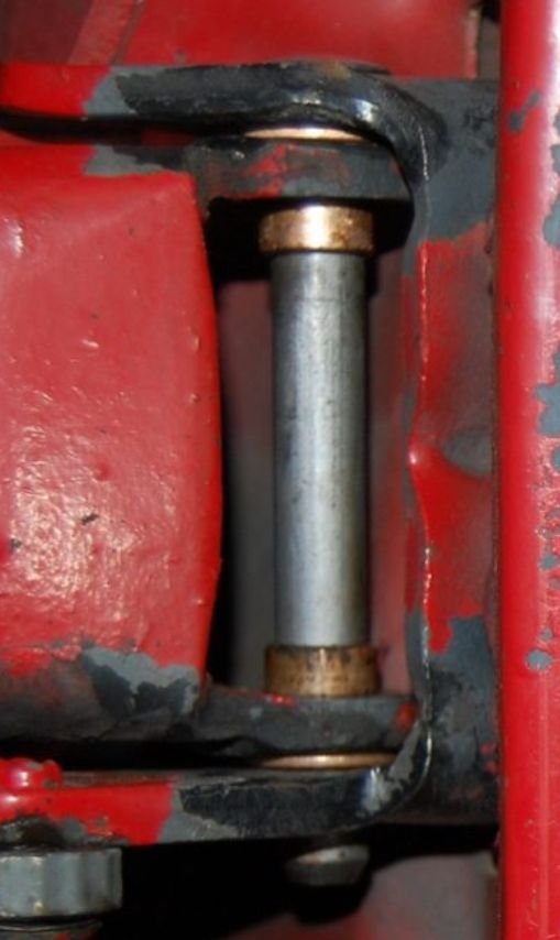

This lip concerns me tho.
I would suggest to check and/or repair your door hinges before you do any more door to fender fitting. Are they loose?

Leigh is spot on! Relatively easy job to replace the pins and the bushings.

If you look at the first post, you can see the door fits up pretty well. In the recent picture the door isn't closed properly and its a perspective trick that makes it look like there is a problem with the hinge.
BTW I do have another C3 with a sagging door but that's a problem for another day.
After a bit of sanding on the edge and the fit up is pretty good. The only bit that needs a bit more work is the top corner which is a bit too rounded for my liking, but other than that I'm happy with the results so far.
