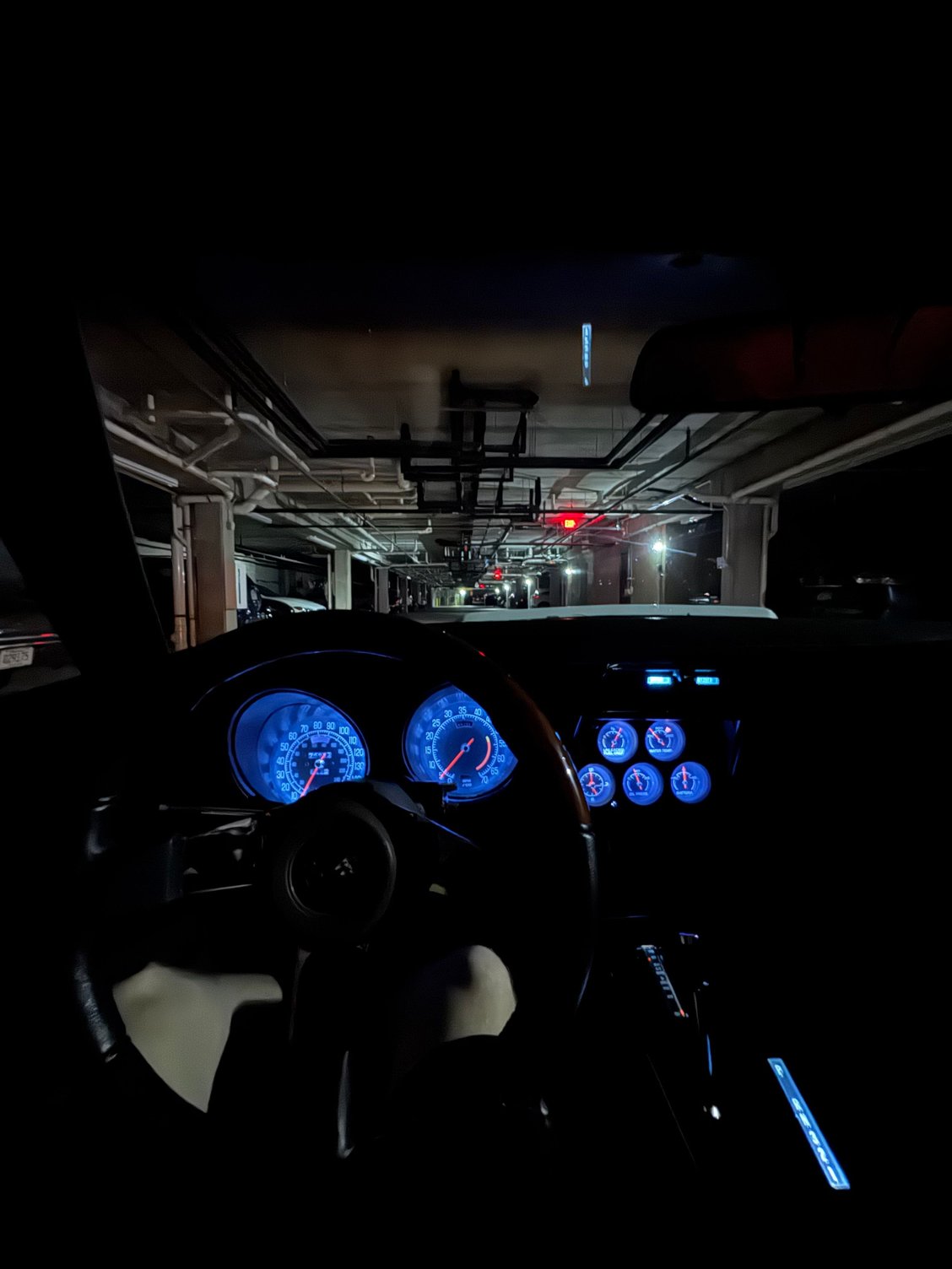

Just to add to this thread. I’ve had some of the generic 194 LEDs in my dash for over two years now without issues. They’re not dimmable, but but I really don’t need to since I like the level they’re at. It’s a very brilliant blue color, and the indicator lights look the right color despite all the bulbs being white.
