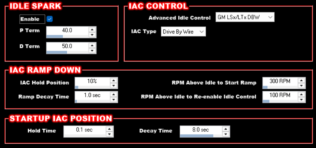

I would run the initial setup wizard again now that you don't have to worry about cam break in. Pay particular attention to the type of sensor you select when asked for Holley or GM. Some new sensors might have come with the Holley kit. I have an LT1 with drive-by-wire so I don't know what the LS kit contains.
If you still have idle problems, try these settings in the idle control menu. Ignore the DBW variables. I got these settings from a
and it fixed my idle problems.

My kit needed to install a intake air temp sensor, and a Holley MAP sensor. It eliminates the stock MAF. Your kit is different, so it is probably OK. I would still rerun the wizard to clear any false learning and start the process fresh. Make absolutely sure the exhaust system is free of leaks that will throw off the O2 sensor.
