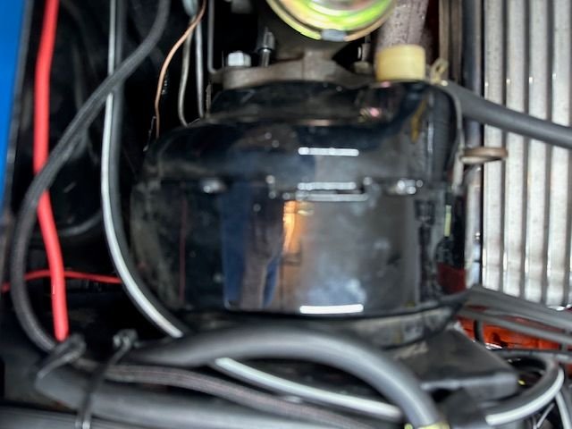

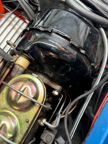

A picture might help.

Well it kind of looks correct.
Did you get it from one of the Corvette suppliers?
And did you check the pushrod length?
If not you probably should now.

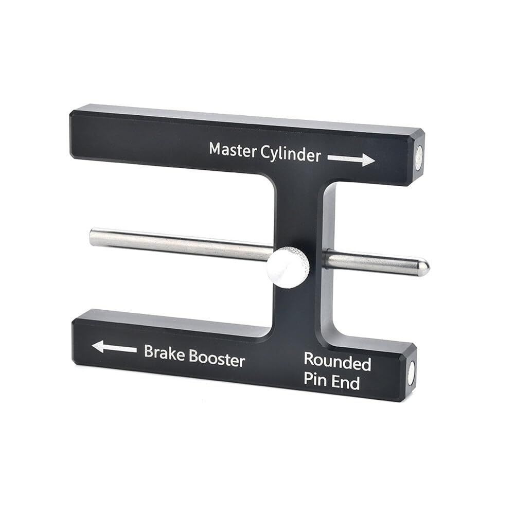

Buy the little tool!

Is there any chance that I can disconnect the master cylinder from the booster without disconnecting all the lines and slip that tool in there to make the adjustmentsor do I need to just completely remove the master cylinder to get it done?

You do not need to remove the lines to use the tool.

So I got the little tool, and just as Piersonpie said I was able to get the tool in there without removing the lines. Tight but doable. To my surprise there was a gap of 3/8 of an inch between the rod and piston. As near as I can figure, when I would hit the brakes the momentum of the booster rod as it hit the piston was what caused the off/on switch effect. Its still sensitive but I can now trust the brakes and not be afraid of them. Thanks to all for the advice and comments. I am going to wait until the summer to install the new master cylinder. Atlanta
