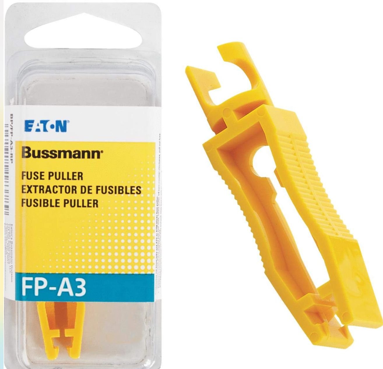

I used this on my 69 but will say that it wasn’t a slam dunk. As mentioned, corrosion in the contacts can be a challenge. I had my harness on my workbench so was able to apply a few drops of WD-40 and let sit for a couple of days before attempting to remove.
Old Dec 7, 2025 | 11:23 AM
Franks73's Avatar
Franks73
Joined: Jul 2013
Posts: 366
Likes: 19
This looks like it might work, will give it a try, Thanks!
