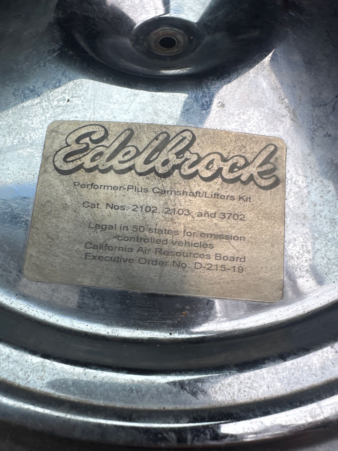

? what is part number of edelbrock cam you installed with your OE valve springs ? I can readily find its specs eg Lift.

im not 100% sure on the cam part number since the sticker included with my cam includes 3 part numbers for similar cams, I can send a photo of the sticker

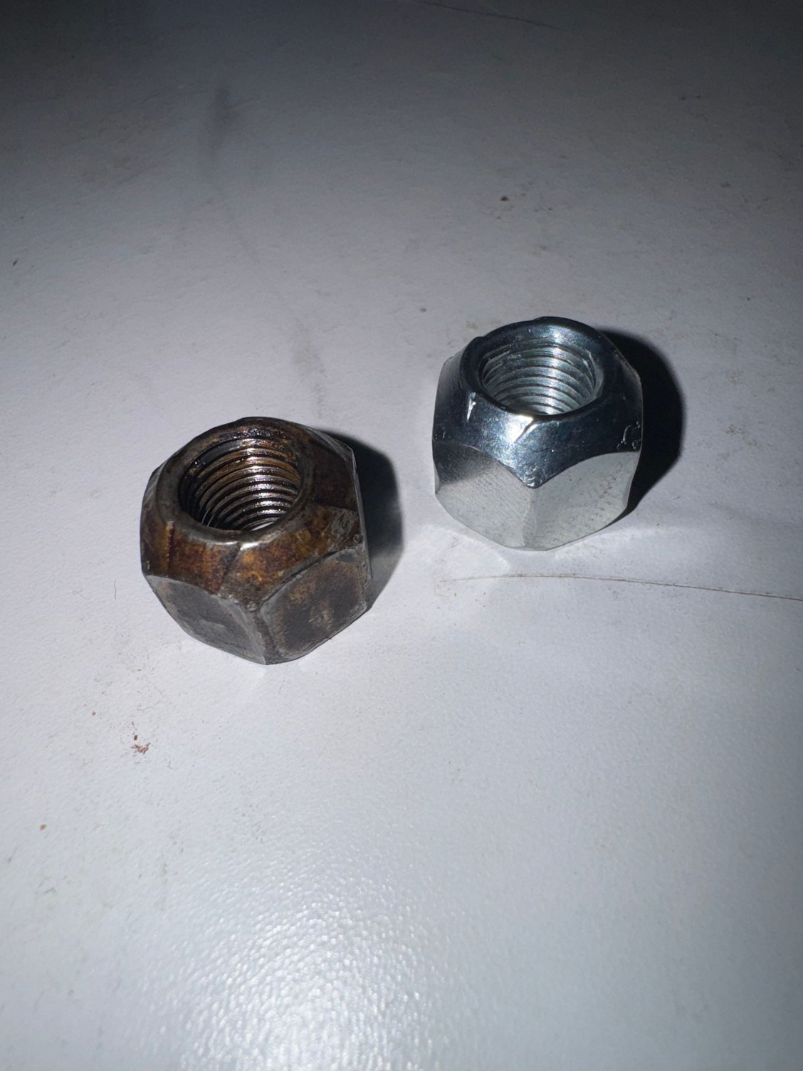

Went to the parts store today and bought a couple of the oem style locking nuts since they were 99¢ each and I can tell a clear difference in my originals vs the new ones, the threads looks like they lost their tension. What do you guys think? I see on the new ones they have flat threads to lock into the stud but the old ones look like regular nuts!
