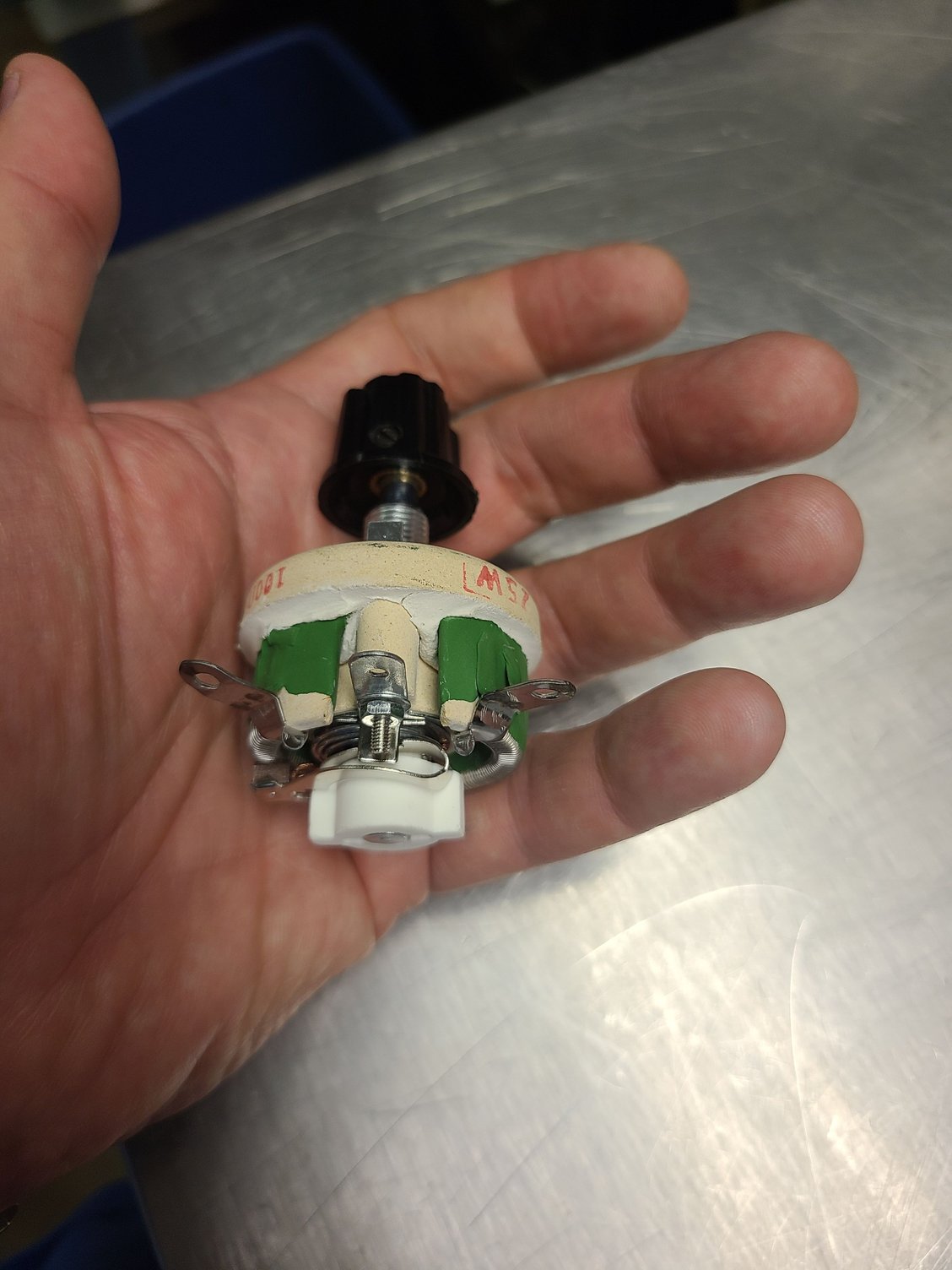

I bought this one on Ebay for cheap. It's a zero to 90 ohm adjustable resistor. I bet it would work. Just turn the **** until the gauge reads correct then remove the resistor and measure across the terminals to see what fixed resistor you need to find and install.
In theory, this should work but I never got to try it. I just hogged out the small hole in the head and tapped it for the bigger sender. Hope this helps.
