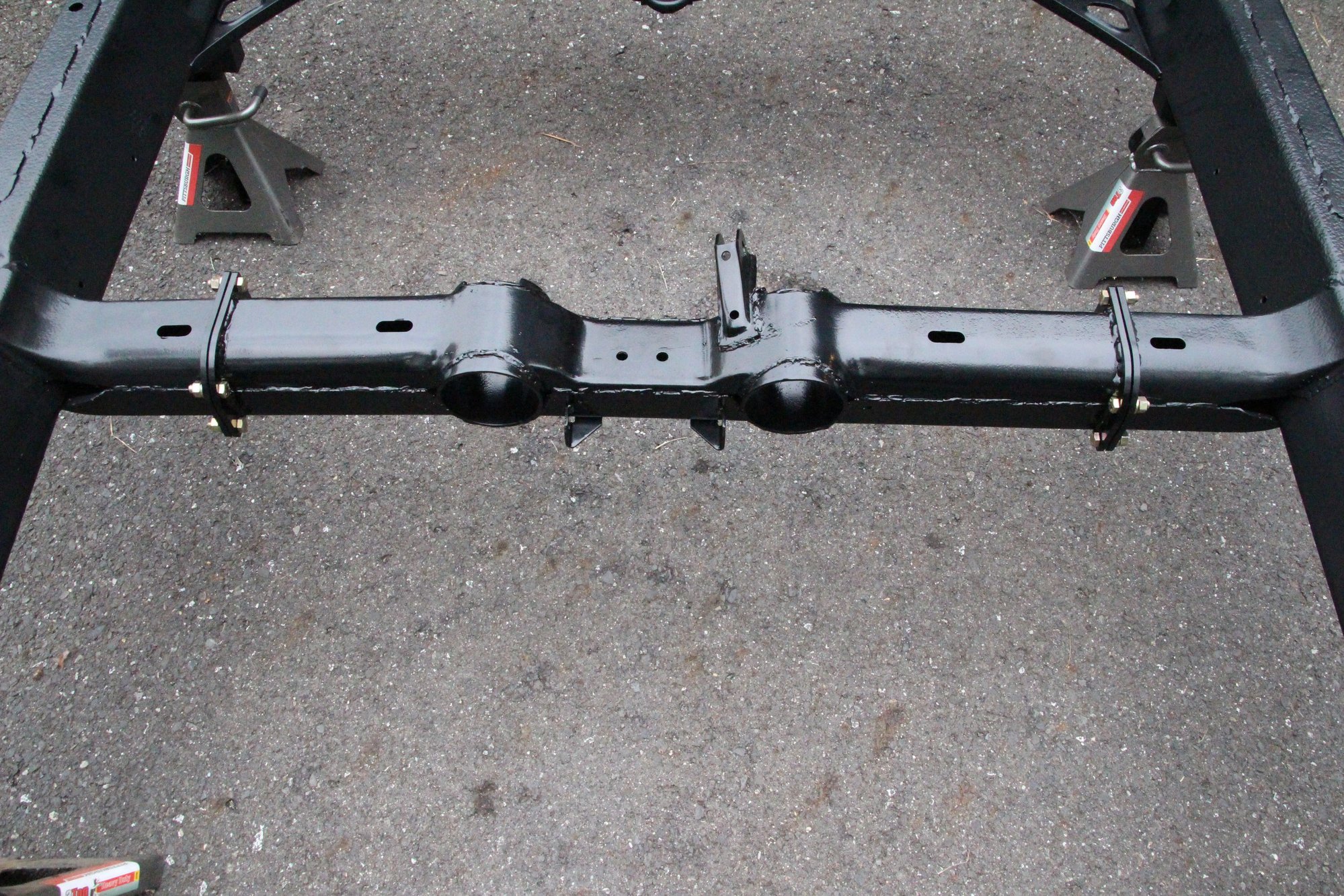

You could always just mod your existing manual crossmember with four vertical flanges and make it a bolt together affair.
This is my original manual frame 72.
This makes trans and clutch work so much easier on manuals.
But IIRC it is absolutely required for removal of the large TH400 trans. With the body on.

I concur....I modified mine in stages... you can go follow the thread but essentially:
1. I first made my crossmember removable so I could install a richmond 6-speed.
2. Later I modified that thing to allow the exhaust to "pass under" the crossmember when I was installing a 200-4R (which is bulkier -- passing under allowed easier exhaust routing).
3. And even later I just made my own pass-under crossmember because the original I modified ended up really heavy.
If I was starting now I would make it pass-under to begin with--- it allows easier routing and you can drop the exhaust a lot easier and you can locate the exhaust as you wish instead of being forced through those holes really close to the tranny...... or I'd buy a pass-under crossmember and modify the outboard ends to bolt it onto the old manual stubs (similar to factory style bolt on).

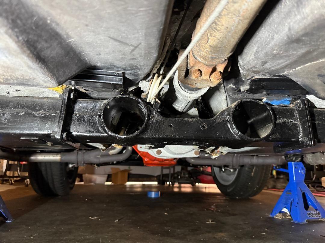

Here's what I did to make the manual crossmember removable on my 68. Notice it's the same concept as that shown in post 7.
The flanges shown here were made in house by J&D Corvette in Bellflower, CA. I have recently had the same conversion made to my 70, except here the flanges were bought online. Both of my cars have Tremac 5 speeds and there's little space left in the tranny tunnel. In the event of a need to service the clutch, the removable crossmember allows the tranny to be replaced without the need to move the engine forward.
Comparing my conversion with post 7, I think my implementation may be easier to make, given that the body is on the frame. Easier from the standpoint that the body presents less of an interference with the crossmember cutting procedure. Anyhow, I really don't know since I didn't physically do either conversion.
Notice the rusty headers and inlet tube to the factory style sidepipe mufflers. I now have an all stainless steel set of headers (Sanderson) and stainless steel mufflers (Hi Performance Mufflers). Two types of headers: rusty and stainless steel.

Looks good. I may do the same.
You stated that the flanges were purchased online.
It looks like American Powertrain sell similar flanges.
