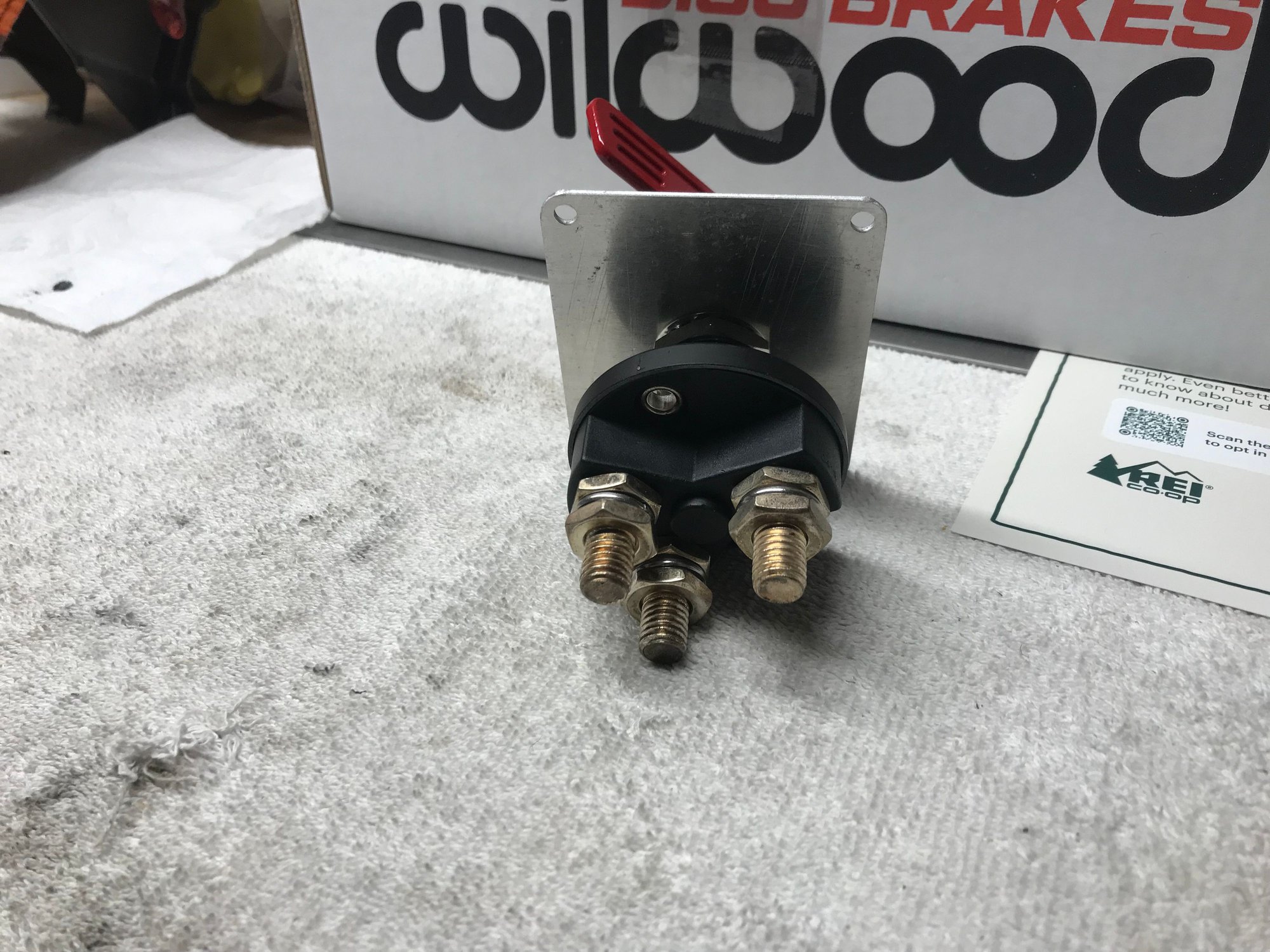

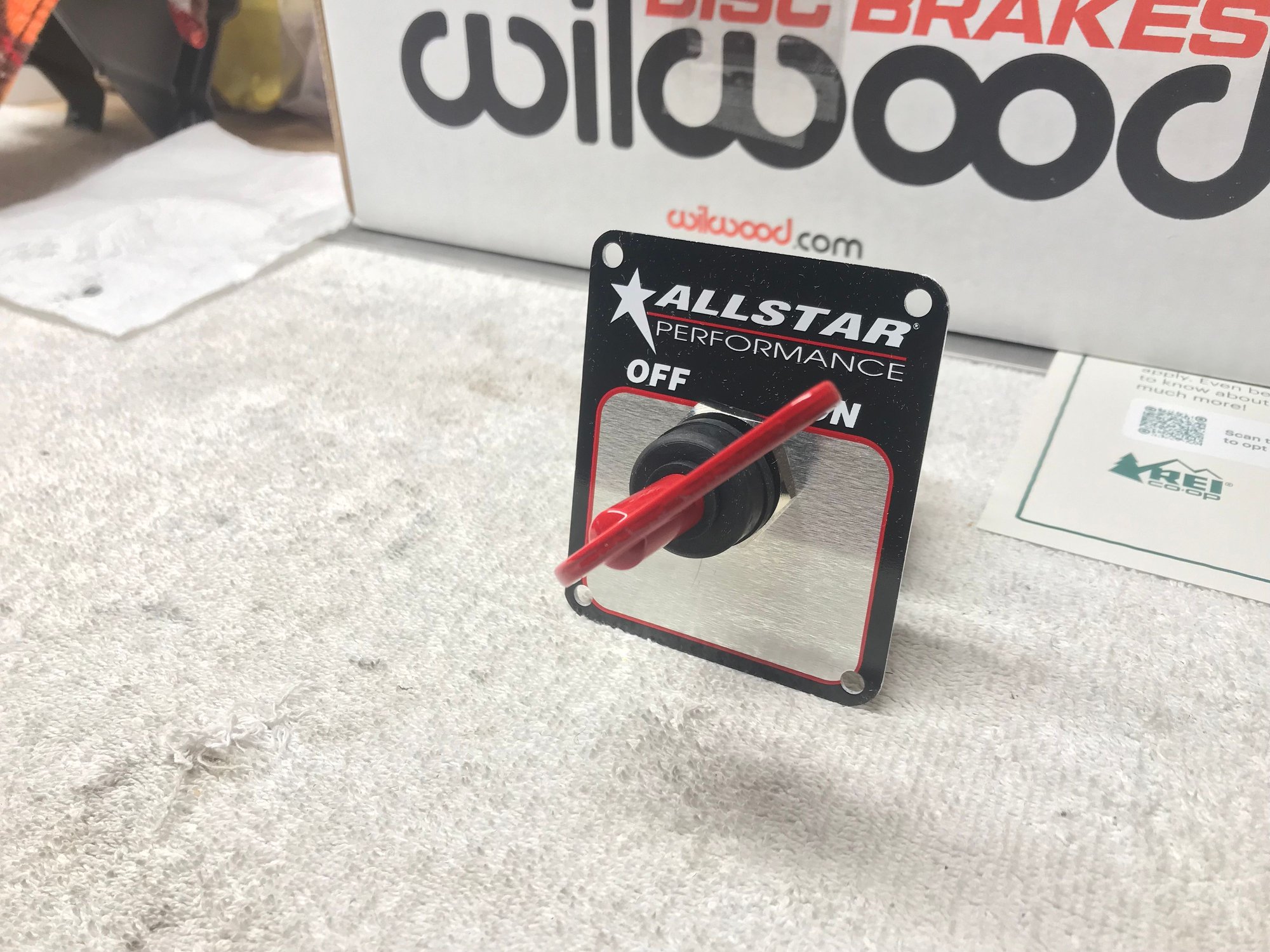

I’m thinking on this build about installing the switch pictured below between the battery ground lug and the chassis ground point.
This will disable every component so the starter won’t even crank and the switch has a removable key.
I believe that disrupting the ground is better than installing the switch on the positive cable between the battery and the starter.

I believe the switch I have was manufactured by Cole Hersey and sold through All Star Performance.
I like the switch I have because it is heavy duty and a mechanical disconnect where nothing can fail.
My 73 had one of those blade type disconnects at the battery when I bought it and it was really junk.
This one I can mount where it is accessible from the drivers seat and any time I want to completely disconnect the electrical, I can then take the key with me.
My question was more about whether to install it on the positive or the ground and if either would negatively affect the electrical in the car.

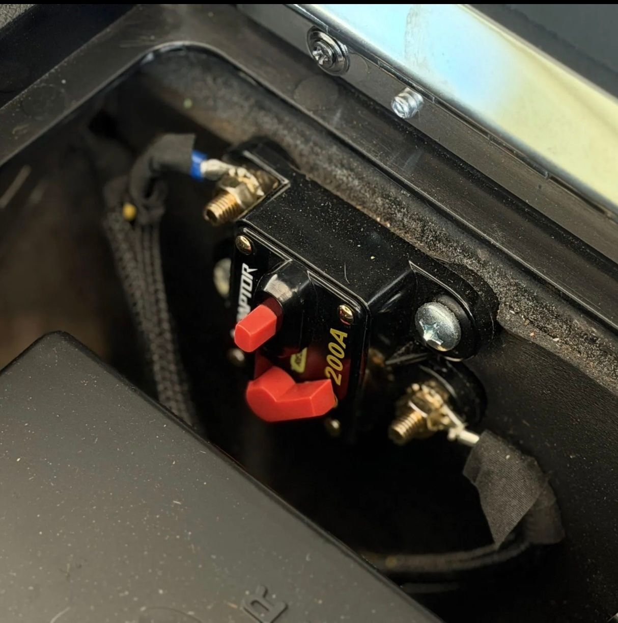

You probably have made your mind up on this subject but I happened to have found this switch installed on a 68 I was looking at on BAT
