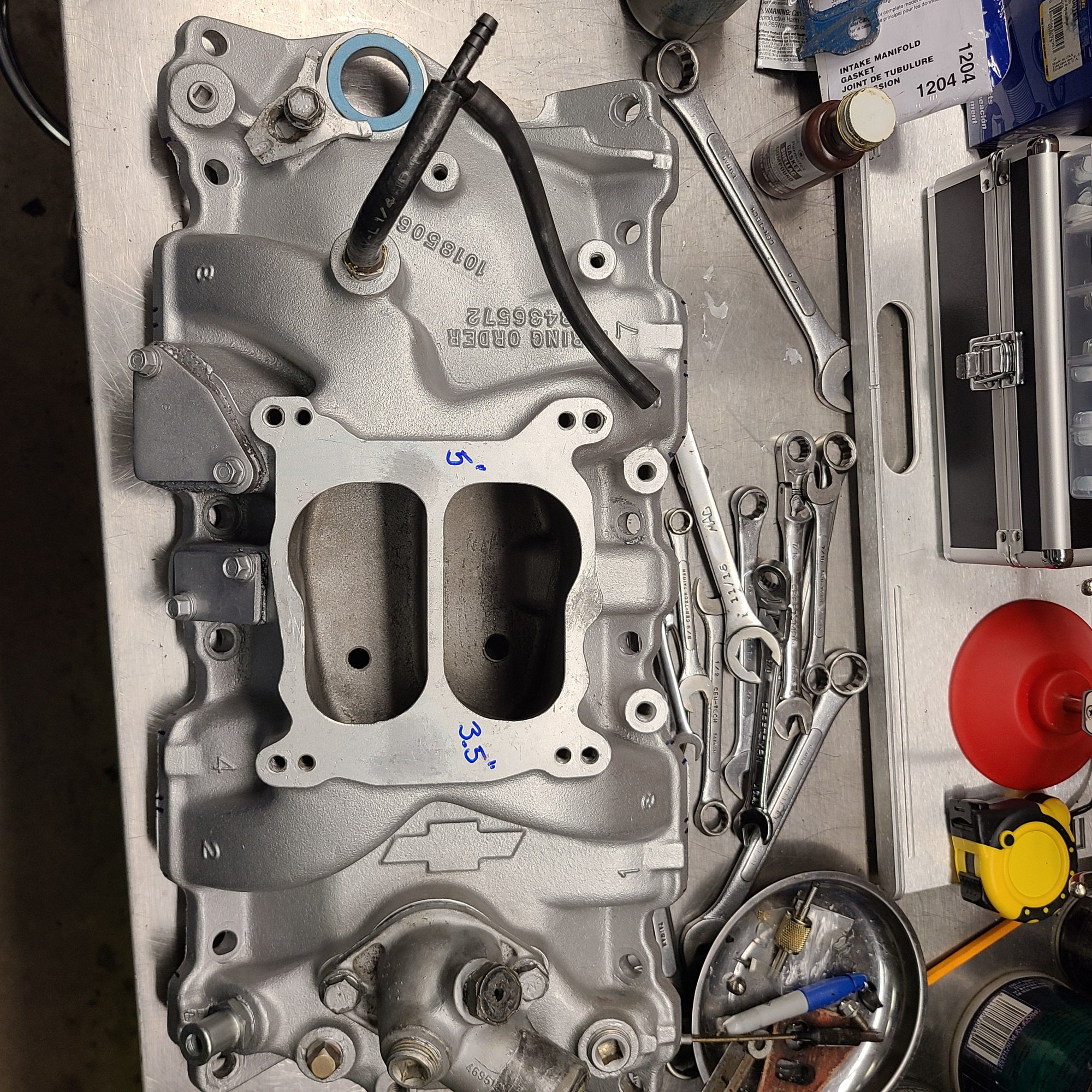

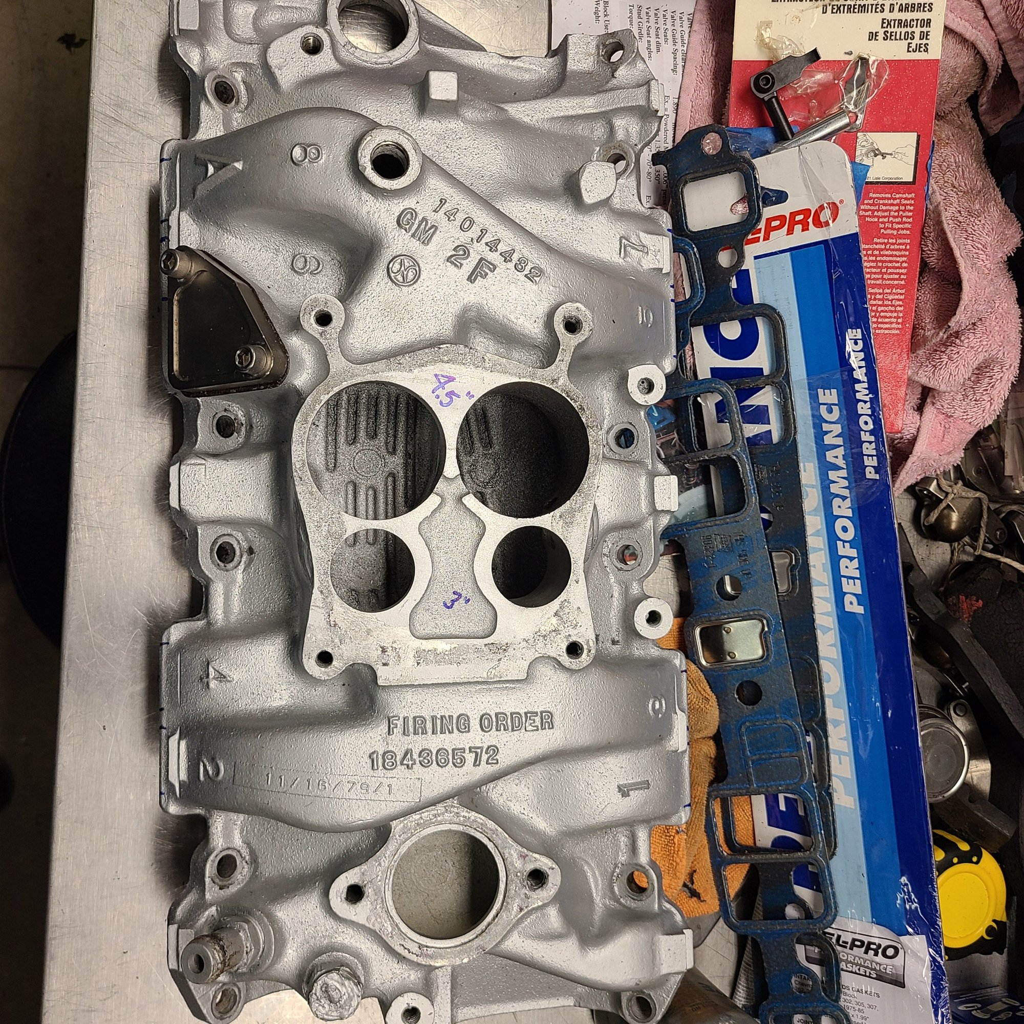

Yes I do. Basically, the ZZ-4 is a half inch taller.
Stock GM L-82 aluminum intake measurements taken front and back from china wall surfaces to carb pad.
ZZ-4 GM Performance Parts aluminum intake.  Measurements taken from china wall surfaces to carb pad height straight edge.

Thank you Mark - much appreciated.
I can't accomodate a 1/2" increase in height on my '59 without undoing some other modifications : a 5/8" spacer under my drop base hi-po air cleaner.
I already dropped my engine to accomodate the air cleaner.
The other thing is the ZZ4 intake probably has larger runners then my intake same as yours - L82 1978 I believe and mine has heat barrier coating applied and old school oil tube / breather pipe installed.
My engine is lo-po 300 hp327 (stock cam) but well tuned
Jerry
