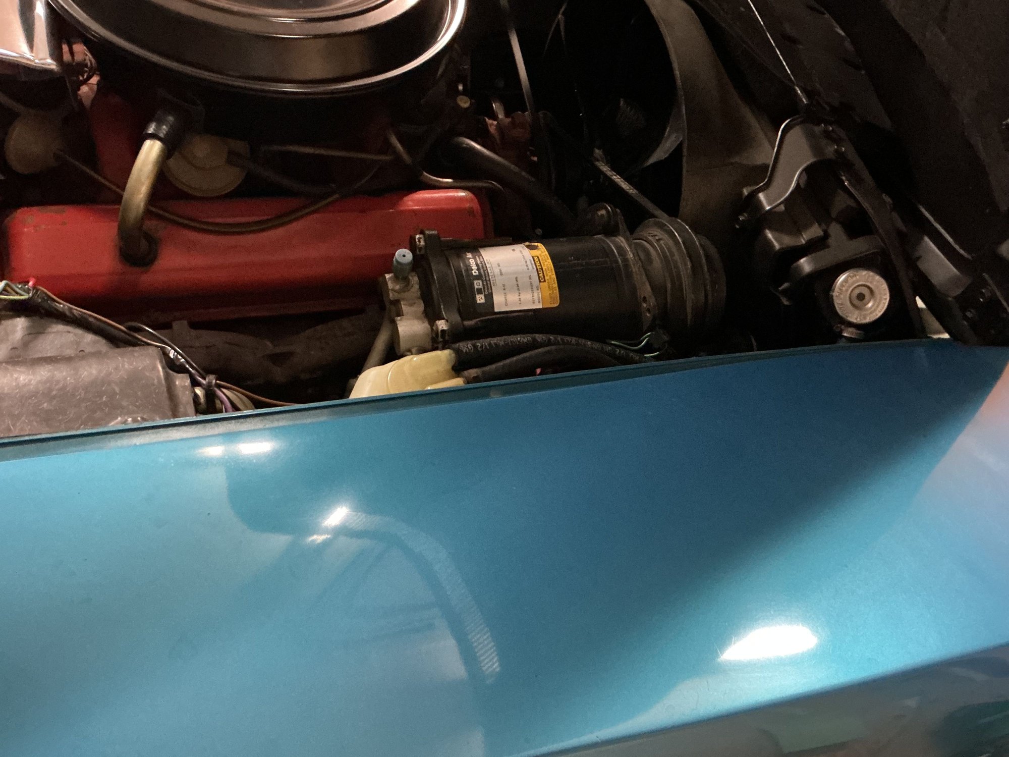

Has anybody installed Doug 350 headers on a 76 corvette with AC ? Do you know if I need an AC bracket or should I use the cast iron stock one?

What style of compressor do you have? The early ‘76 A6 style will need an additional bracket, while the later R4 style doesn’t.

Here is a picture of Ac

You have an A6 compressor. You’ll need the bracket. I would look up the part as if it’s for a small block Chevy engine rather than a Corvette though. It’s definitely a part that has the Corvette “tax.”

Thanks, I have one on order should get here about the same time as the headers, I hope.
