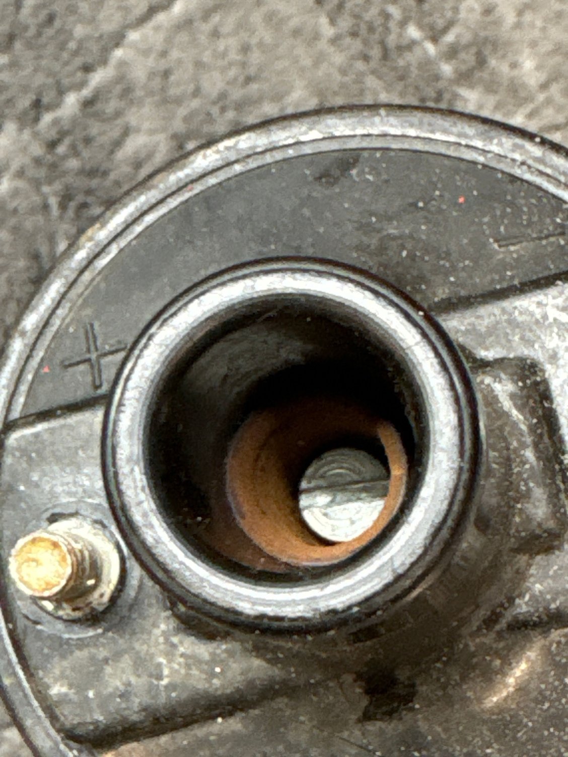

I checked for arcs in total darkness and didn't see any. I also unplugged individual spark plugs and noticed some difference in the idle, so I assume they are okay.
The coil tower has some rust and I have a replacement on the way - I'm hoping this is it.

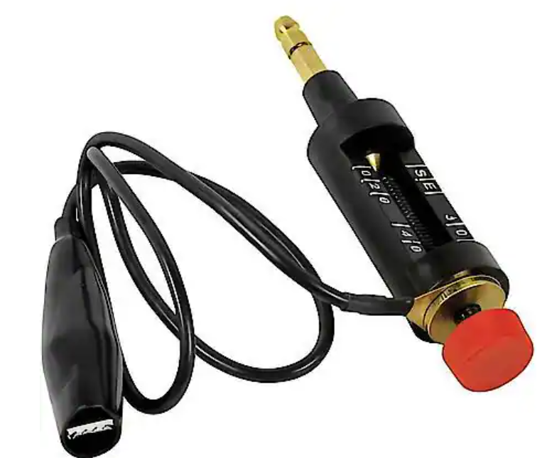

This old school spark testor will let you adjust the spark gap and tell you the voltage level that each plug stops firing at.
They should basically all be the same.
If one is way off, you know the cylinder that has the problem.
If all are low, the coil is weak.
You can check the resistance in each wire too.
thank you! If the new coil doesn’t work I will definitely try the tester. I also haven’t changed the wires so I may just do that regardless. Many thanks again.
