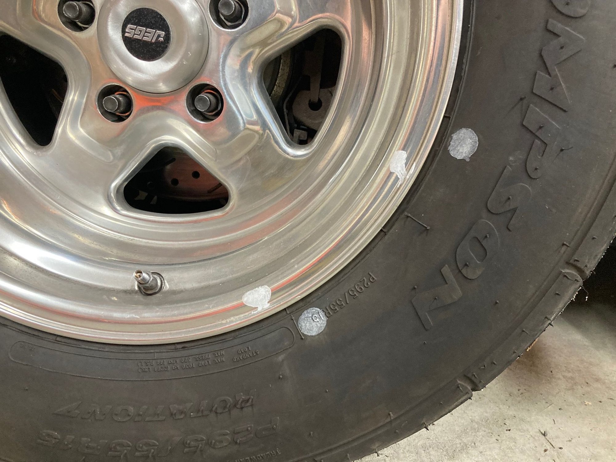

With the straight axle on my 3750 lb C3, the only thing that broke so far 5 Moroso 1/2" studs during the shift from first to second gear on the 4L80E. (probably my fault for not tightening them correctly).
Upgraded to 9/16 diameter studs from a Ford Dually truck. Never had a problem since.
Although, I do spin the tire on the rim during second gear shifts:
