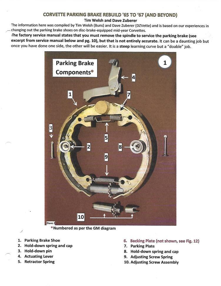

Default Basic instructions:

what are the hold down pin ? Are these the pins that the springs go thru?
Old Dec 26, 2025 | 10:34 AM
vettz73's Avatar
vettz73
Joined: Dec 2011
Posts: 189
Likes: 55
Brake Spring Hold Down Pin
Shoe Hold Down Spring

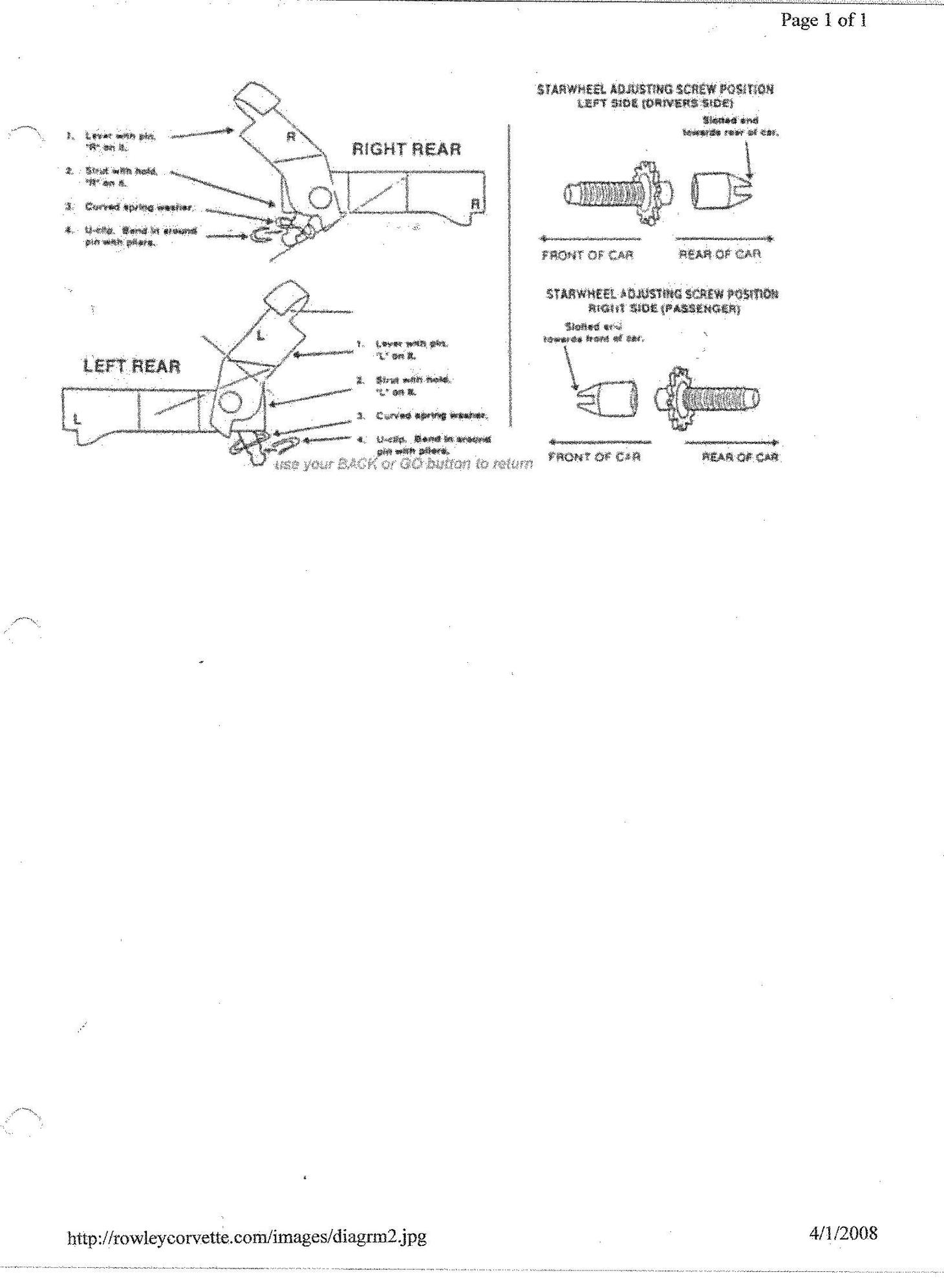

Old Dec 26, 2025 | 12:20 PM
Peterbuilt's Avatar
Peterbuilt
Joined: Aug 2006
Posts: 7,427
Likes: 1,560
From: mount holly NC
