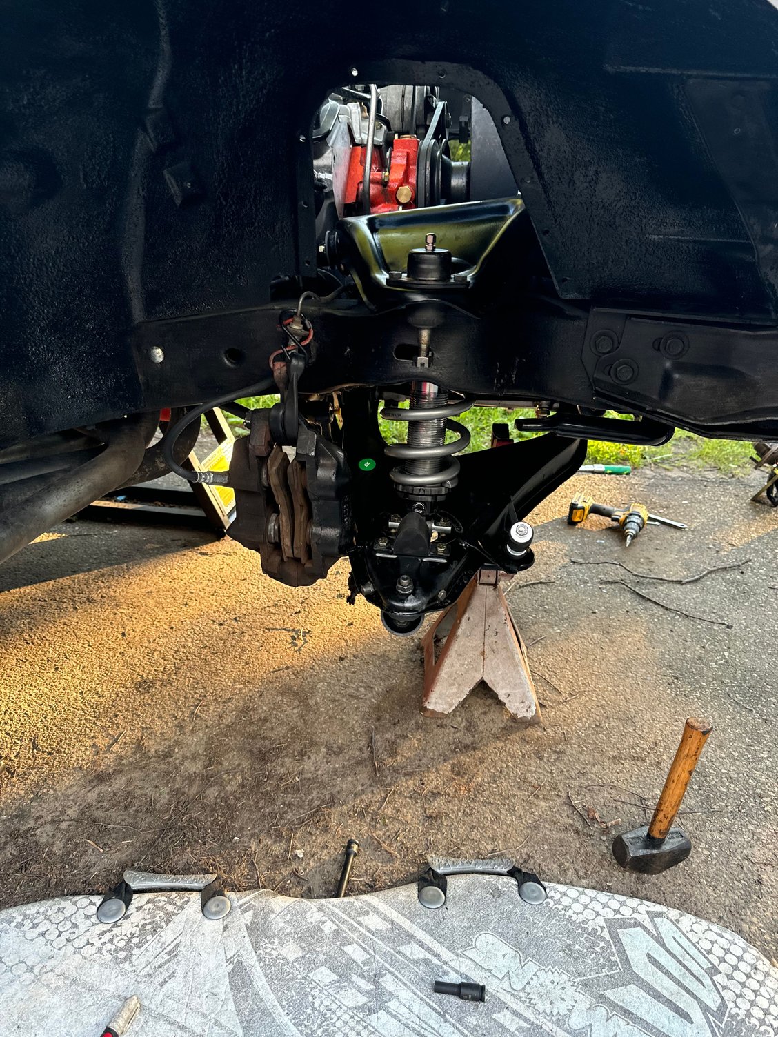

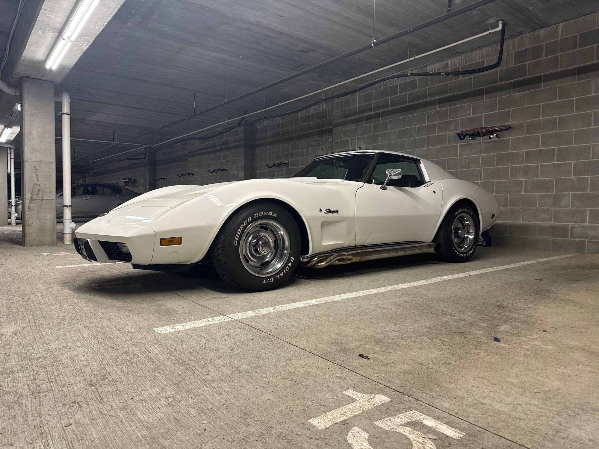

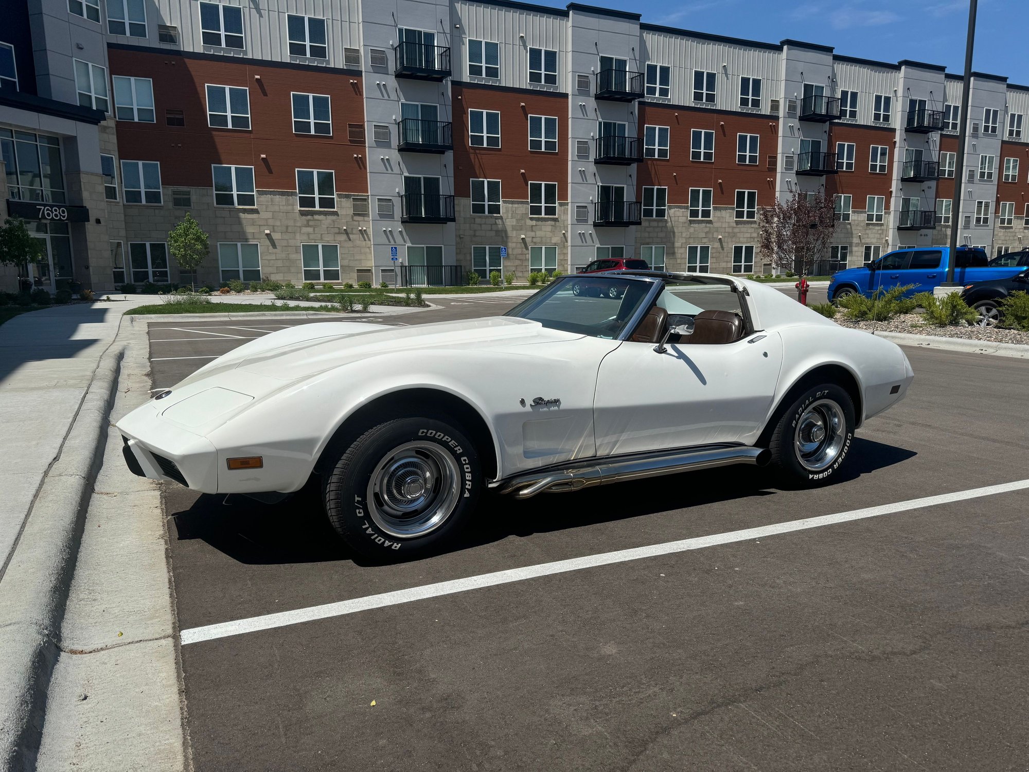

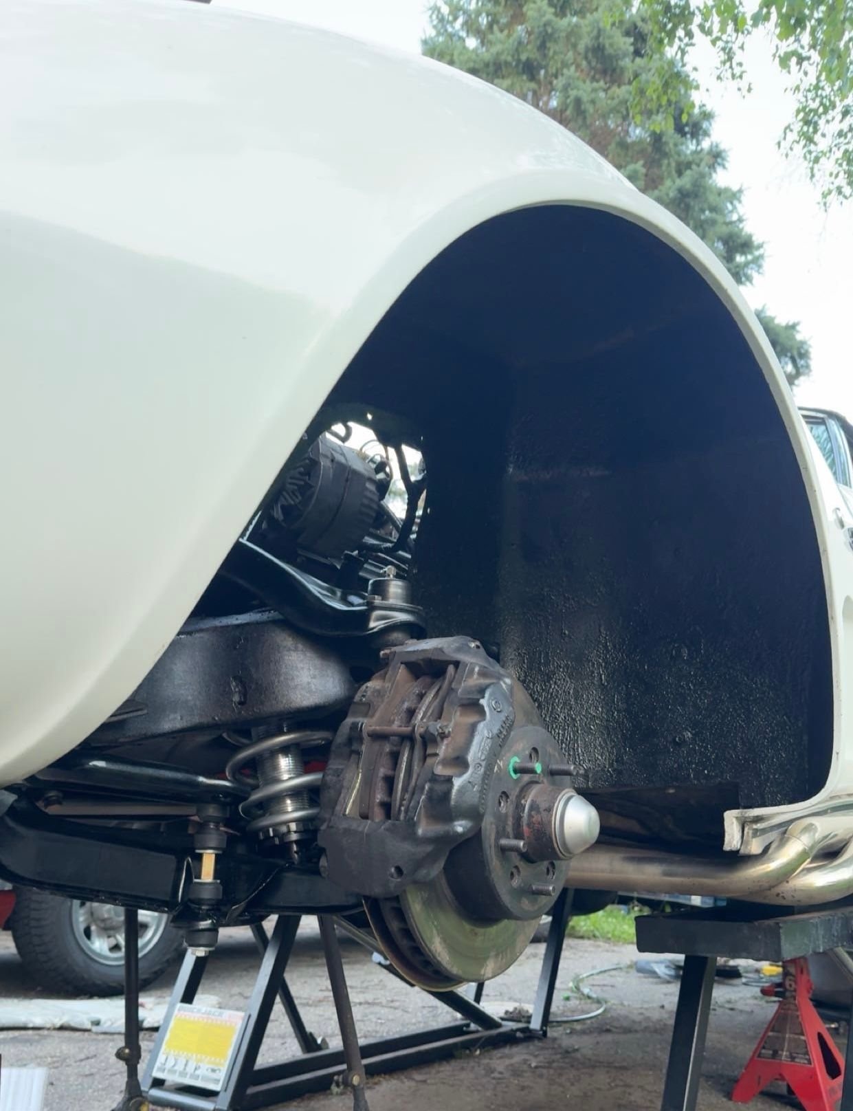

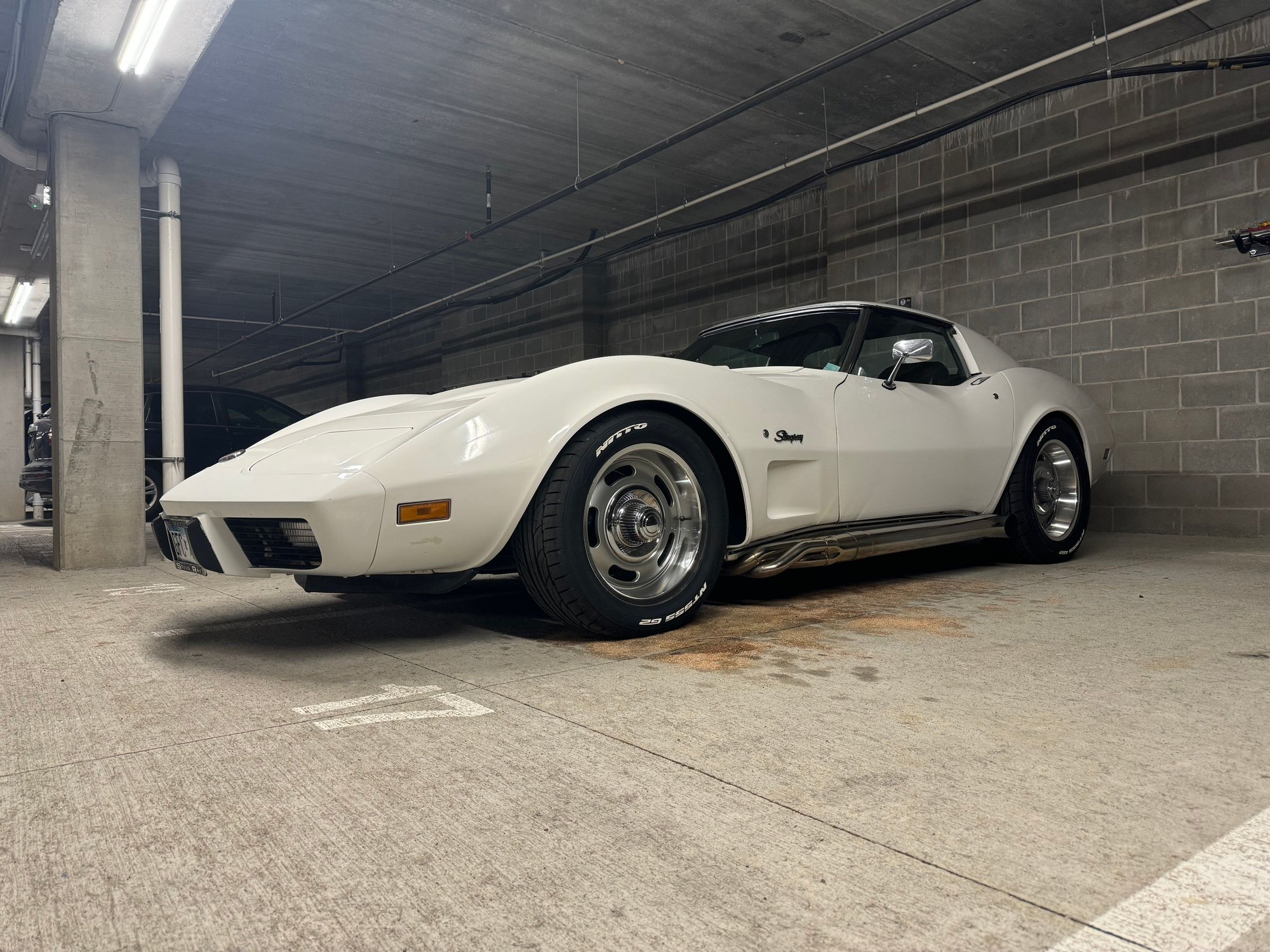

I have Q-A1s in my car. The quality is great, and I’ve gotten my ride height dialed in exactly where I want it.
That being said though altering the length of the stock springs or certain aftermarket ones will lower the ride height too for a lot cheaper. Get a set of shocks you like or even some adjustables and you’ll have the same exact benefits of the semi coilovers.
Are you wanting to spend all the extra money just to say your car is on coilovers? I did
Before and after ride height

I actually have never seen this car assembled yet. So I really like the idea of adjustability.
Where did you have them adjusted in the last pic?

Old Jan 6, 2026 | 08:06 AM
Piersonpie's Avatar
Piersonpie
Joined: Apr 2021
Posts: 2,711
Likes: 2,160
From: Minnesota
I would say near the bottom ish? I’ve gotten different wheels and tires since then and haven’t done the actual fender measurements, which I imagine would be different on a C2 anyways.
