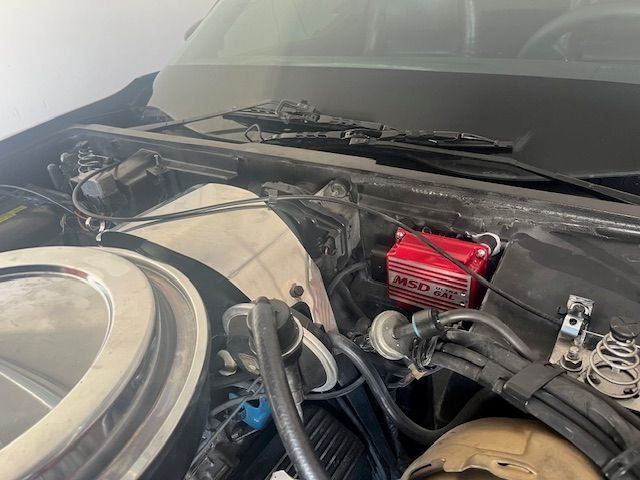

Yes.So far so good. The old MSD Box in interchangeable with the new Ultra. Get a spare old one on FB Marketplace if concerned but the main reason these fail is heat. I have mine vented to the cowl area. After driving for a long while it was barely warm.
